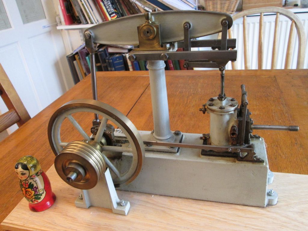

                        Mick B1
                          @mickb1
                          Posted by Jeff Dayman on 16/08/2019 20:14:51:
                          That's looking great John! Well done! I like the colour scheme as well.
                          +1 – nice work indeed.
                          I wanted a colour like that for my Stuart Beam about 20 years ago:-
                          (Matrioshka courtesy grandkids )
                          I used a Humbrol enamel in the end, but I don't think I've any left and don't know the code no. Your lagging is good – I might add some to mine when I do a refurb, which it's obviously beginning to need…
