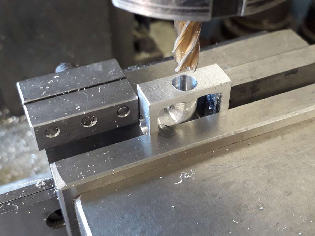

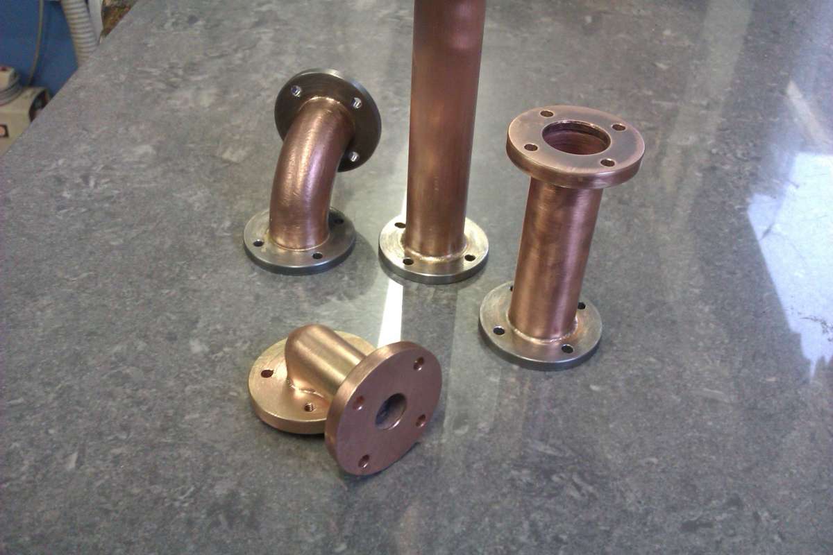

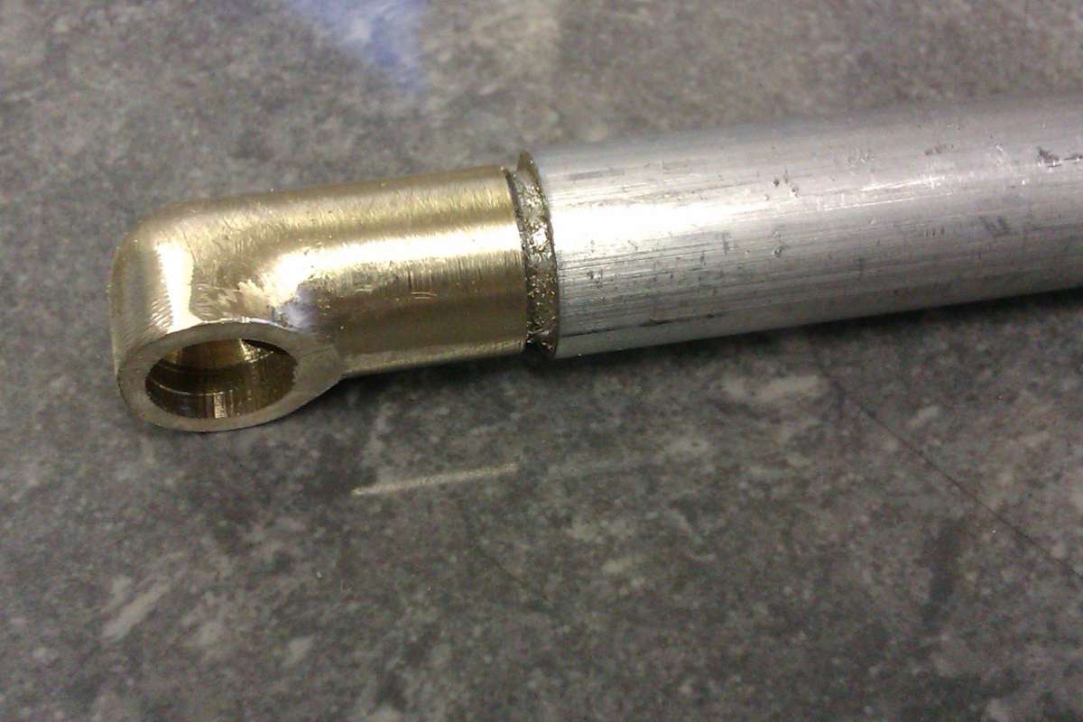

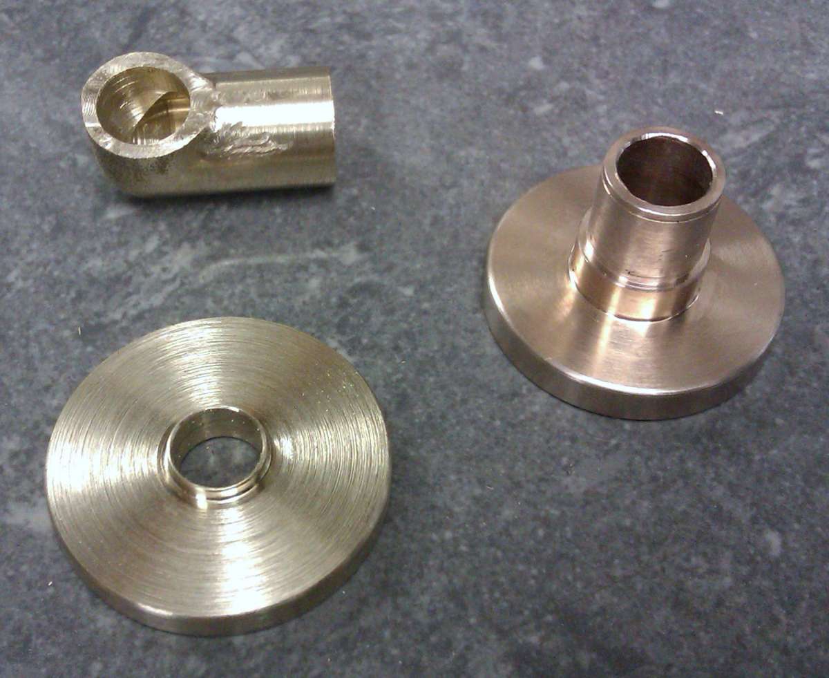

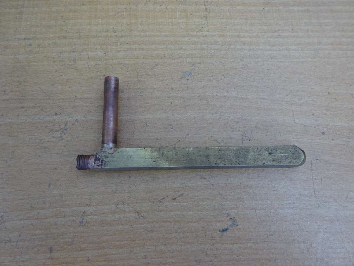

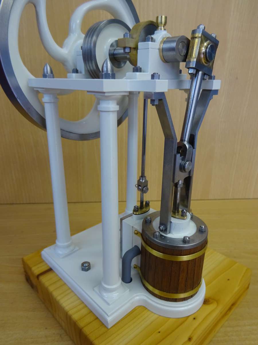

                  Commercial benders give too big a radius for a job like this and you would end up with a “U” shaped pipe. Filling and bending round a tighter former means it gets bent more like solid bar than tube. Solder and lead are other options for filling the tube.
                  Unless you are into bling and brightly polished copper pipe with no visible joints then fabrication is a good option and will also help get the bends exactly where needed.
                  This one used a couple of commercial “crossover” fittings that had the sockets cut off and some internal spigots added for strength.

                  Another option is to use a ball nose cutter to drill two holes at 90deg to each other in a block of metal, solder in the pipe and then shape the outside
                  Photo 60
                  It’s the grey exhaust pipe
                  Photo E
                  Same method here for the exhaust

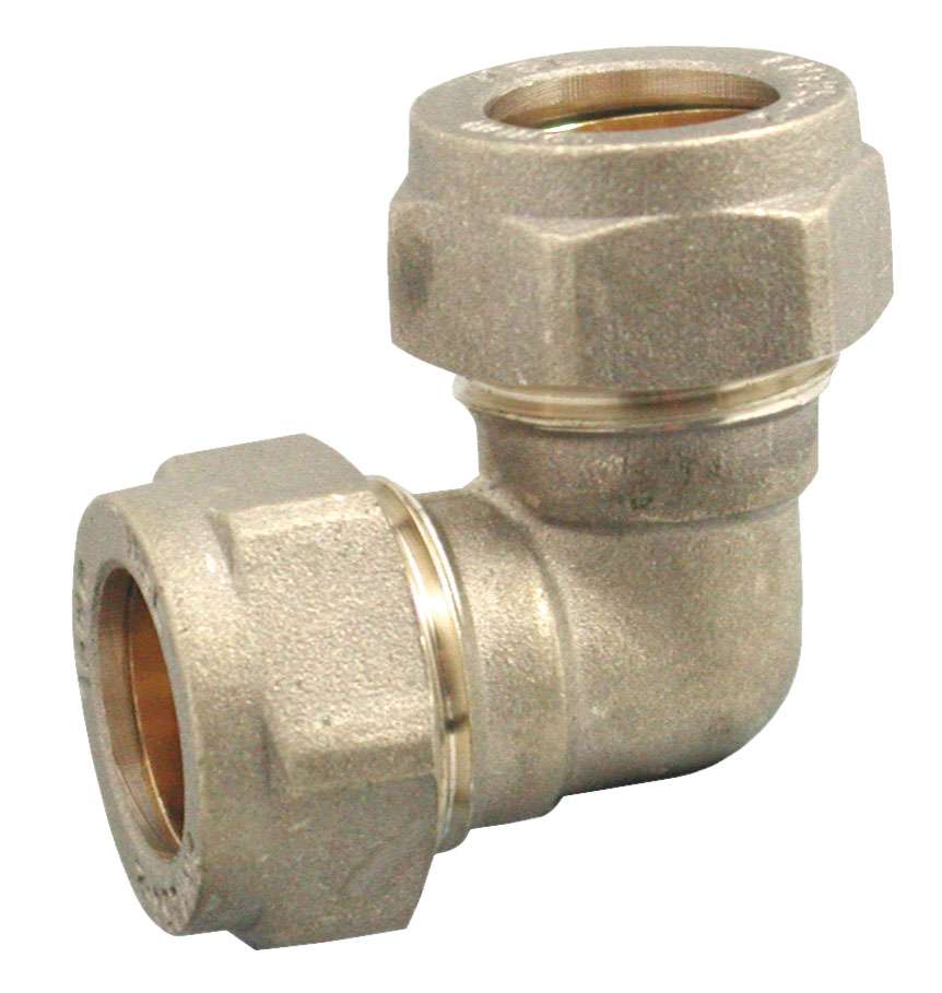

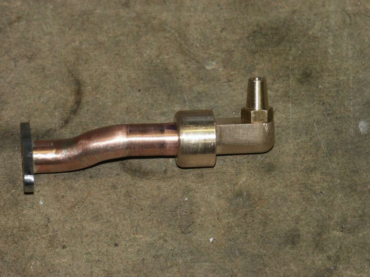

                  For really tight bends you can take a compression elbow
                  elbow
                  Chop and file it a bit
                  IMAG1365
                  Add soem flanges and solder together
                  IMAG1366

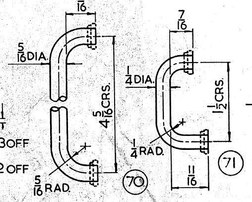

                  #712692
                    This shows the  1D bend radii required on the drawings

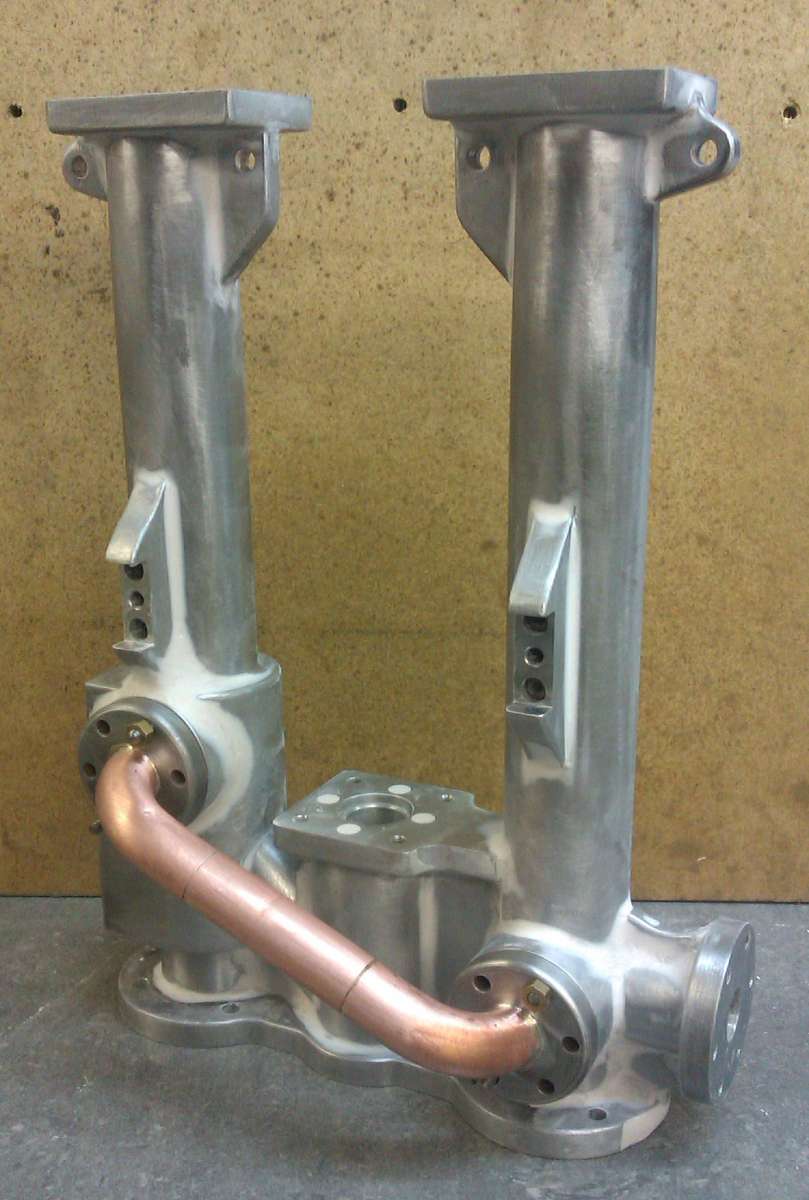

                      Another method I have used which is good where you have two bends close together which can make it hard to get the bending formers into position is to make a series of cuts with a piercing saw that go almost through the pipe. You van then bend it which closes up the keft and finally silver solder it all back together, the thin piercing saw kerf fills easily with solder don’t use a jnr hack saw.
                      PICT0147 (2)

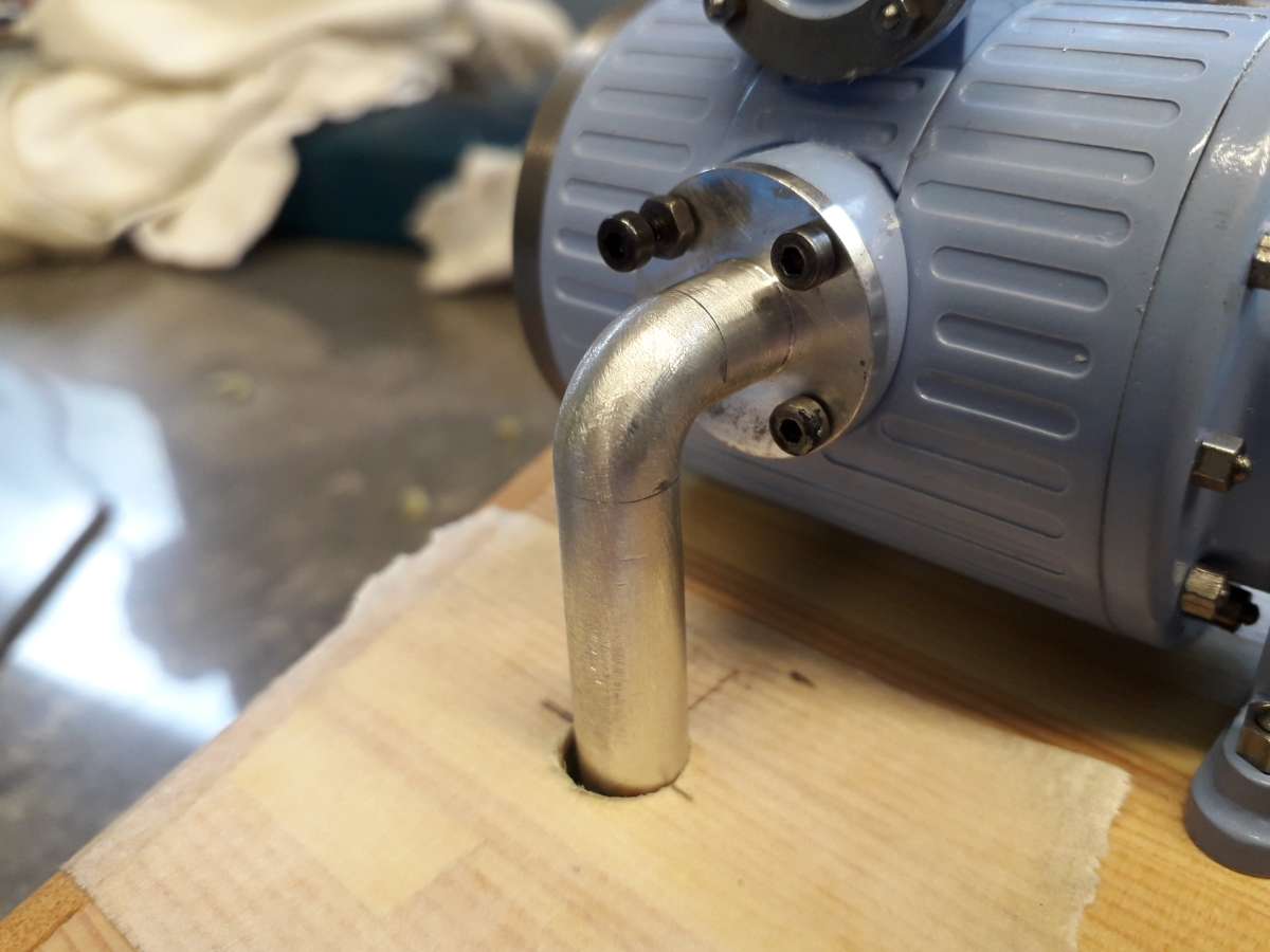

                        #716709

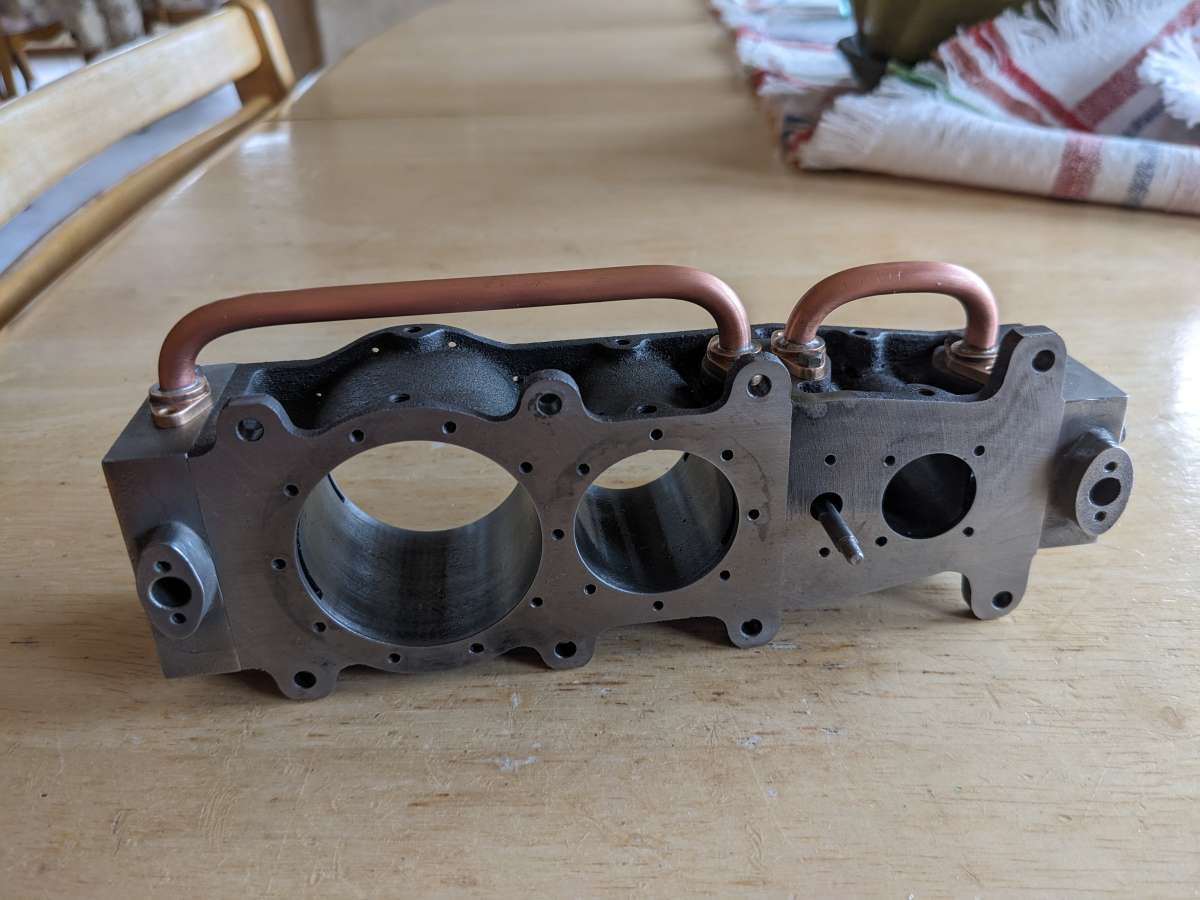

                        atomarc
                          @atomarc

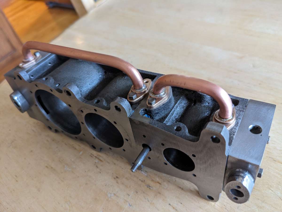

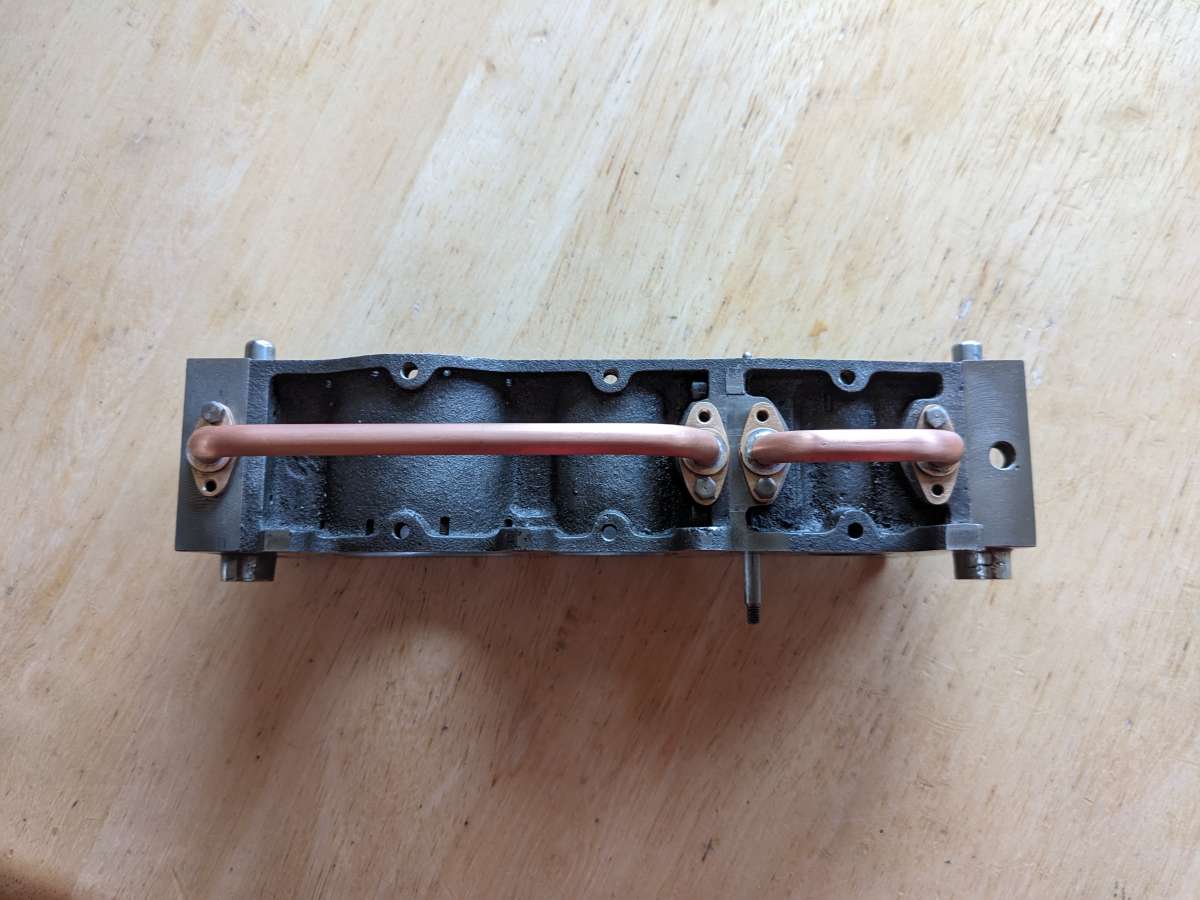

                          I read all the above posts, built a small bender specific to the radius called out in the Stuart print and started messing around. After several attempts, this was the end result, which I’m fairly happy with. The long tube was bent after being filled with Cerrobend 158F to prevent distortion, and the short tube, although not quite perfect, was filled with sand out of my blast cabinet. Several tries were required to achieve a accurate center to center distance on the bends. There is no gasket between the LP steam chest and cylinder casting at present, and as this engine will only be run occasionally on air,  I intend on using a thin smear of some silicone or similar material which won’t alter the center distance of the long tube.
                          I’m happy with the results, they’re better than I anticipated..and that part of the model is DONE, yahoo!
                          Stuart Miller
                          Eureka, CA USA
                          PXL_20240228_164451108PXL_20240228_164526475PXL_20240228_164352875
