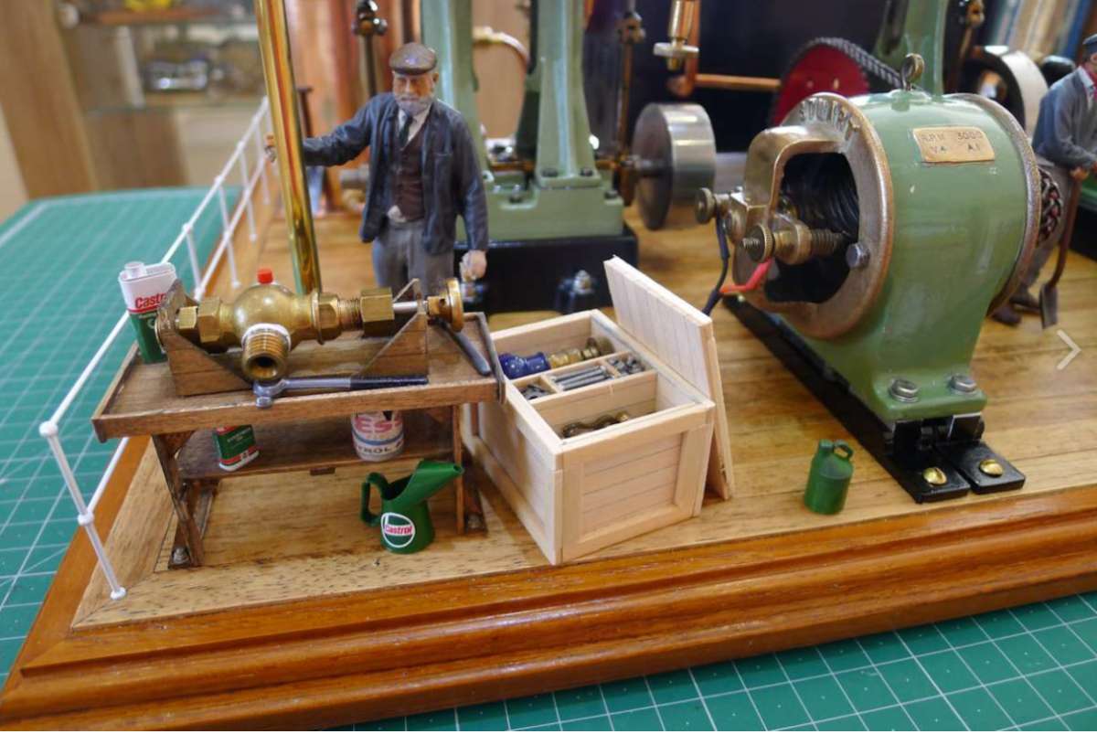

        Hi, well I like it a lot, yes the switch did look out of place, but the addition of the spares box has really overcome that problem. Well done Richard.

              Many thanks for the comments gents.  I eventually decided on a scale of 1/19th for the figures.  I think there is a fair degree of leeway but I thought 16mm was a reasonable size to give the engines an imposing feel while still having a large enough figure for detailed painting.  Doll’s house figures would have looked too big and been in danger of becoming the subject.

                May I suggest three minor improvements, replacing parts out of character with the rest.  Nothing difficult, and they offend my eye!
                improvements
                The switch at arrow ‘A’ is clearly designed for human fingers, and its scale is wrong for the model.  And the d*mn thing being bright and shiny catches the eye.    Nothing that size and shape existed in an engine house!  Could be hidden round the back or replaced with a simple home-made brass knife switch scaled to match the man.
                The plastic twin cable connected to the dynamo is also a bit out of place, though only a pendant might notice!   First, wiring is never run at anything other than a right-angle, so drop it straight down to a new hole in the floor.   Second, plastic insulated wire could be replaced with shiny brass strip or thick copper wire.   Both look more like the open busbars found in early electrical installations, and would match the look of the steam installation.
                The way the dynamo is fixed to the floor looks odd to me.  No Aluminium in early engine rooms!   The sticky out feet are unnecessary and the mounting seems over-complicated.  Might be a poor implementation – an old dynamo I saw in Wales had a similar arrangement, except it the slim Aluminium in the model was replaced by a hefty balk of timber, a good way of reducing vibration on the cheap.  I’d be happier if the model dynamo were bolted straight to the floor, or the Aluminium was disappeared by painting it black!

                                A great looking restoration. The box over the switch is a great solution to hide the chrome looking switch, did you make it a lift-off to turn the light on or have it so you slide it to operate the switch.

                                  Dalboy, the original intention was simply a cover to be lifted off to enable access to the switch.  However I made the fit around the switch lever so close that the box can be used to operate the switch without lifting it.

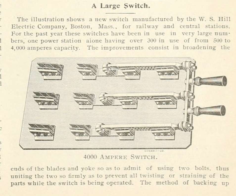

                                    Sorry for the topic drift, but I thought you might like to see the bigger one
                                    IMG_0980
                                    Ref. https://archive.org/details/electricalworld24newy/page/451/mode/1up?view=theater

                                                  The tool box is an excellent way of hiding a non scale switch, whilst leaving it accessible, and adds to the general “feel” of the model which is now a thing a beauty, and a tribute to the restorer.
                                                  It shows, excellently, what a workshop would have been like a century or more ago.
