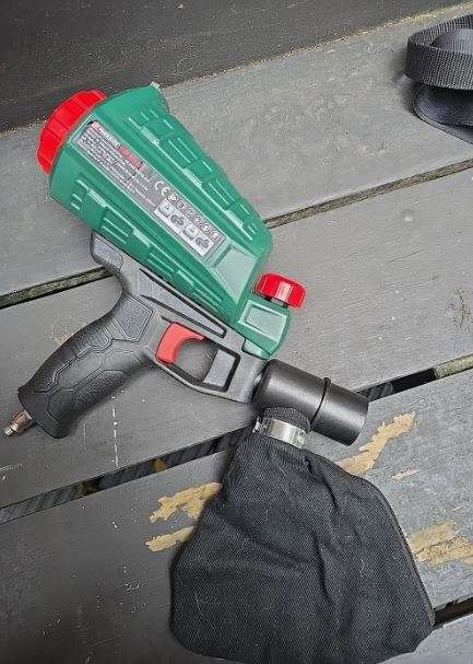

                    Keith, yes I do it myself. Nothing fancy just a Parkside (Lidl) spot blaster, sack of glass beads and a cardboard box. I do loose a bit of the blast medea but 90% can be reused. Just be careful if you have a smooth floor finish as the beads will turn it into an ice rink.
