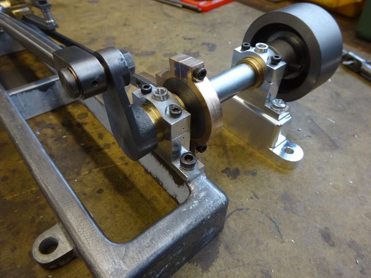

      #821864
        No problem with making new bearings. Even cheaper and easier would be to make the pedestal from aluminium and then have a solid or split bronze bearing to fit that. Have a look at this post of mine for how to go about it.
        I tend to use a liquid gasket so don’t make any allowance for the thickness. If you want to use a proper paper gasket then then allow 4to 5 thou for something like Oakenstrong.

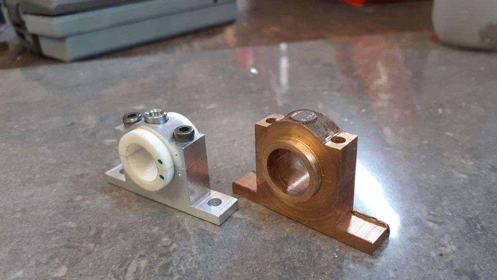

          #821890
            It was the gun metal bearing that I was talking about not the cast iron outrigger support pedestal.
            Stuart’s on the right, fabricated on the left.
            bearing
            DSC04179
            For the amount of running it is likely to get then brass or one of the bronzes will be fine, If you have got to buy it in then 660 bronze would be my choice.
