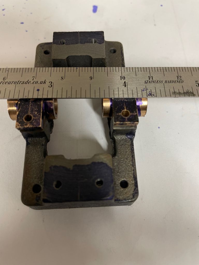

        Hi, I am brand new to this Forum. I bought a Stuart 10V Kit (unmachined). I also bought a book "Building a vertical steam engine from castings by Andrew Smith" revised by Pengwern. I notice that the outside dimension of the crank web on the Stuart drawing is 5/8" and in the book it is 11/16". Has anyone else come across this? Also, when the engine is assembled do the outside faces of the crank web run against the inside faces of the crankshaft bearings.

          To answer your last question the distance between the bearing inner faces and the crank webs should be the same plus a small clearance. On my engine, built in the late '70s, I'd estimate that it is a couple of thou. On the plans that came with my casting set there are some build notes and with reference to this it states "The shaft should turn without binding in the bearings but with practically no end play".
          In my book, which is "Building a Steam Engine from Castings" by Edgar Westbury, not Andrew Smith, the crank webs are shown as 5/8" wide the same as the drawings. Check the distance between the mounting hole for the bearings in the base casting and the distance between the mounting holes in the bearings and the inner faces of the bearings. They should be the same as the width of the crank web plus a few thou. On my drawings, and in the book, the distance between the holes in the base casting is 1 1/4" and the distance from the mounting hole in the bearing to the inner face is 5/16" so when mounted on the base casting the gap between the inner bearing faces is 5/8", same as the crank width. Obviously there also has to be a small clearance as stated above so the crank can turn freely.
          Check these dimensions on your plans, an in the book, and see how they add up.
          I'm not sure this has answered your question but I hope it helps.

            Just measured mine and the crank is 5/8" with just a running clearance between it and the bearings

                One thing I forgot to mention though about the crankshaft bearings. The turned O.D. dimension of 27/64" at either end have lengths of 1/8" and 5/32" I am assuming the 1/8" dimensions are positioned on the inside of the soleplate!!.

                  No, as John hinted at they face the inside and leave a 5/8" gap for the crankshaft.
                  If you look at the soleplate drawing it shows the stud holes at 1 1 /4" ctrs
                  Middle section of bearing is 5/16" so middle to edge is 5/32"
                  Protruding round section also 5/52"
                  So when assembled you have 5/32 + 5/32 + 5/8 = 5/32 + 5/32 = 1 1/4

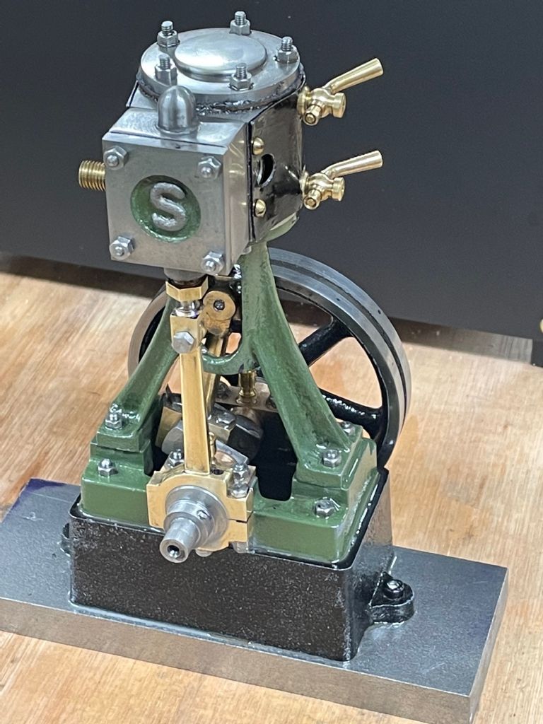

                                              Steve Rowbotham
                                                @steverowbotham77083
                                                Hello Scott, sorry I'm a bit late to this thread, only just seen it. To answer your question 'has anyone else come across the 11/16 vs 5/8' issue, the answer is yes I did earlier this year. I am new to Model Engineering, this was my second engine and I had the same dilemma, so I decided to make machine the base casting and bearings and measure the width between the inner faces, and found it to be 11/16 as per the pic below (bit of interpolation needed!). I then made the crank to the 11/16 dimension, it was a tight fit between the bearings and needed a little easing. I would be interested to hear how you got on with this. I finished the 10V a few months ago, and am very please with how it runs (on steam). I have now bought the reversing gear which which I will tackle after my current project, the Stuart Beam which I am currently half way through. Steve
                                                img_2038.jpgcompleted 10v
