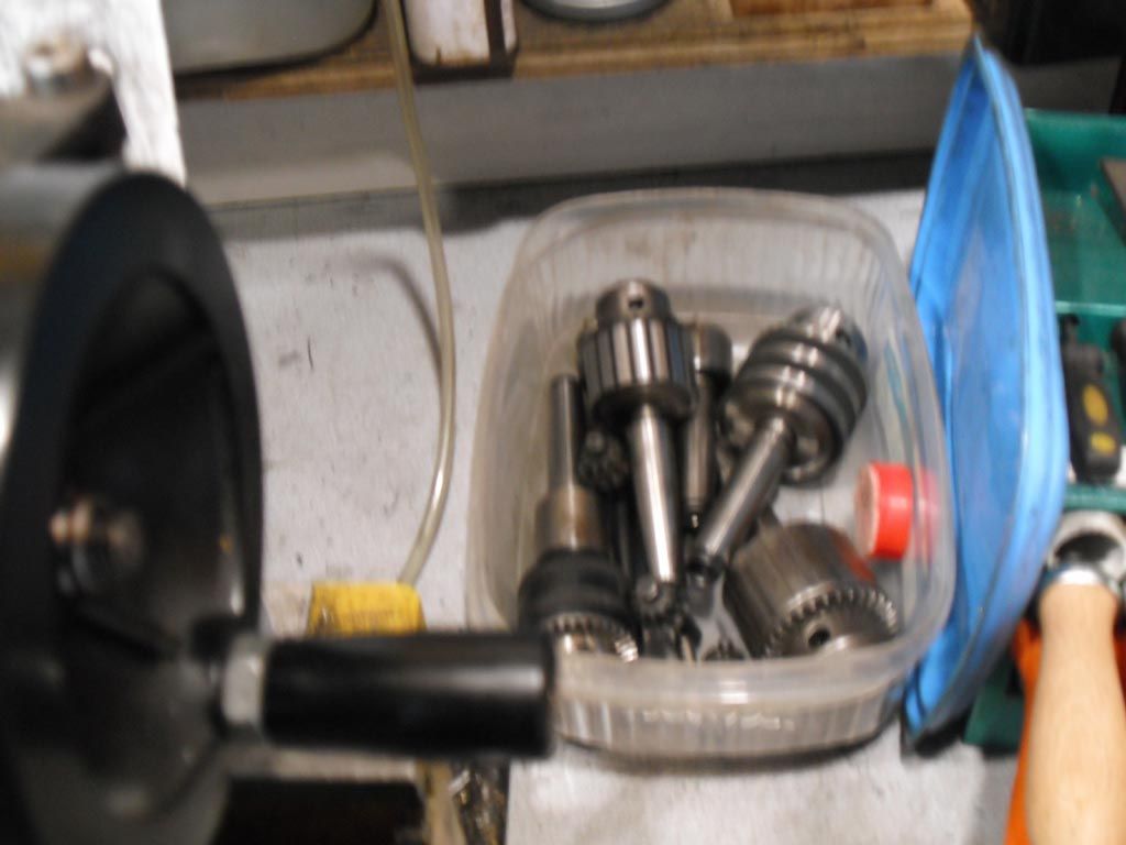

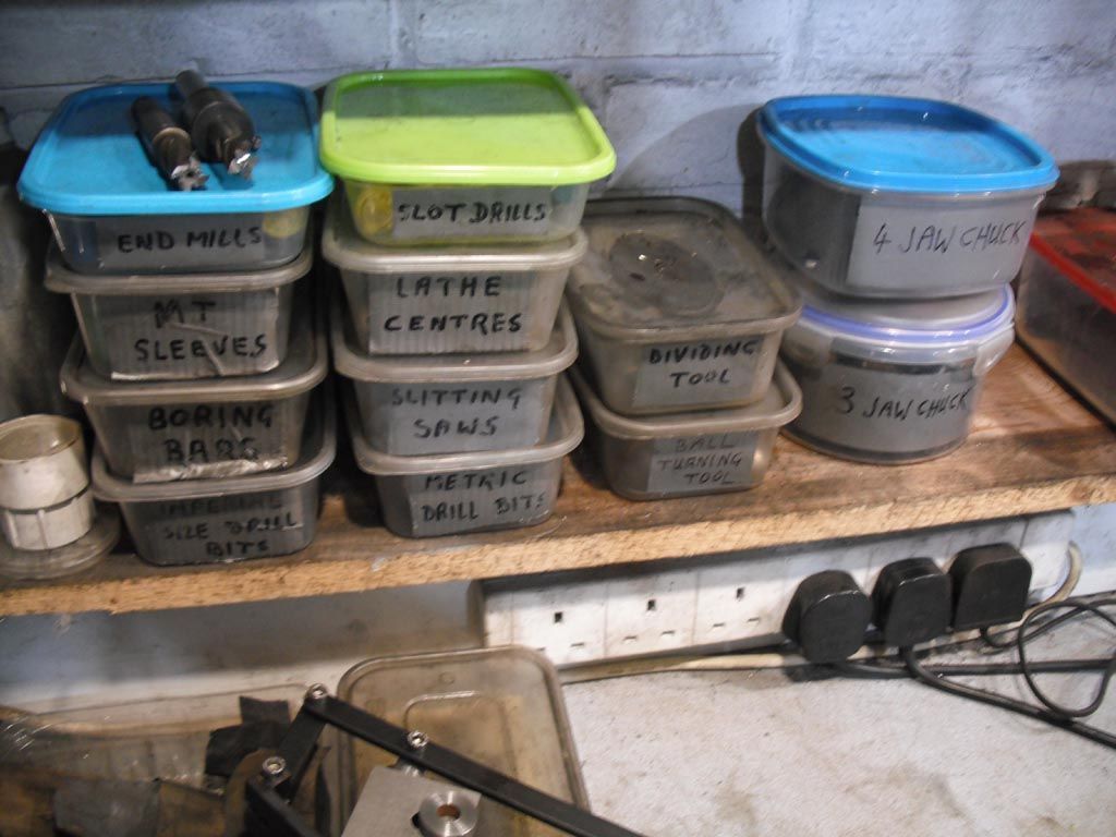

                                                    I have a Bisley 10 Drawer unit to store various varieties of taps and dies and ER 25 collets.
                                                    Because I have damp problems in my garage/workshop most of my equipment is stored in plastic food boxes.
                                                    Drill chucks are also stored in a plastic box at the tailstock end of the lathe.
                                                    Standard drill are stored behind the chucks.

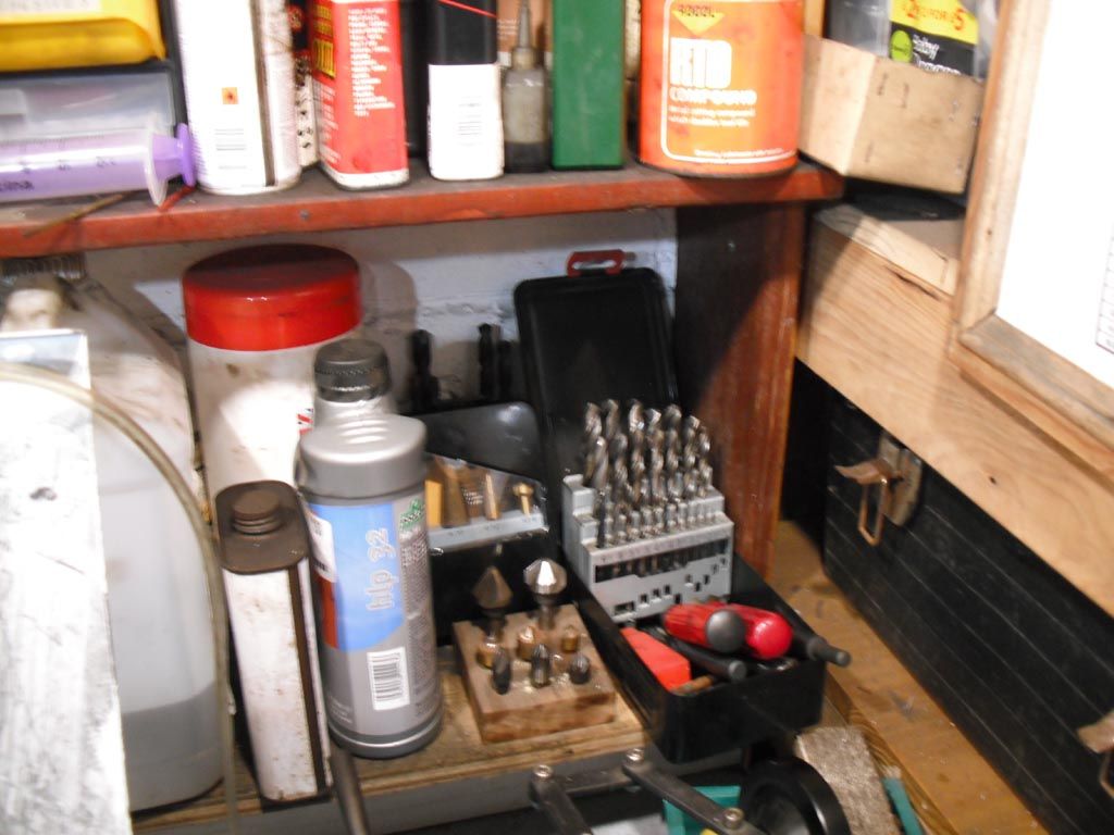

                                                    Because of the damp, sensitive measuring instruments, gauges etc are kept in a cabinet which is stored in the house. The photo also shows two ring binders which currently list power tools and workshop equipment These contain print out of photos, user manuals and where possible purchase receipts. This is for insurance purposes (we all know what a bunch of crooks insurance companies are). It will also help my executors when I go to the great workshop in the sky.
