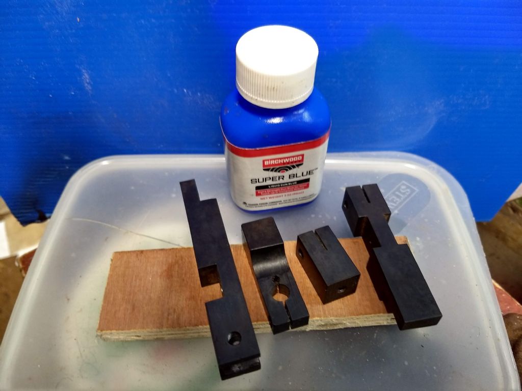

                          I've had success with a product called 'Super Blue' made by 'Birchwood'. It can also be used to give an aged look to brass.

                            Gary – that looks good & fairly easy to use according to what I've just read on their website. The chemical system I use at present has about 4 bottles and although straightforward does take some time, and fiddling about with containers etc. Does it give a reasonably long-lived finish?
                            regards Mike

                                Mike, the pieces in the photo were coloured in early 2021 and still look fine despite living in a very slightly damp cellar workshop. In fact I can't see any change from the day I did it.

                                                Posted by Gary Wooding on 04/03/2022 12:23:46:
                                                Hi Gary, thanks for the feedback – looks quite promising, so I'll proably invest in a bottle soon.
