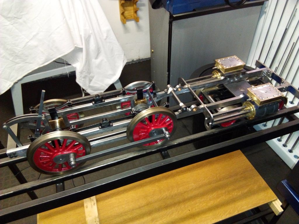

                          I've tried hardening it – heating it to red and quenching in water. It does seem then to have better spring characteristics than the natural state. It certainly doesn't snap in half as it would for a high-carbon steel if quenched and not tempered. Both my last two locos have it for axle springs.
