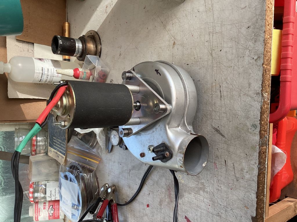

                        c57e96cf-0a63-43af-963e-669bcc79f10a.jpegHere is one I have just finished today using a gas boiler fan and a model aircraft stater motor. Made for use with my 3 inch traction engine and fitted with a speed controller to control the rate of flow. All parts from EBay.

                          Many thanks for your replies. Yes I new one wouild be nice but at £140 odd a bit too dear. I have managed to pick up a couple of gas boiler fans, a couple of e scooter electric motors and a speed controller off eBay total cost £40. Allways usefull to have a spare blower handy. Many thanks for the gas boiler blower suggestion everyone.
