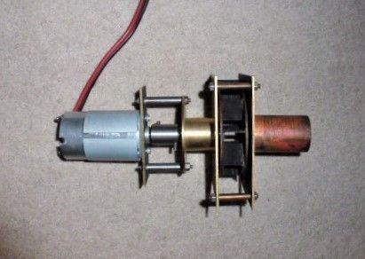

                            I found blowers hard to source so I made one.
                            The rotor is 2 brass discs with 8 radial blades, o/a diameter is 2.5", all silver soldered. There's no real need for a volute. The rotor shaft spins on small ball bearings. At the high speed that it rotates I .found balance fairly important. The motor is 12v. All items were either from the scrap box or Ebay.
                            Raises steam OK on my Allchin and Simplex.
