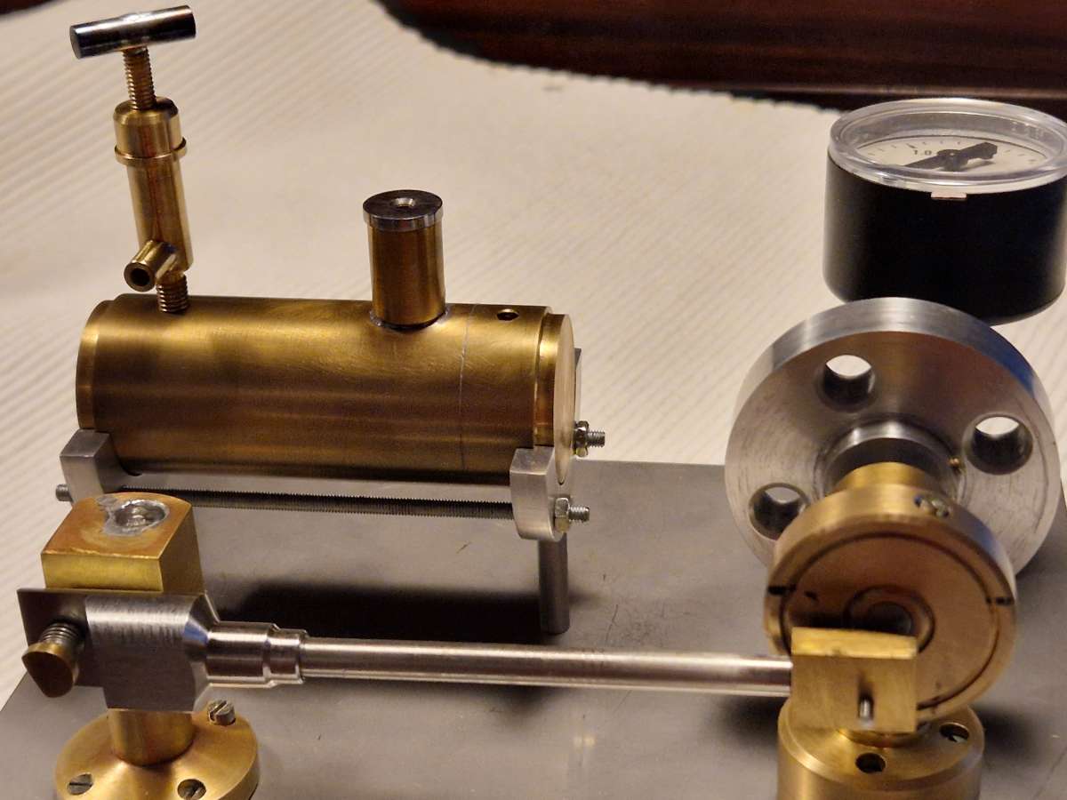

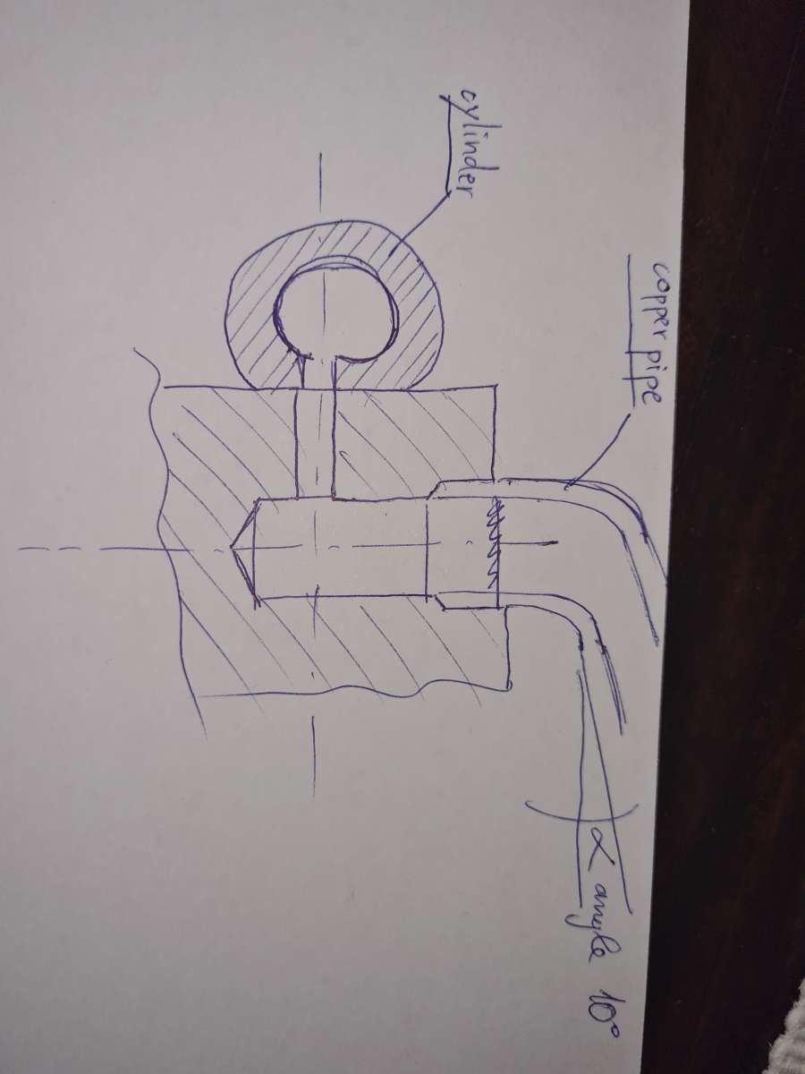

      Hi,
      I started doing work on pipeline and I encountered 1 problem. I will bend copper pipe at a little bit of angle for condensate to flow down. I drilled hole a little bit deeper then hole for steam to flow into the cylinder so condensate could sit there and not clog cylinder with condensate. My only concern is that steamer flow will be very slow because I know steam doesn’t like 90° angles and this one’s even worse becouse its drilled and not smooth as pipe. Will there be to much condensate? I added cross-section sketch for reference. Should I have drilled hole different. Does anyone have any experience with this?? I also added model image for cylinder reference. 20240215_21584720240217_190035

        That’s a neat design!
        I don’t think you need worry too much about 90º bends on a small model like this, but you can buy or make small pipe-benders for such projects. Their minimum bend radii are 3X pipe diameter.
        Nor the drilled passage: most internal steam-passages on model steam-engines are simply drilled, and they work well.
        Smooth bends and smooth passage walls really only matter on larger, more powerful engines where you want maximum efficiency.
        The sketch did not appear – well, I can’t see it here anyway. So don’t really understand where the drilled hole is, but you need remove the condensate somehow, until the pipe and cylinder have reached their operating temperature.
        Am I right that this an oscillating-cylinder engine, with the cylinder held to the port face by a spring? If so the cylinder will tend to lift slightly off the port face if it becomes full of water. Usually, the condensate in such an engine blows out of the exhaust.

          Hi thanks for reply. I will again add image, I hope this time you will be able to see it. Im really worried of condensate building up and filling cylinder to that extent that engine would stop spinning because this boiler will probably be able to produce wet steam, and yes its oscillating-cylinder engine. I will also insulate pipeline with layer of ARMAFLEX. 20240217_190035

            Thankyou – yes I see it now. That drilling won’t stop the cylinder filling with condensate when it is still cold. Most of the condensation happens in the cylinder, not the pipe, until it warms up and runs properly. That is true of more or less any steam-engine, even in full-size.
            Really, there is not much you can do on an oscillating-cylinder engine to help, but you could try putting a little drain-valve down-stream of the exhaust-port of the valve-face so the condensate can be removed cleanly until the engine is hot enough to run smoothly. You then close the drain-valve.
            It is still likely that you will have to help the engine to start, by giving the flywheel a push round each time the water in the cylinder stops it, but it should soon reach its running temperature and then run smoothly. During this process, don’t be surprised if the water escapes by pushing the cylinder away from the valve-face slightly.
            When I was a boy I had a “Mamod” model oscillating-cylinder engine, and that behaved in just the same way!
            Your photo and sketch seems to show the steam-pipe enters the engine by being soldered in place. It is better to use a union there (larger engines have a bolted flange) to make any future repairs easier.
            I’d also recommend you fit some way of lubricating the cylinder and valve-face. A simple way is to put a little screwed plug in the valve-block so you can put in a few drops of oil before steaming it.
