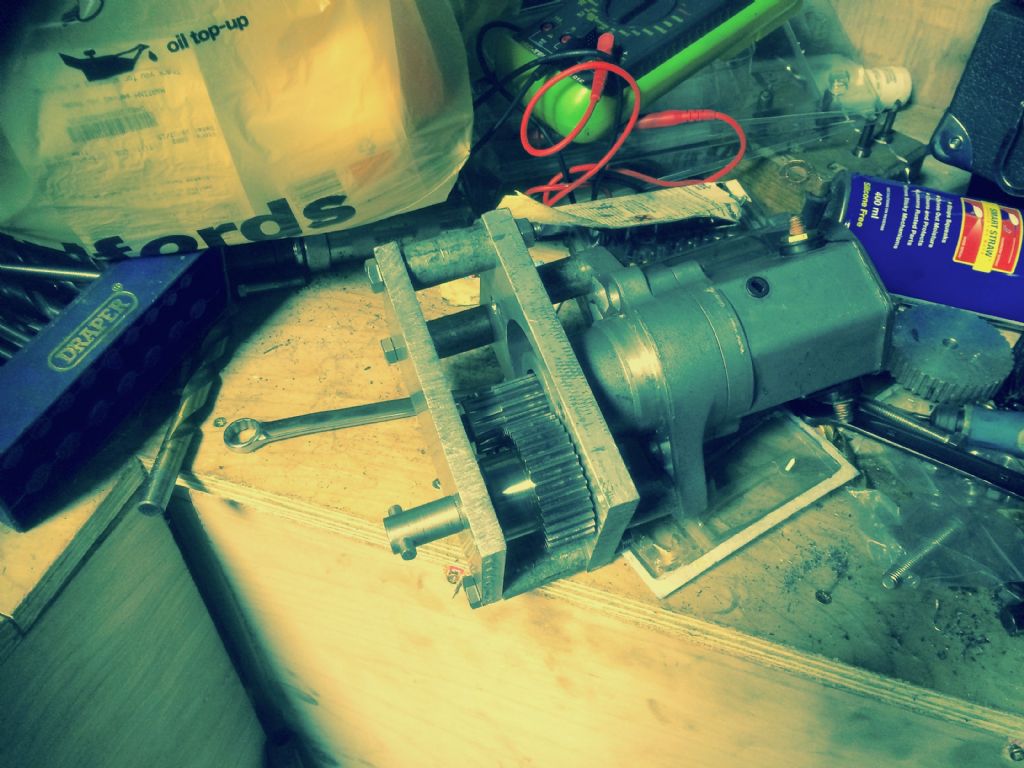

      The engine required only an oil change, fresh ignition batteries and a new prop to get it ready for a run, however years ago I there out the old car starter that I was using to start it the first time so I had to get a new one.
      I bought a 12 volt starter motor from a Ford Cougar off ebay for £30, this is a geared unit and I thought it would have enough torque to turn the engine without problems. However when I connected it to the battery I found the rotation was the wrong direction for the engine and it would have been very difficult to revers the direction as can be seen from the picture below.starter 1.jpg
      I decide that the easiest way to change rotation would be through gears of which I had a pair of 2-1 ratio so I set too and in an evening managed to make the starter motor as shown below.
      After a few minor problems at my local ME track I managed to get the engine started and it runs really nicely apart from a fouled plug due to too much oil in the sump.

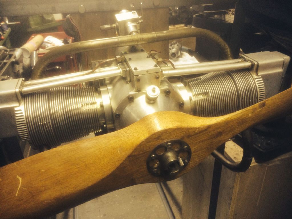

      Here is a picture of the prop nut that is engaged to start the engine.
      Here is a picture of the beast. The eagle eyed will spot the damage caused to the finning on the RHS cylinder (On left in Photo)after a block of Tufnol that was being used to raise a fuel tank for another engine fell off the top of the test stand and into the prop while the engine was running. Needless to say the prop broke and I needed a change of underwear.
