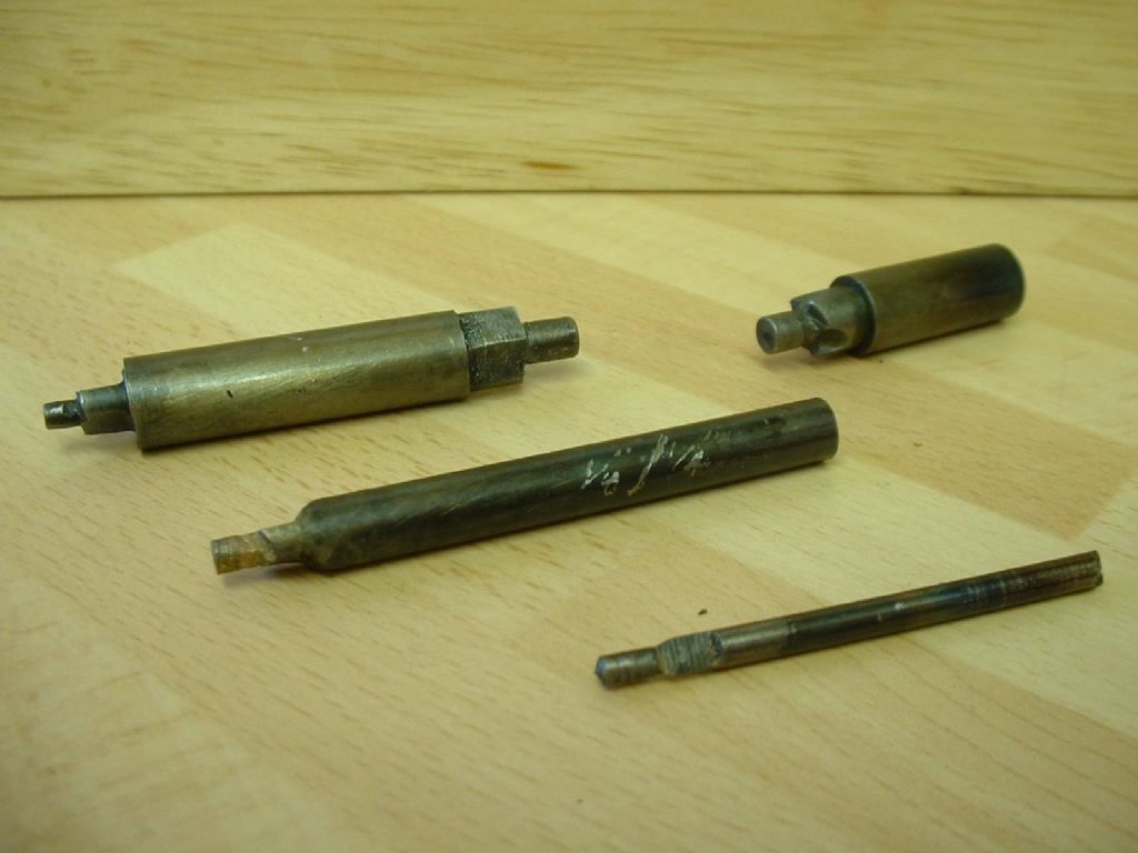

              Among my first self-made tools were spot facers for a 10V.
              Turn down the end of a suitable silver steel rod, files some teeth and harden.
              They can be very crude and still work:

                      Thanks – I've seen that method in my Model Engineering book. However, if I can use tooling I've already got for small diameters like these, I might as well?

                                          It's very easy to make a simpler type of spot facing tool, similar to a lathe boring bar made to hold a piece of 1/8" 0r 3/16" square HSS.
                                          Turn a piece of mild steel bar to fit in the drilled hole in your job, with a few thou clearance. Then drill and tap a hole in the end for a small grub screw. A small allen-type high tensile grub screw is best.
                                          Then back from the end a suitable distance, cross drill a hole just large enough for the piece of 1/8" square HSS to fit into. Grind the HSS like a lathe tool bit to cut on the edge facing downwards when the shaft is held in the drill/mill. You can even let the HSS stick out both sides and sharpen both edges. Clamp it in position with the grub screw.Be sure to grind plenty of back clearance on the ends so they don't rub on the curve of the spot faced counterbore.
                                          Or you may even have or be able to buy a suitable boring bar and turn or sleeve the end to fit your drilled hole in the job.
                                          Either way, the end of the bar sits in the hole in the job and keeps the cutter running concentric (well close enough for spot facing purposes).
                                          The cross drilling is easily done by making a drill bushing the same diameter as the bar you want to drill, with a hole up the middle same as the drill size you want to use. Then clamp the bar in the drill vice, with the bushing sitting between the jaws above it where you want to drill the hole. Easy peasy.
                                          I've done this a few times and it works well and is less work than making a "proper" spot facing cutter from silver steel and hardening and tempering it etc etc.

                                              Hopper these are 7BA clearance holes so not much chance od getting a grub screw up the end.
                                              My preference would be to take a piece of silver steel, drill with the same clearance drill that was used for the hole then cut off a small length. Over to the vice and file four teeth in the end then cross drill & tap for a grub screw before hardening.
                                              In use just fit it to a bar turned to fit the hole if not a stock size and away you go. For a small hole like this I may use a longer length of par and simply loctite the pilot into the end.
                                              They can also be used to reverse spot face if needed

                                                That's a good tip Jason, thanks I will remember that one. When hardened is the hardness of the silver steel similar to that of a standard drill bit.?
                                                Edited By Ron Laden on 16/05/2020 07:45:21
                                                #472063
                                                  Probably a bit less and certainly can't be run as fast or as hot as HSS
                                                  #472064

                                                    Posted by JasonB on 16/05/2020 07:02:47:
                                                    Aha. Impossible to tell from the pic with nothing to give scale. Yes bit small for the HSS dodge.
                                                    So what diameter is the OD of the spot face? 6mm or so? Seems like a small and flimsy slot drill would flex and wander easily at that size on an uneven cast surface so your pilot cutter would work much better.

                                                      OK I’ll give Jason’s method a go. Any tips on making the cutting edge – approximate geometry? And also hardening?
