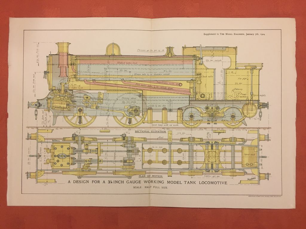

      It was described during the first months of 1904, in those days the M.E. was in the habit of giving away a coloured general arrangement drawing with the first issue of each volume

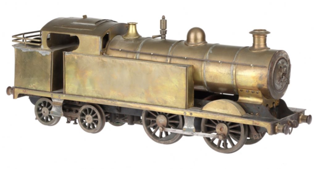

      It’s a large lump, the same length as an LMS 3F tank engine in 3.5” gauge, and a bit heavier. It doesn’t appear to have been finished (there’s no blower or feed pump), but it has clearly run. The first job will be to take the wheel sets out to fix the wheels onto the axles properly, they are all loose. As it will be of limited steaming capacity, I intend to keep it as 3.25” gauge and spirit fired, and perhaps make some temporary track to try it out
      My question is how many engines built in this gauge still survive? I expect a good proportion were rebuilt and regauged to make them more useful but some must be hiding in their original form, a century after the fashion for such large scenic railways started to die
