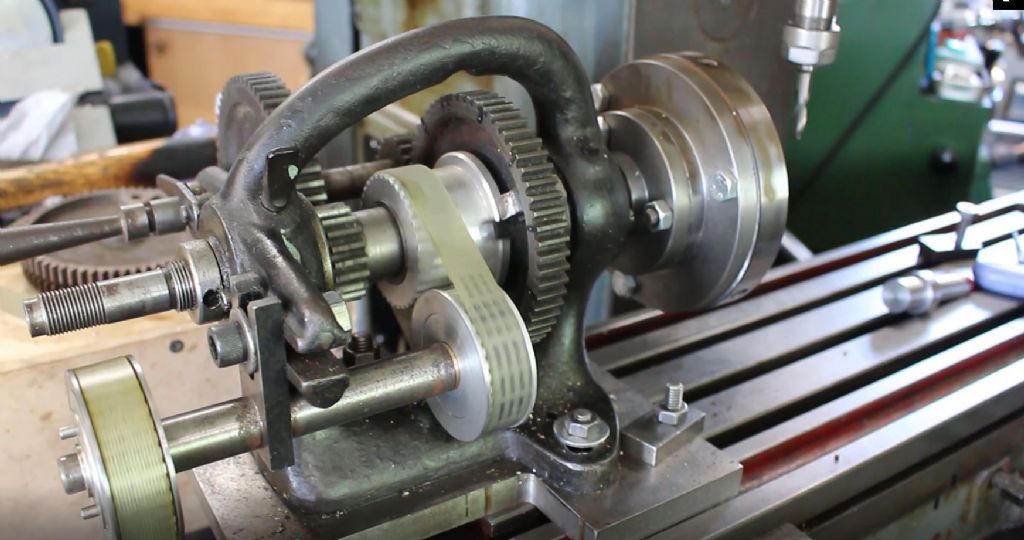

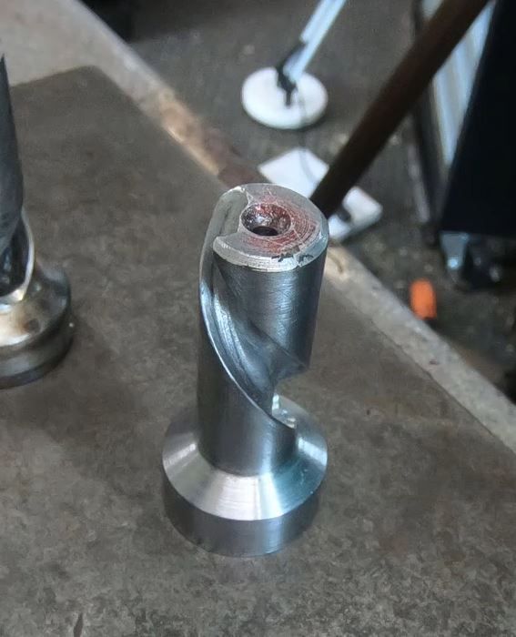

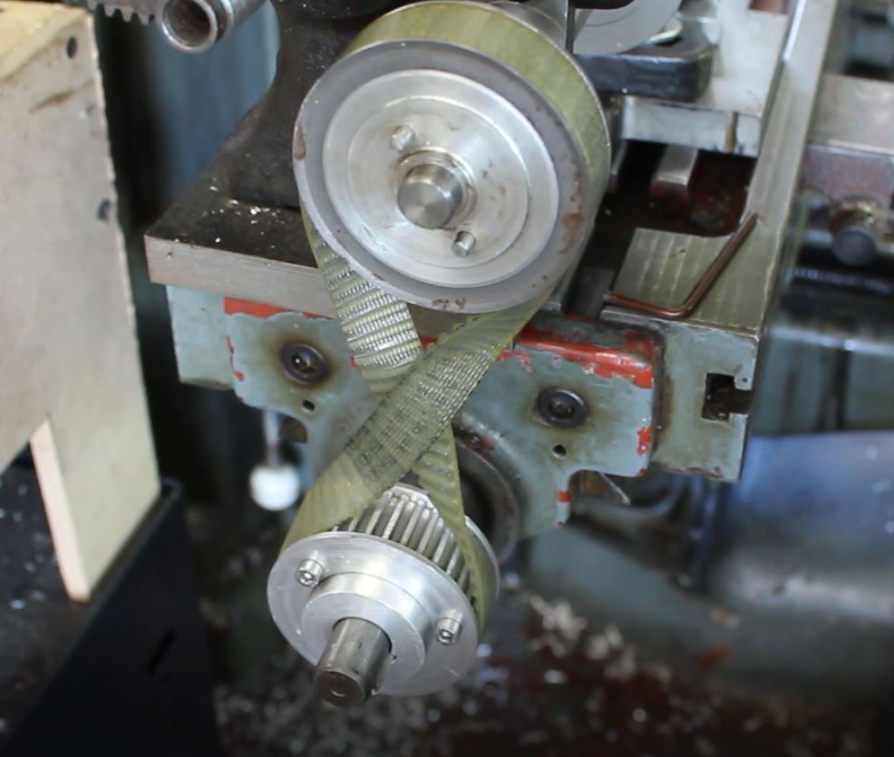

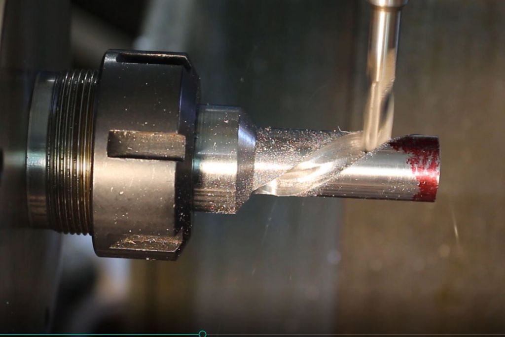

        A while back I converted a Drumond lathe head stock to work as a spiral milling attachment for my mill, photo's in my album.
        Recently I was asked to do an interesting job milling a spiral into a shaft for a throttle assembly for an old motorbike. I used the Drumond head stock and it worked out really well.
        The head stock is driven from the lead screw using a timing belt and pulleys, though in this case the belt had to be twisted to reverse the direction of rotation of the head stock, I've posted some pictures below.
        I hope this is of interest and helpful
        Nigel

        #550069
        old mart
          @oldmart
          You were lucky to get away with that crossed belt! laugh

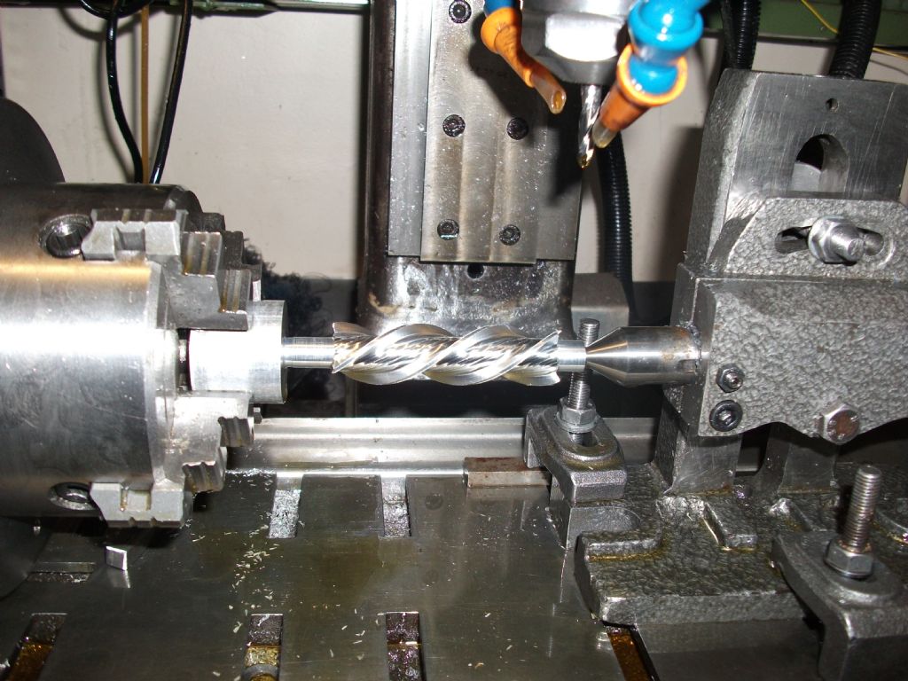

              I did a similar thing using a a rotary table and a right angle drill adapter.
              Les.

                #550086
                Ian Johnson 1
                  @ianjohnson1
                  Watched your video last night Nigel and was suitably impressed, it's one heck of a helix!
                  Just need a couple more videos now, one of the throttle operating the carb, and another one on making the toothed belt pulley, looks like drilled holes and round bar did the job?

                  #550112
                  GoCreate
                    @gocreate
                    Les, that looks a great set-up, I like the idea of using the right angle drill adapter. Getting a nice spiral groove is very satisfying.
                    Ian, thanks for watching my video, I actually used a form tool to cut the teeth on the timing pulley.grooving tool.jpg
                    Nigel

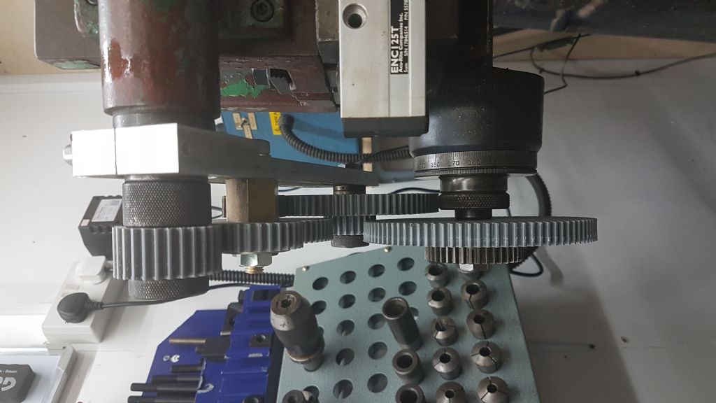

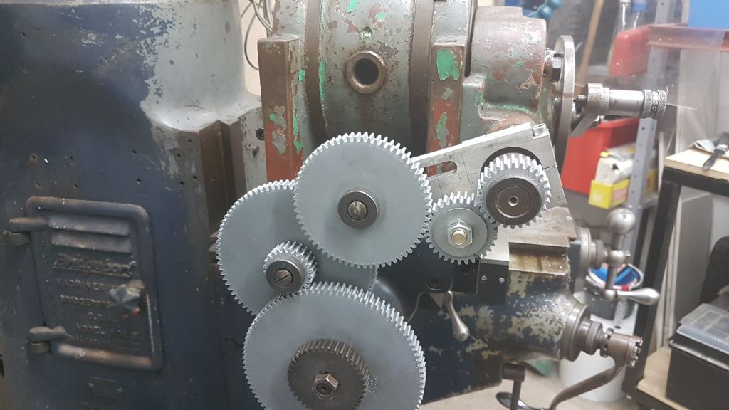

                        I did a similar job a couple of years ago, a 2 start square thread, I used gears rather than belts, but I did need to get a big gear ratio, I had to make the "banjo" and I 3d printed the gears as it was a one-off to make the part & 2 taps.
                        Not sure why this image is on it's side, it is not on my PC.
                        The cutter is 1/16", I used the handle on the dividing head to driver the table, the return was made & faster easier by making an adapter to use a socket on the nut driven from a drill.
                        Baldric
                        #550638
                        GoCreate
                          @gocreate
                          Impressive set up Baldric, that gear train must of taken some serious maths.

                            Baldric, is that a Bridgeport with a 36" table ? If so a prized addition where workshop space is at a premium.

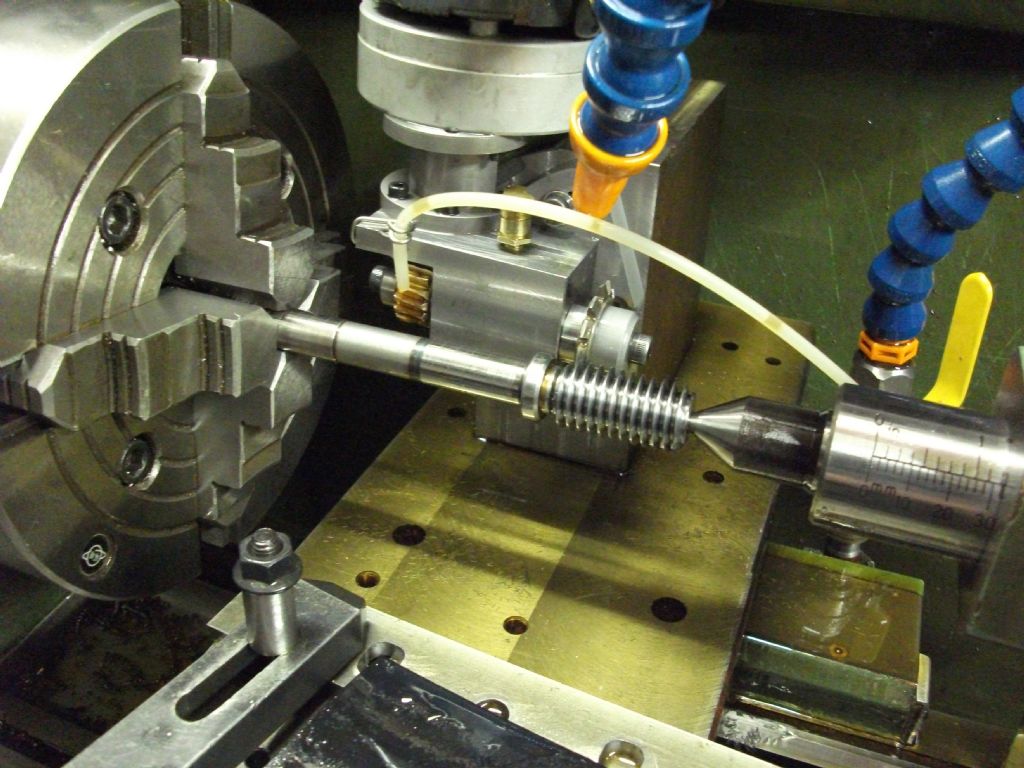

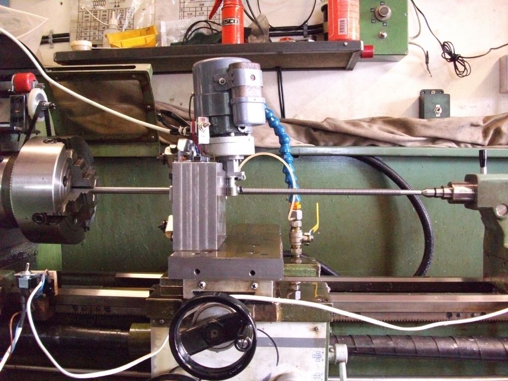

                            John P
                              @johnp77052

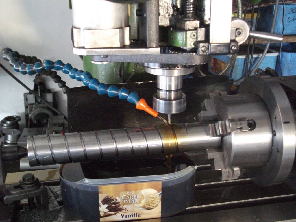

                              I made a provision on my Warco milling machine to drive from
                              the lead screw to some form of spiraling head ,it never was used.
                              The cnc route turns out to be a much more useful method ,easier
                              to set up and to get the result that you need ,here are some that
                              i have done in the past.
                              #550792
                              GoCreate
                                @gocreate
                                John, some interesting spiral milling, allot of versatility in the cnc route.
                                Nigel

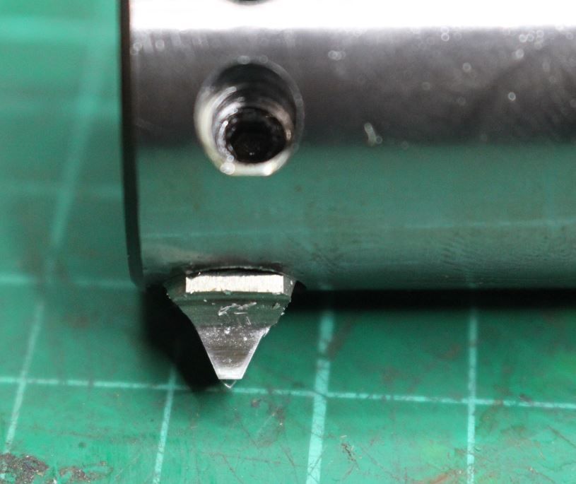

                                  #550876
                                  John P
                                    @johnp77052

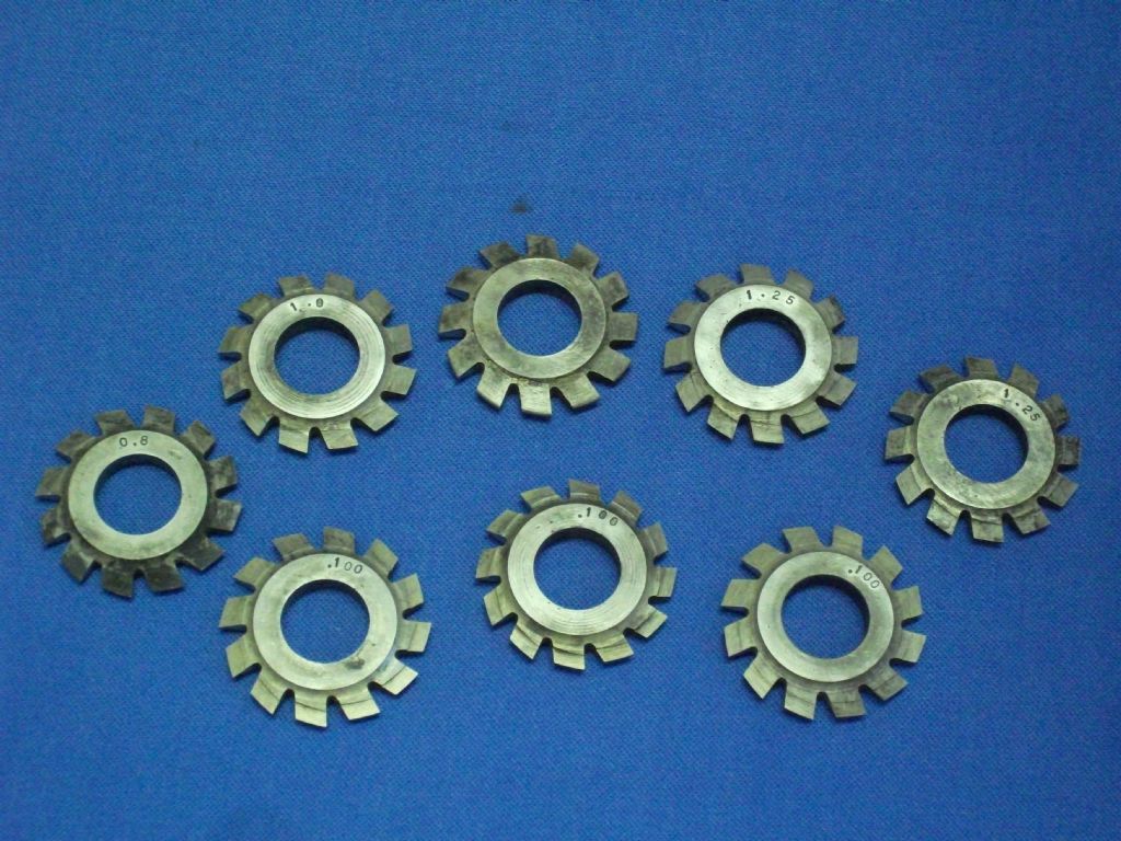

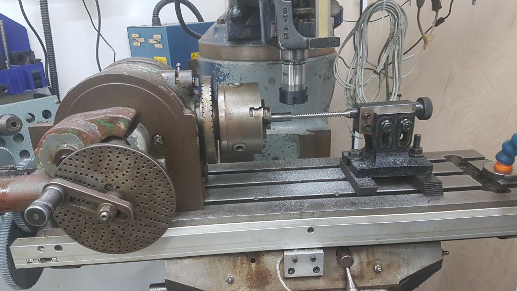

                                    Some spiral milling photos here 10 Tpi 1/2 inch diameter leadscrew finished length
                                    about 20 inches , can be cut to full depth in a single pass , although i usually do a single
                                    roughing pass and a second cut of about .010 " , rotation of work about 1 1/2 rpm.
                                    Climb milling leaves a no burr finish, en8 is a good choice as it cuts clean and a
                                    little stonger than free cutting steel.
                                    Cutters seen here form relieved from silver steel on the Eureka device.

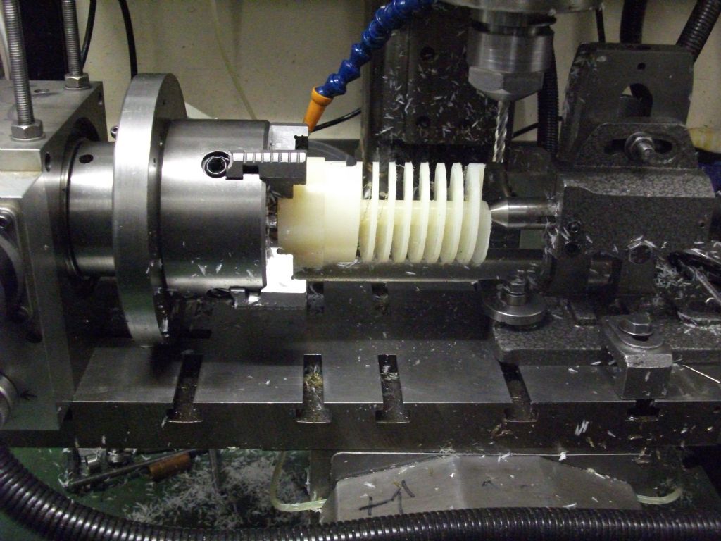

                                    Useful for cutting worms , i use the cnc part of the machine for these odd pitches
                                    as the pitch can easily be corrected to suit the chosen diameter, this one is 1 mod
                                    for Vertex rotary table
