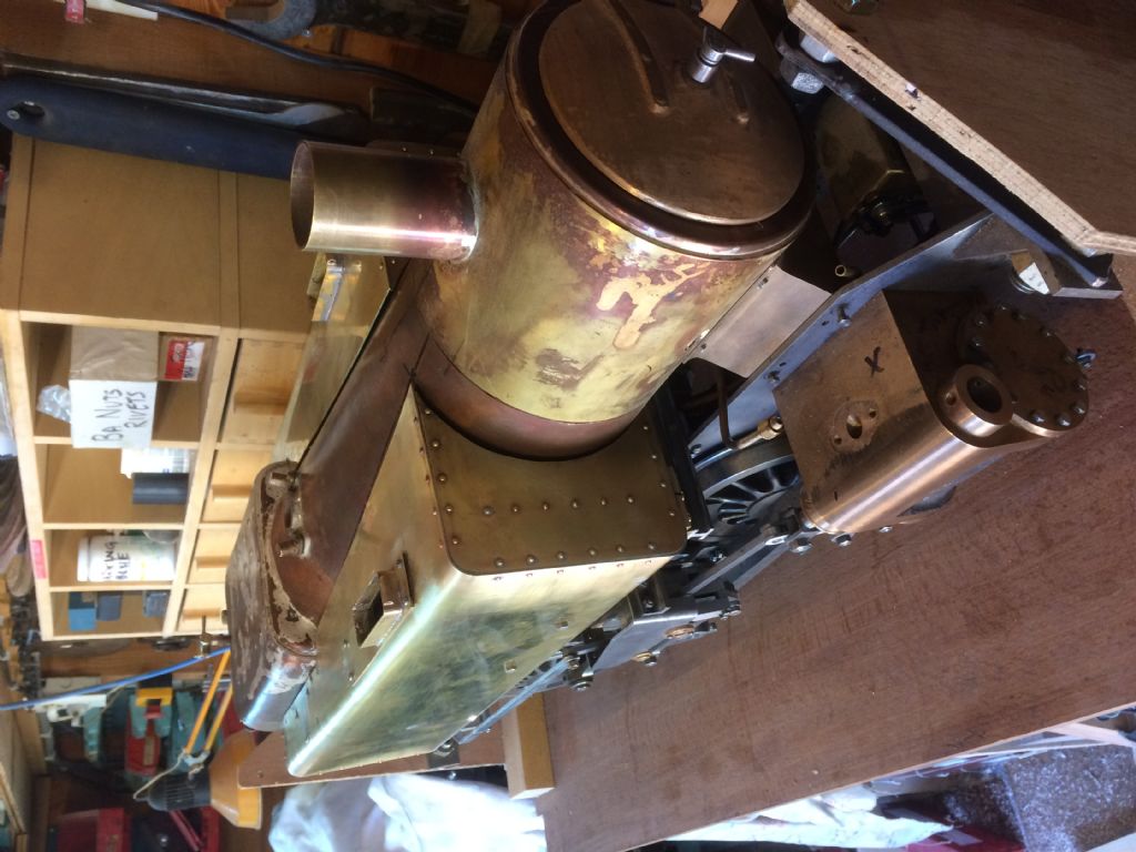

                      Speedy Builder5
                        @speedybuilder5
                        HI MP2, I am a slow builder of 5" Speedy, have made several mods and at the stage of making the cab now. Once done, it will be time for boiler certification and initial steaming trials.
                        You can see from the photo, this Speedy is for doing the wall of death instead of horizontal tracks. Ps in spite of seeing methods for rotating photos, my puny attempts have failed. I see that via edit you can do all sorts of things except the most common reqiest is rotation. Bob (in France).
