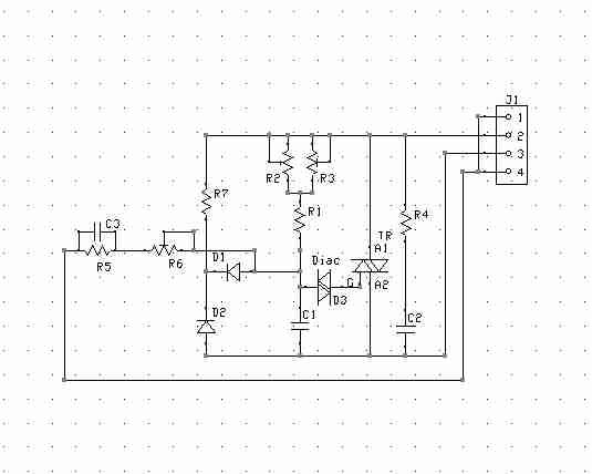

        Malcolm Parker-Lisberg
          @malcolmparker-lisberg38138
          The low cost dimmers from Hong Kong can hadle 2KW, cost about £1.18, I have a simple modification which adds a little piggy back board to give feedback. It senses the back EMF generated and uses that to compensate for the speed drop under load.
          .R5, R6, R7 D1, D2 and C3 are the components that are added to the module. The module connections are changed and what was the input becomes the output and vise versa.
          I will be adding a Youtube video of the process later this week.

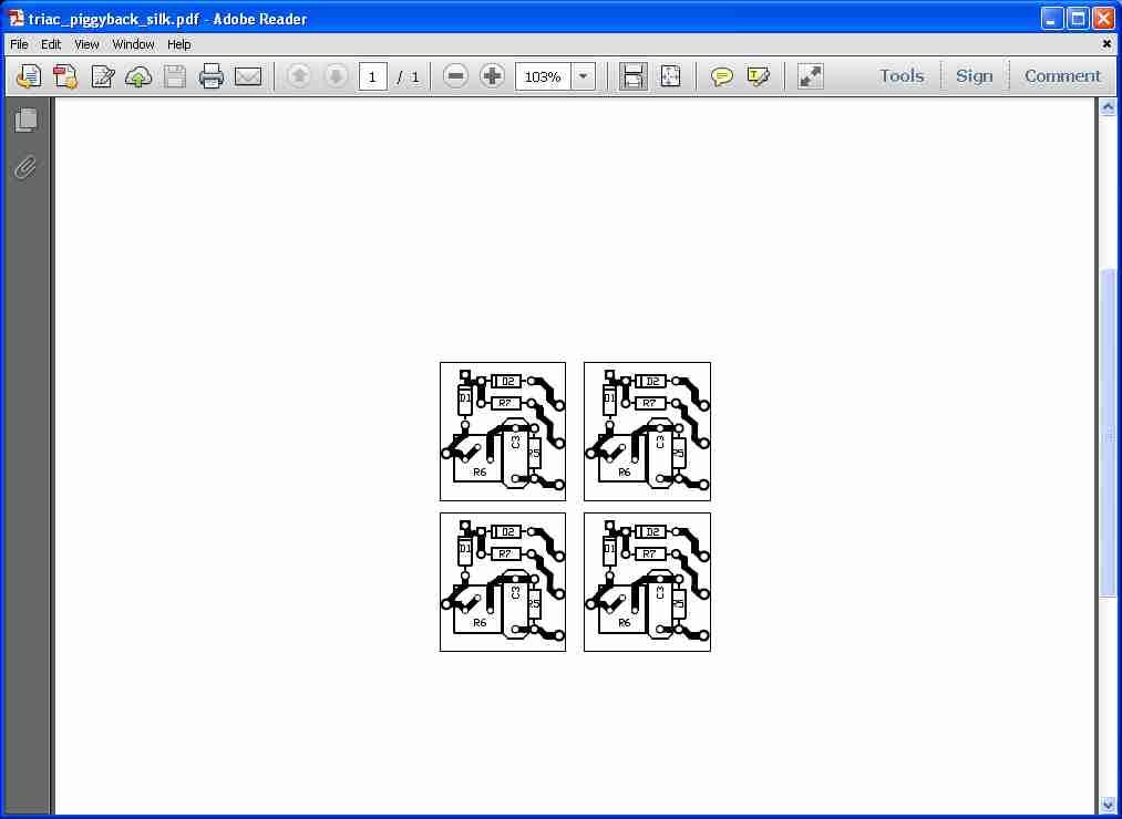

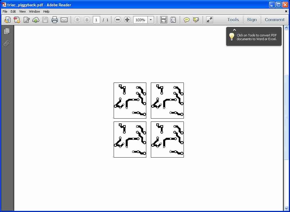

                      Give me chance to do the Youtube video, all will be revealed.
                      ICircuit was a screen grab, dots are the layout grid.
                      R5 & R6 100K, R7 15K, C3 10nF to 47nF dependent on motor characteristics. D1 & D2 1N4007. All other components as supplied on the dimmer.
                      A toner transfer PCB holds the components for the piggy back board with four leads between the boards.
                      I will post a image here of the PCB layout, see below
                      The ESR board is no better than the Hong Kong dimmers, as it does not have load compensating feedback.
                      Your are playing with leathal voltages, so be safe. Best to do test work with one of those Garden mower type ELCB modules that are designed to shut off the power when you mow the power lead.

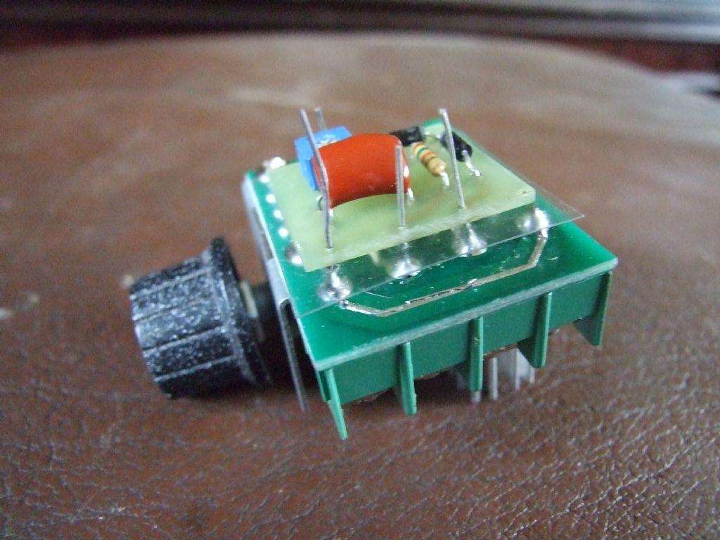

                                                I built the first of three and it works fine, About to do the video and started having eye troubles so everything was put on hold. I visited the hospital today and an operation is needed, but should not stop me from doing the video shortly, hopefully next week. The first unit controls a food mixer motor driving my wood lahe to be used for casting pattern making. The wood lathe dates back 50 years and is a Stanley Bridges wood lathe that was driven by a power drill. The second unit has an external electrically isolated heat sink to cater for the full 20 amp rating of the triac.
                                                Photo of first unit showing the attachment of piggy back board to the first unit below.
                                                Malcolm
