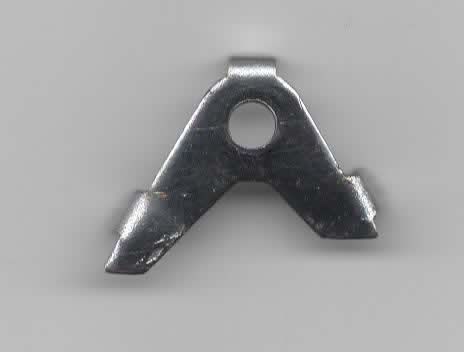

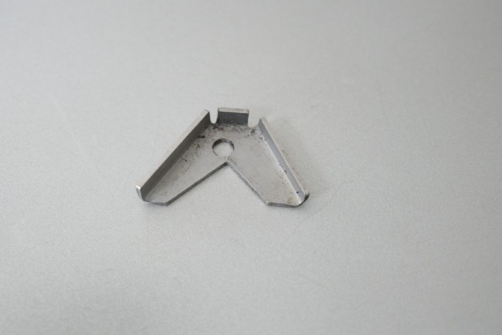

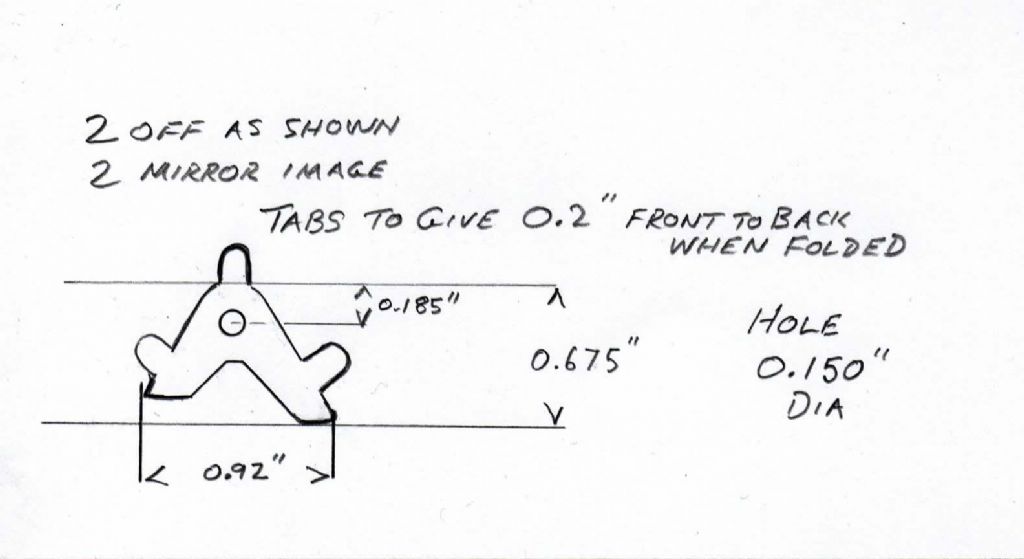

                                                #474534
                                                Grindstone Cowboy
                                                  @grindstonecowboy
                                                  For Pete – or anyone else – the wiper holders on my Boxford look like this…
                                                  Pardon my drawing skills, but you'll need 4 of them in total, two are mirror images of the one shown. The angle that fits over the V bed is, according to my protractor, slightly less than 90 degrees, which surprised me, but I don't think any of the measurements are critical. Or even the shape for that matter. The felt would be 4mm nominal thickness these days. I'm thinking of adding a bit of neoprene sheet, as well, we'll see how it goes.
                                                  Hope this helps.
                                                  Rob

                                                  #474648
                                                  Pete.
                                                    @pete-2
                                                    Mark, thanks for your suggestion on the sample felt, I might give that a try as it's free.
                                                    Ian, I've saved that shop for future reference, it does appear to be the correct stuff to use, and your idea of using neoprene to stop swarf sticking to the felt is something I will probably copy.
                                                    Thanks for the drawing cowboy, looks quite simple, I really need to get up to speed with 3d printing, there's a free filing sharing site for it, someone on yt uploaded a free file to print wiper holders, for a mini lathe, I'm sure others will be on there.
