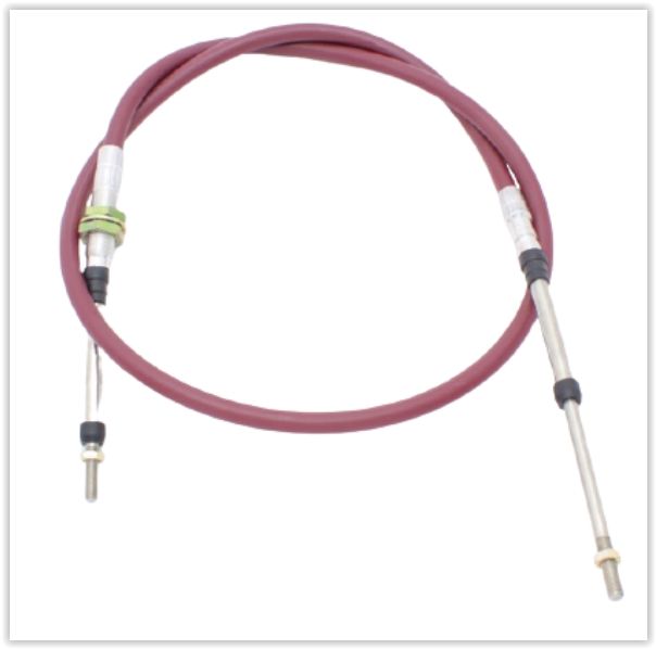

            Paul Lousick
              @paullousick59116
              An option is to use Push/Pull cables for the remote controls.
