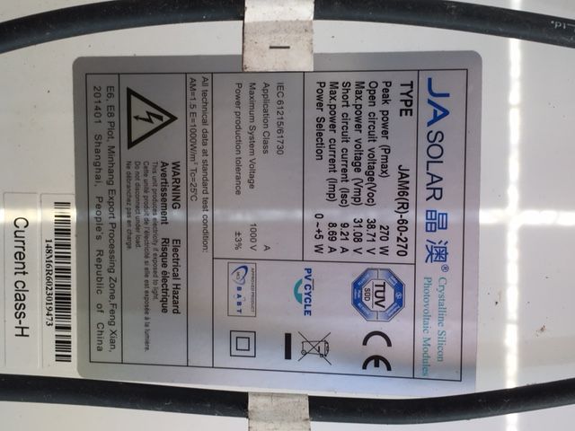

      I have 4, 270w solar panels which I have used with a dual element 24v immersion heater for a while. The panels are wired as 2 parallel pairs, I have never managed to achieve a decent loading measuring the voltage and current.
      Now one element is failing looks like its time to try something else and I wonder if anyone else has better experience?
      I also wonder if I need to get a 240v 1000w heater but use a 240v solar inverter rather than trying to match the panels to a lower voltage immersion heater?
      Peter

                                  Peter, it would help if you could give us some information on what voltage and current you actually get from the panels and what the resistance of the immersion elements is. Maybe a different connection would be better to give a better "impedance match" – such as all the panels in series with the two elements in series. Perhaps it needs to change depending on the light level with a couple of relays?

                                      Thanks for all the interesting replies. So far I havent spent much as its an ongoing experiment really rather than an investment so I'm not terribly worried on the cost.
                                      John, my panels produce 8.69a at 31v each according to the spec. I did some testing when I first got them and I'm sure they produced something like that but I need to do more. This video goes into it and the chap also has an interesting spread sheet.

                                                What is important to realise with solar panels is that they are primarily a constant current device, but with a very non-linear delivery curve.
                                                Connecting a solar panel directly to a heating element is the most inefficient way of doing this – Under bright sun conditions this is the mode that the panel will deliver its maximum current, but at very reduced panel voltage. Since Watts = Volts X Amps…
                                                Cheap solar chargers are a PWM based direct connect, ie, connect the panel to the battery till the voltage = cutoff then disconnect, so the delivered watts can only be BatVoltage X charge current.
                                                Cheap PWM convertor chargers are a 'proper' DC-DC converter, taking in panel volts and converting to battery volts ( or the voltage required by your heating element) and trying to maintain that, regardless of panel input voltage – also very inefficient – still Watts = BatVoltage X charge current
                                                DC-DC MPPT converters however make the most of the panel available Power – MPPT = Mean Power Point Tracking. The converters monitor the output voltage to make sure it maintains that voltage best it can, and does all the monitoring of output current, etc to ensure the attached battery, or element, is not over stressed. The latter functions are also 'sort off' performed by the cheap chargers mentioned above.
                                                However, the big difference is that an MPPT converter will manipulate the output voltage and current to maintain a INPUT current and INPUT voltage, such that the product of these is a maximum. If the panel in good sun can deliver 10amps, and we place a 1 ohm resistor across it, we get 10amps at 10volts from the panel. That's 100watts.
                                                That same panel will however be able to deliver 10amps at its nominal 14.5volt output as well ( assuming a 10amp '12volts' type panel – around 22-23 volts open circuit) That's 145 watts = 50% more. It cannot generate a 14.5v potential on its output with a 10ohm resistor, since the output limit is 10amps…So an MPPT charger will increase or reduce the output voltage to ensure the input watts are max, and therefore the delivered output watts are max as well. The MPPT device is also a DC-DC converter so will step up or down the panel voltage to track the optimum power point
                                                So, you should really get an MPPT element controller for a water heating element – An inverter will 'work' but suffers the same problem as the cheap PWM converter – it simply loads the panel as much as possible to get 220VAC out…
                                                If you have agents for VICTRON, contact them – they have some good solutions.

                                                    Obviously your specific needs would dictate the controller choice, but there is nothing strange about your setup – there are MPPT Heater element controller types accommodating input voltages from 48 volts ( even 36 volts, I believe) all the way up to 340volts. Not sure what your panels are – 24v/36v/48v ? Only one, suitably sized, controller would be needed, so if your panels are say 24v each, it would be more efficient and make wiring easier to series them all into a controller able to take 72V to 140V inputs.
                                                    Your idea of finding an 'optimum' load resistance value won't really help much – the load resistor value will change very little between 20-60degC, but the Solar Panel ability to deliver the energy is so dependant on the sun – slight variations, esp on the murky days, has a huge effect on volts out from the panel. So a fixed resistance value is only applicable to the level of sun when you did your test. Thats what the MPPT controller does – it is continually changing the output voltage/current, and computing the input volt/amp product, and riding that curve to get the best watts from the panel..
                                                    Your statement;
                                                    I suppose I need to experiment to find what the optimum resistive load is for the panel
                                                    is not the way to go about it…All the panel can do is under the design point irradiance is to deliver X amps – if you look at the specs sticker on the panel underside you will see the max amps that that panel can deliver – INTO A SHORT…That is how they measure max current. But Max amps into 0 ohms is 0 watts – not very useful…And the sweet point on the watts curve for most panels lies between 14v and 18v output ( again, for a nominal 12v panel) so the controller must find a point where the panel voltage stays in that range, with the max amps it can extract – which in max sun, will be close to or equal to the short circuit current.
                                                    No short cuts here I fear, if you wish to extract the best from the panels – which I need to do since on the coast here we have more than 200 days/year of mist…
