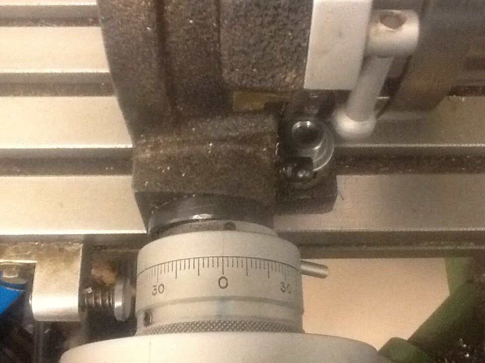

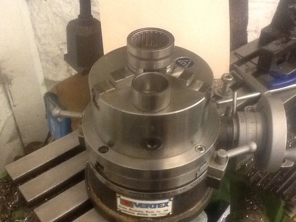

                  I bought this 150mm Vertex Rotary Table new just over 15 years ago, the TOS chuck with mounting plate that I made is fitted most of the time.
                  This older version of the Vertex table has a hardened removable sleeve in the centre that is bored 2MT. The table also rotates in a radial needle roller bearing. The original factory fitted bearing shown was a German made item. It also has a needle roller thrust bearing under the base casting.
                  The radial needle roller bearing had to be replaced a few years after purchase because the factory applied grease had dried solid and jammed up the bearing. The outer race was forced to rotate in the housing of the base casting, it still ran smoothly and was only discovered when the table was stripped for a clean and lube up.
                  image.jpg.
                  …………….. My Rotary Table hand wheel tightens or binds a little through part of every revolution. This was found to be caused by the graduated collars front face being machined slightly out of square with its bore, the mounting bracket also has the same fault. If the two faces are very close or touching it causes the intermittent binding, which feels like a more serious internal fault with the meshing gears. Back the collar off a little and the table is superbly smooth. It may be worth checking this first if you have a table that binds in a similar manner.
                  Other than those two snags it is very well made and well with the £130-£150 it cost back then.
                  Edited By Lathejack on 15/03/2019 20:23:00

                    That's the one I've got and your experience pretty much matches mine except in my case there was no hardened grease problem. It's a nice piece of kit well worth the money.

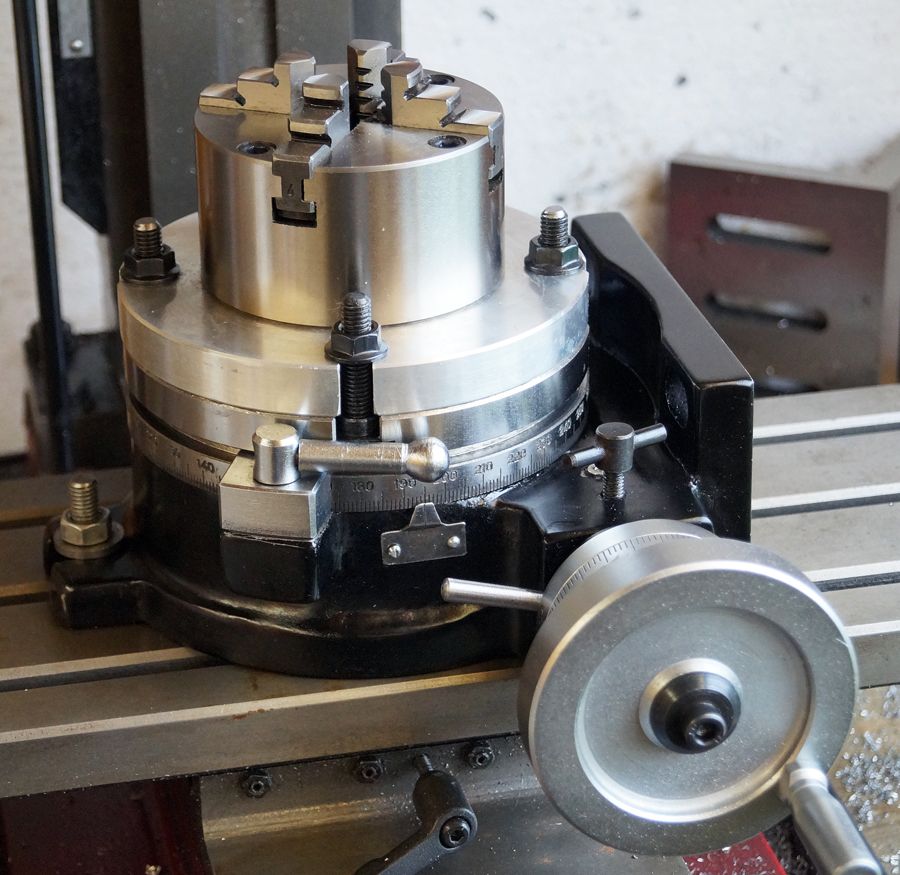

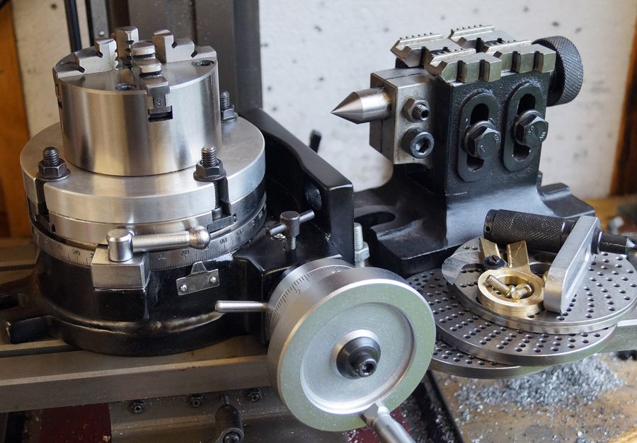

                                      The 5 inch Soba arrived so I gave it a check over whilst bearing in mind what Neil found on the 6 inch version.
                                      Turning the table through 360 the handle felt very smooth with no tight spots though it did feel a bit light so I adjusted the gear mesh which is simple to do via a grub screw. Adjusted to get a bit more feel on the handle but with no tight spots, checked the backlash at that setting which is 0.001" so I am hardly going to worry about that.
                                      I clocked the outside of the table through 360 and that is good to 0.0002", so running as near as damn it true. I then tried to find any float across the table using the mounted chuck for leverage but couldnt find any movement at all, the gauge maintained zero.
                                      One turn of the handle is 4 degrees, I checked it at a number of settings and it is spot on.
                                      So going by these checks I am obviously really pleased I couldnt ask for much better.
                                      Down side..? there always has to be a downside, the 80mm 4 jaw is self centering not an independent but I,m sure it will have its uses. Also the chuck key with the 4 jaw needs a few thou of the key faces as it hardly enters the chuck.

                                            I got it from Chronos, it comes as a set £291.60 which includes VAT and shipping. The picture below shows the set….. 5 inch table, 80mm 4 jaw with mounting plate and external jaws, tailstock assy and dividing set. It suited my budget, I was thinking of saving for a decent table in the future but with tailstock and dividers added you are looking at over £700. Also would the table be better than the Soba, I dont know but from the checks I did this morning I very much doubt it.
                                            Chronos also do another set which is as above but without the chuck and mounting plate and that is £236.80. I did ask Chronos if you can just buy the table without the extras but they said no its sold as sets. I did try finding the table only on line but couldnt find it so I assume Soba only supply it as a set.
                                            I should say that I am not trying to promote or recommend this table to anyone it just suited my budget but what I have found so far is very good and seems good value for money.

                                                  Ron, if you ever need more height under the mill with the set-up shown you could mount the chuck direct to Tee nuts in the table slots, no need for the spacer plate with 4 front fixings through the chuck.

                                                    Thanks thats a good point Emgee, I am not so bad off for height above the chuck providing the workpiece is not too tall and also with some tooling I could run out of space so losing the mounting plate would be a good idea.

                                                      Posted by Emgee on 22/03/2019 21:14:44:
                                                      … with the set-up shown you could mount the chuck direct to Tee nuts in the table slots, no need for the spacer plate with 4 front fixings through the chuck.
                                                      That is a very good point
                                                      … I now wonder why they chose to supply that adapter plate in the 'package'
                                                      [Ron] … Does it have multiple fixing points for alternative chucks, or is it dedicated to that one ?
                                                      Just curious
