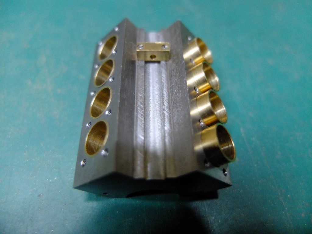

      I've just made the cylinder liners for my model V8.
      They are bored out to 7.2mm and the OD is just over 8mm for a nice friction fit in the block. I made go-no go gauges to keep the bores consistent to 0.01mm.
      I am not happy with the finish of the bores. I am looking for someway of smoothing/polishing them while maintaining the "roundness" and "parallelness" of the bores.
      I am considering turning down a bar to a whisker under bore diameter, charging with an abrasive paste and polishing it that way.
      Is that a good idea? And if so, what material for the polisher? A softer metal like ali. or harder like silver steel?
      Also, would an axial or radial motion be the way to go?
      I was thinking of Eucryl mixed with light oil (a toothpaste powder, I've used it before) followed by Autosol.
      Any advice, suggestions or guidance would be much appreciated.

                              The OP states that the builder has made go/no go gauges to size the bores to a consistency of within 0.01mm – .0004 ins. To take such care is indication that the builder requires them to remain so.
                              Whilst the simplicity of wrapping of wet and dry around a mandrel may seem rather low tech and Heath Robinson and perhaps out of keeping with the work done so far it is suggested simply because it works – to the degree of the minimal metal removal required to polish the surface without increasing the size to any extent – not much point in working to 'four tenths' if you are going to increase it to six – or more.
                              From the image the liners appear to be brass – not something that stands up to lapping well from a metal wear perspective – though very efficient, brass piston laps wear rapidly on CI pistons for instance.

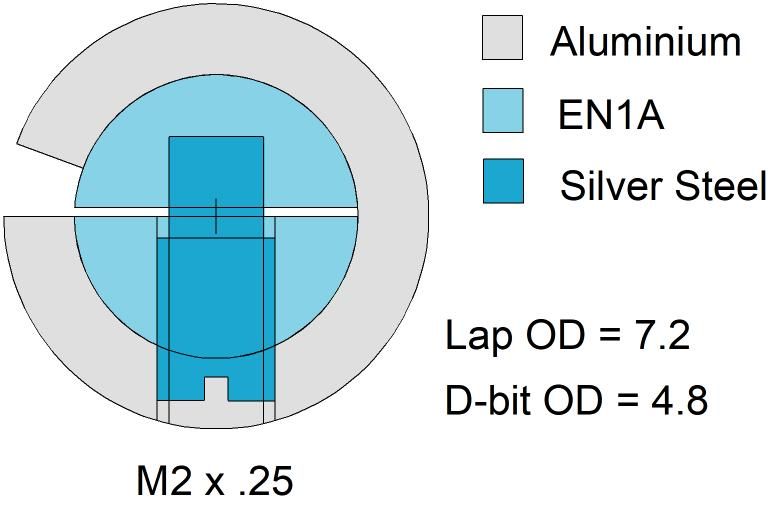

                                        A couple of questions- How wide should the paper be in relation to the bore length and should there be some axial motion as well as radial when polishing? Also, would WD40 be a suitable medium (I have no paraffin)?
                                        I've got to thinking about making hones for future projects though. Do you think this would work?
                                        The idea is that the lap is superglued to the d-bit and then drilled and tapped through both materials. The grub screw combined with the glue should secure the ali lap enough during operation. The screw is fine pitched for small adjustments.
                                        Cheers

                                            Hi Steve – yes most definitely. Nearly all the laps I have made (quite a few now) have used copper as the wrapper but the principle is the same. I've not tried cyano as such but would think a gel type cyano best as only the leading edge of the wrapper should be fixed. Make sure the leading edge to the motion is the fixed edge – otherwise it tries to unwrap it i.e. the motion wants to be away from the fixed edge. The wrapper slowly looses its concentricity in it's thickness but the outside remains perfectly circular. I'd just use a 2mm grubscrew as the expander.
                                            This type of lap expansion works extremely well and I have used them for many projects – not my idea but one that came from Len Mason in his building the Mastiff series in ME if I recall correctly
                                            With regard to the wet and dry method make the paper width wider than the length of the bore but no more than twice the length of the liner as the more that's outside on axial movement the more it can loosen and expand and begin to lead to bell mouthing as it compresses going back in – yes axial movement should be used otherwise you will create rings but not excessively so compared to the radial movement – WD 40 will be a fine alternative to paraffin – I always have the latter on hand because of the diesels.
                                            As you have a couple of spare practice first as you suggest – I'm sure you'll soon see how little action is required to achieve the surface smoothness you are after.

                                                  A quick update.
                                                  I've had a go with Ramon's mandrel and wet & dry method and it works very well.
                                                  As expected, as the liners are a tight friction/force fit in the block, the bores had "shrunk" slightly when fitted. This was soon fixed.
                                                  I started with 800 grit and worked up to 2000. I did it on the watchmakers lathe under power at about 200-300 rpm. It does remove metal quite quickly like this (the paper loaded up in no time) but it is very controllable. I was able to get all 8 bores to have the same "feel" with the plug gauge.
