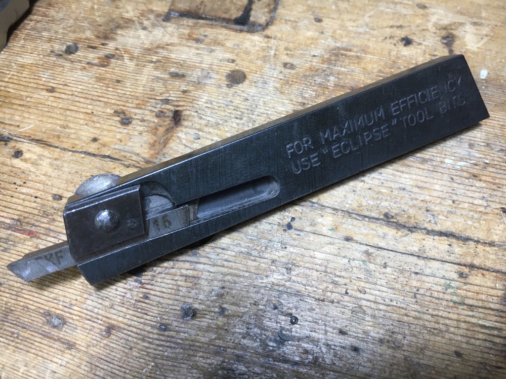

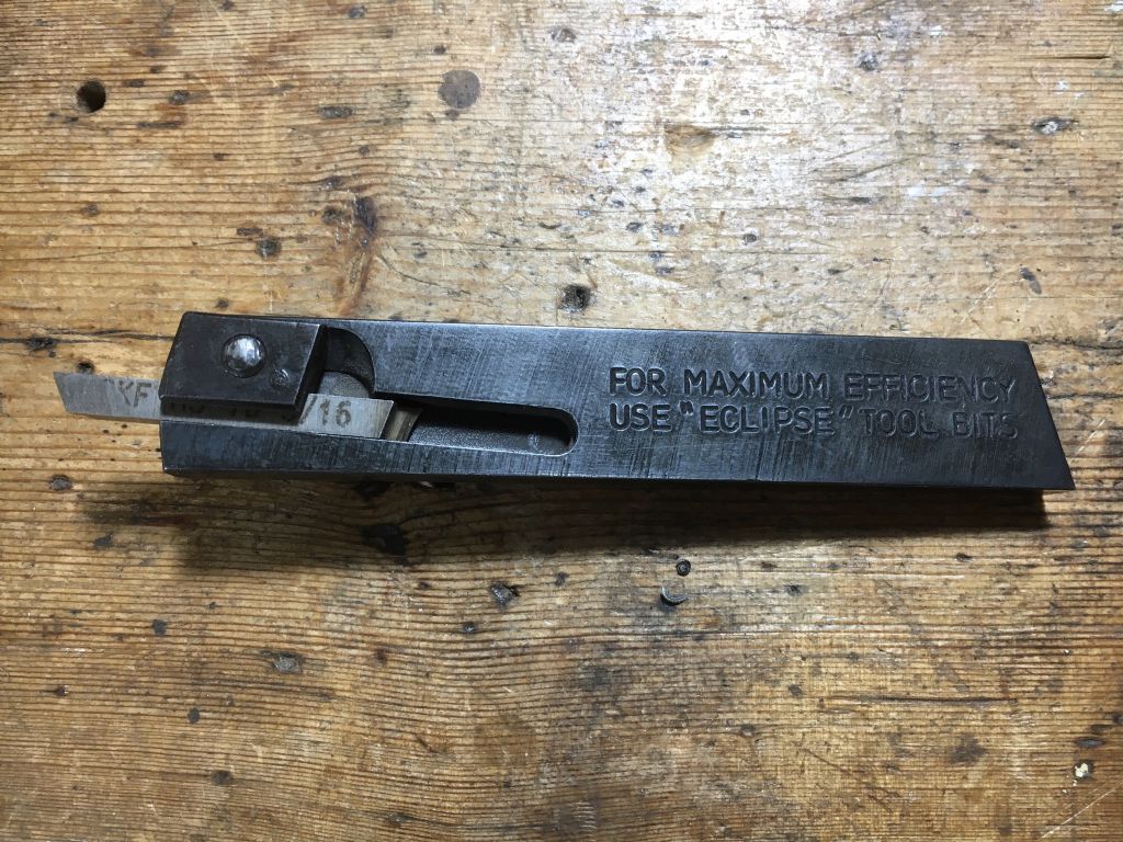

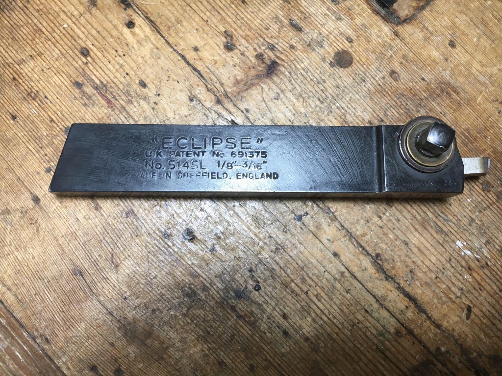

        I do a lot of work turning very small parts with very small tool bits. To facilitate this, I have an Eclipse 514SL tool holder that takes 3/16” square tool bits, holding them at a slight rake angle. This will easily be accommodated by the standard Myford tool clamp, however I'm trying to find a solution where I could leave the Myford quick change toolpost in place. At 3/4” in height, the Eclipse toolholder unfortunately doesn't fit in the Myford quick change tool post.
        Can anyone recommend an alternative to this that I can fit in the standard quick change tool post, or should I machine the Eclipse tool holder down to 12mm to fit (I realise it’s very hard tool steel), or does anyone have a plan for a shop-made tool holder that would fulfil the purpose? Alternatively, is it possible to purchase a similar toolholder that does fit in the Myford QCTP?

          Hard to see in the pic (edit: sorry …. you added pics as I was posting   ) but can you attach a block to the side of it with screws? Is it really that hard?

            That would be a great solution but I'm expecting it to be far too hard to drill.

              I've an Eclipse parting-tool holder from the same family. It's tough but drillable with ordinary drills. Lowish speed and lubricant works. I also did a bit of end milling on it, but it's hard on HSS cutters.

                  Many thanks to everyone who replied. I drilled the toolholder. Though it was hard, probably case-hardened, it drilled fairly well once centre-drilled. However, I centre-drilled the first hole too large, resulting in the edges of the twist drill breaking off. The second hole was centre-drilled not so deeply, and the drill cut through fine.
                  Once again, many thanks,
