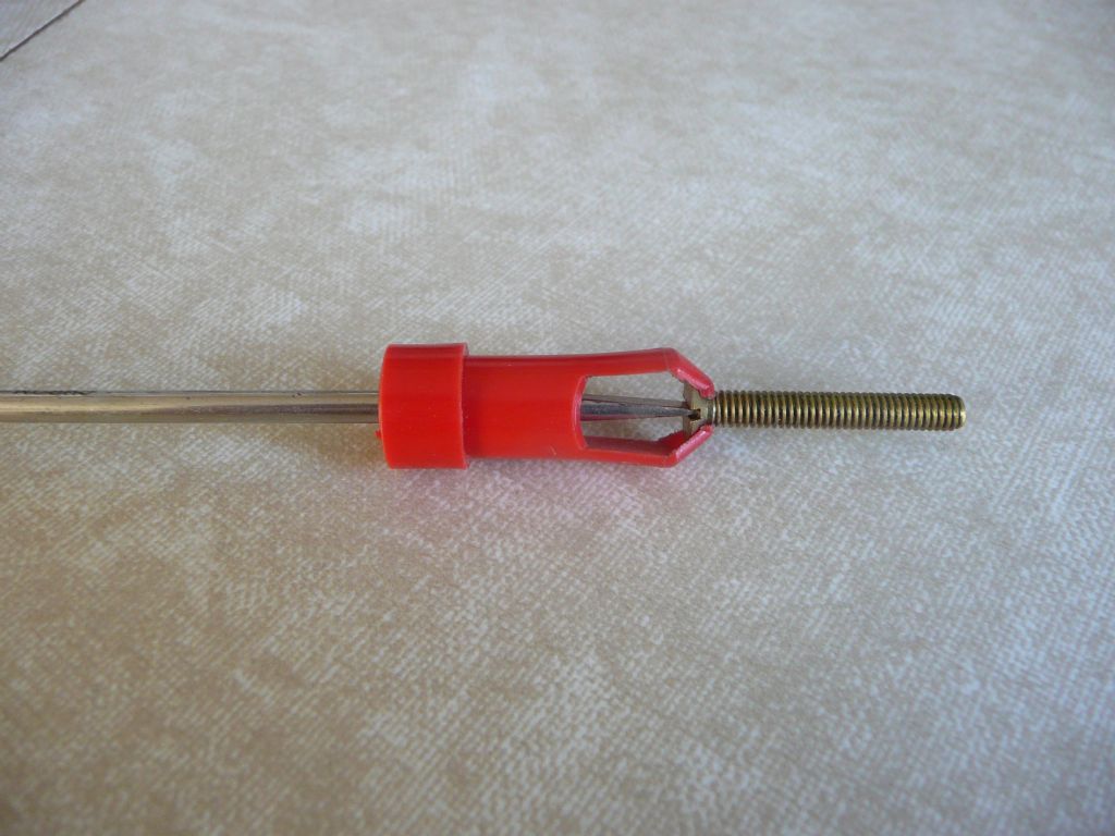

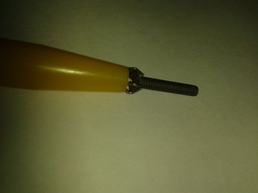

      Fingers getting fatter ? Screws getting smaller ? I have had this handy little device for some years now. Use it to grip a small screw (8 Ba etc ) to help screw it into place. I see that they are available from Radiospares 537-293 £1.30 – Other good stores may also sell them.

        Three pronged screw gripping tool

              Reminds me of this cheap little red plastic gadget:
              It's just slipped over the end of a suitable screwdriver; shown holding a 4BA screw.

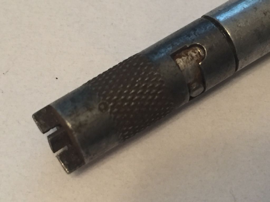

                  Both of the photos show grippers fitting outside the screw, but there is another way. My father used to have a flat blade screwdriver (I wish I had a photo, or better still the screwdriver) that gripped inside the slot.
                  The tip was divided into three parts. The two outer sections were integral with the tubular shaft, and formed a fork, similar to a security screwdriver, whilst the centre section had a straight shaft and parallel tip like an electrician's screwdriver, passing straight down the centre of the shaft. This was spring loaded to rotate about 60 degrees relative to the rest of the blade. To fit it to the screw, you simply turned a knob to align it with the rest of the blade, and when released it gripped inside the slot.

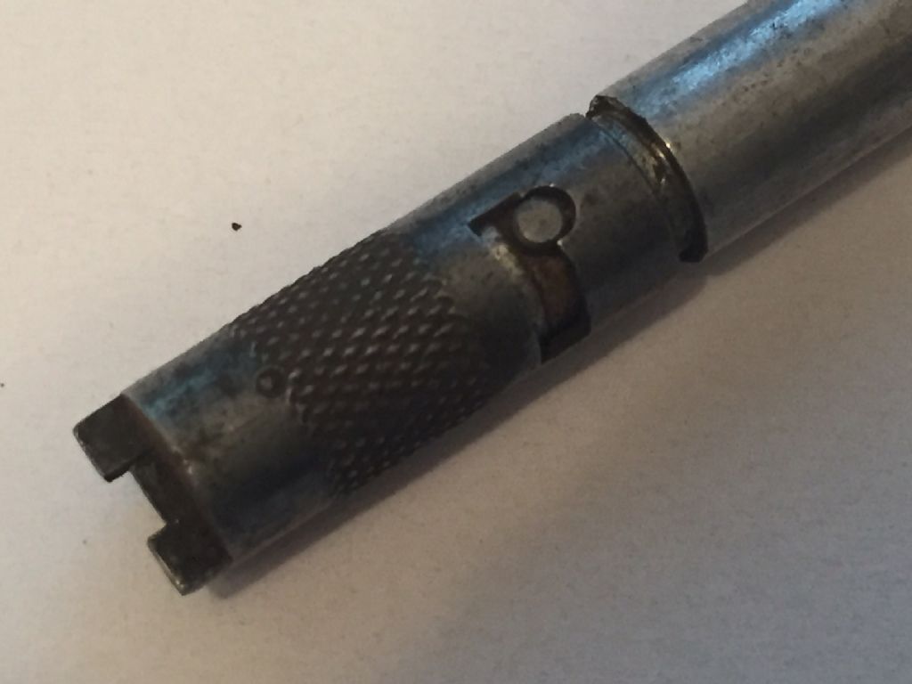

                          I have one of the tools mentioned by Brian. Made by Blue-Point (part of Snap-On), bought from Snap-On rep over 40 years ago. Part no. SSM5A. The pictures below show how the tip is constructed. In frist picture you can see the centre blade which rotates to lock the screw on the blade. When screw is tightened the end sleeve rotates and the cutout in the slot receives the little pip. I think I may have a Phillips version somewhere as well.img_1225.jpg
                          Very handy when working in awkward places on cars.
