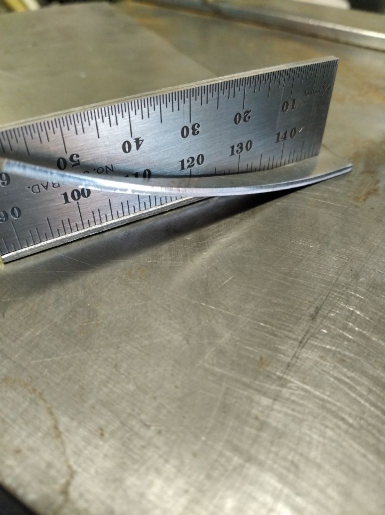

        Yes, I tried sawing with the finest saw that a jewellers could provide (32 teeth per cm) but the 0.1mm mild steel just bent. A small high speed spinning disk (c 20,000 rpm) was MUCH easier.
        Like I say, all snips always seem to bend one side. I require a deed-flat finish (a little deburring is acceptable).
        If I have to build some specialist tooling, then maybe. But I am a relative novice and it will take time, I will get it wrong and fail to including critical features etc… to yes, possibly but only after I have exhausted all other options.

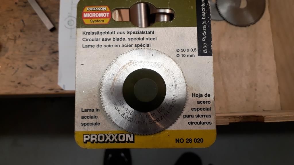

                  **LINK**
                  "The 28020 is a Tungsten tipped Saw Blade with high-alloy special steel"
                  Given that it is tipped with Tungsten, how come it can't cut mild steel? I get that it can't but I am curious to know why it can't. I was thinking that if we could slow down the RPM, and increase the torque of the motor (e.g. by having a higher wattage motor running more slowly) maybe that would help
                  Likewise I am also curious that solid carbide discs are no better.
                  Either way for thin metal sheet (e.g. 0.1mm) the easiest way to cut it and maintain flatness still seems to be a very high speed disk.

                    The blade is intended for an underpowered machine with an inadequate spindle
                    Please see Peter’s post and my response, on page 1
                    The blades could almost certainly do your job: if suitably supported and adequately powered at an appropriate speed.
                    … but Proxxon needs to inform you in the context of its machines.

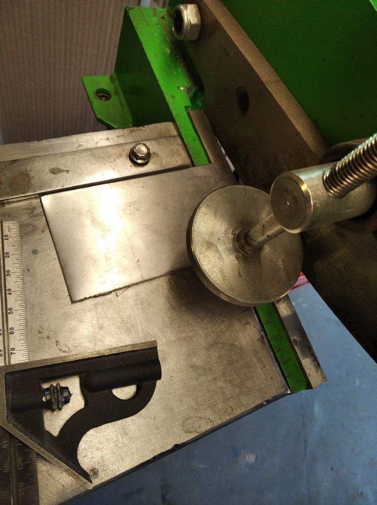

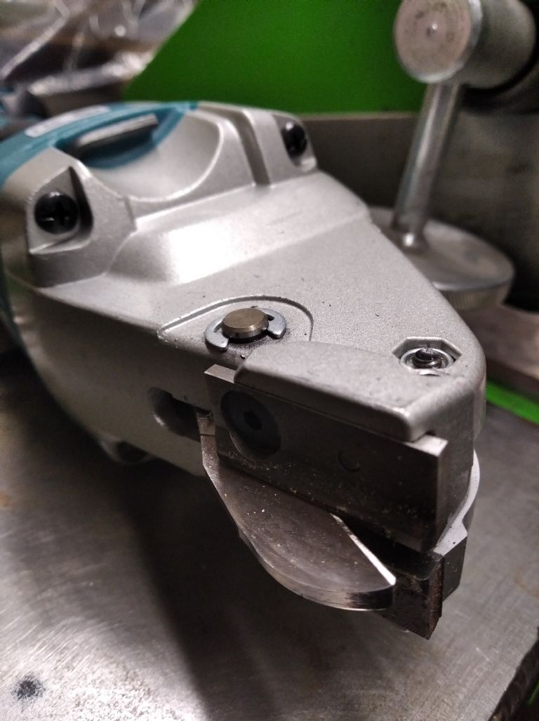

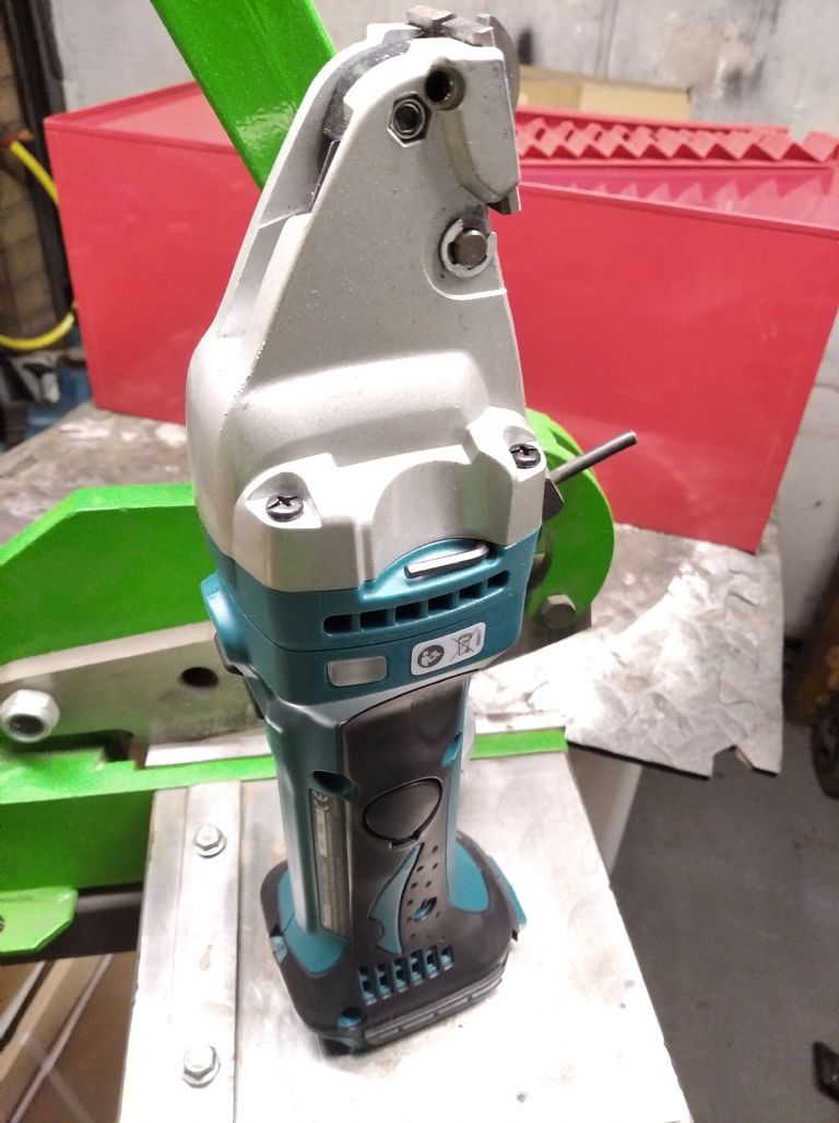

                        Posted by John Smith 47 on 21/04/2021 12:15:56:
                        @Pete – I need the metal to stay absolutely flat after it has been cut.
                        In my experience sheers never seem to achieve this.
                        Rather than endless what ifs, I thought I'd demonstrate what I said.
                        A simple table on my bench shear before I had machine tools at home, it would be made with dowels at various angles now.
                        Bench shear 1
                        Bench shear 2

                                    @Pete to get clear you are saying that even a huge guillotine puts a curve into ONE side of 1mm thick mild steel sheet, but the other side stays dead flat, yes?
                                    To my mind that is just a nightmare, because you end up will loads of bent mild steel that you cant use for anything else unless you find a way to bend if flat again. And that means huge bulky rollers as well as a high bulky guillotine.
                                    I think all my problem would be solved by:
                                    A) a small abrasion-type cutting disk that is 1mm thick, that is buried into a table in a circular saw table
                                    type of configuration.
                                    B) for slightly thicker steels, a slow turning circular saw (or band saw?) that has a very high torque should do the job.
                                    Regarding Proxxon as a brand, I find myself deeply conflicted. I have some of their stuff and in general it is reasonably good, but i) the prices are extremely high and ii) the build quality is sometimes very good but the next minute it is absolutely woeful, for no good reason. I mean certain things rattle badly that damned well shouldn't rattle at all.
                                    Bottom line: Proxxon stuff is all pretty expensive and although much of their stuff is great, but you can't RELY on the brand to be great.
                                    This make them sometimes feel like toys for amateurs even though some of their stuff IS pretty darned good. Frankly they just need a big new management shake-up and proper quality control… and a few spindles that run true and they would be absolutely brilliant.

                                          I tried with a knife on a cutting matt but what resoluted was not longer flat and got bent near the edges. The problem is that 0.1mm is quite easily bent.
                                          To get clear, I need a result that its more or less "optically flat"! i.e. It is not bent around the edges, and when I sand it down with super-fine wet & dry the sanding goes right to the edges of the cut.
                                          Fwiw, I was cutting a 10 x 5mm piece of 0.1mm mild steel. I suppose if you cut it against something that was very rigid, but not quite rigid-enough to blunten your blade – maybe a very rigid cutting mat that you don't mind damaging, then you might get away with it (??)

                                            As I said before, cut it oversize using a method that doesn't bend it, angle grinder slitting disc, Bandsaw, anyway that pleases you, personally I'd use my makita 18v sheet metal shear as it doesn't distort the sheet on either side.
                                            Then with the fence set to exactly 90° on my bench shear, trim one edge, place trimmed edge against rear fence, trim second edge, repeat, you now have a square with straight cuts and 90° corners as accurately as you set the fence.
                                            Makita shear 2
                                            Makita shear 1
