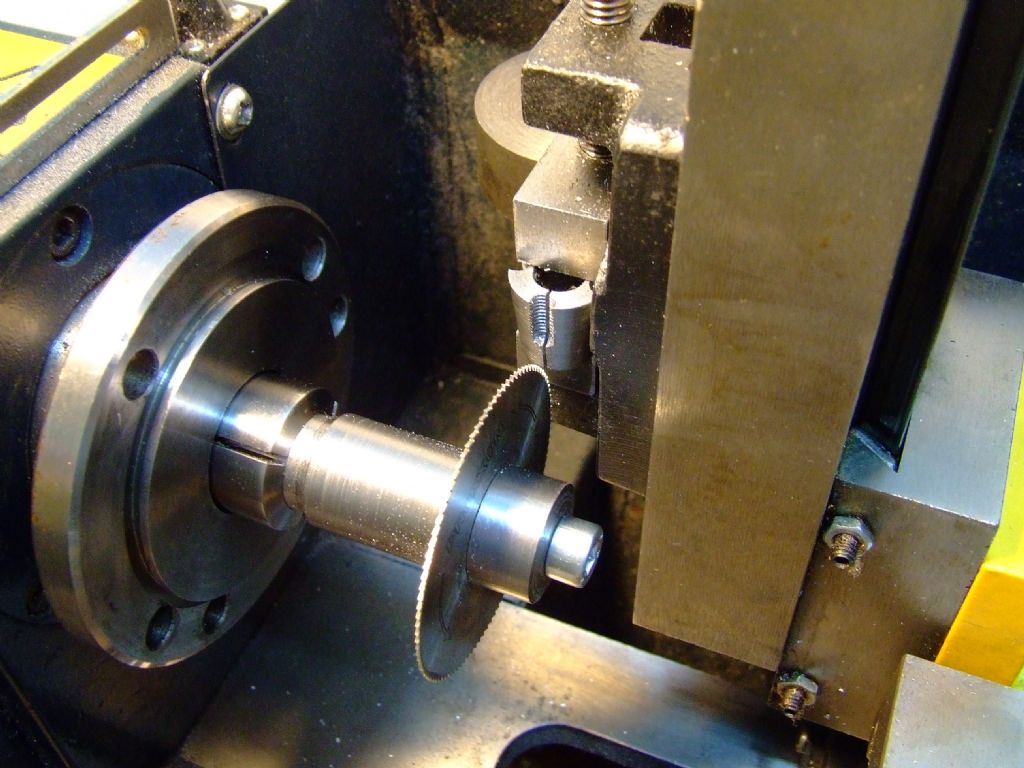

                      The 50mm Proxxon solid carbide blade 28 011 will certainly cut steel although the KS 230 may run a little fast.
                      **LINK**
                      This is one slitting a steel 'taperlock' style bush. They a quite useful as small slitting blades.

                          Posted by Roger B on 21/04/2021 07:19:35:
                          The 50mm Proxxon solid carbide blade 28 011 will certainly cut steel […]
                          That’s useful to know, Roger …
                          The description does not claim that ability, but I see that you are using it on a more appropriate spindle than that of the KS230
                          Thanks yes
