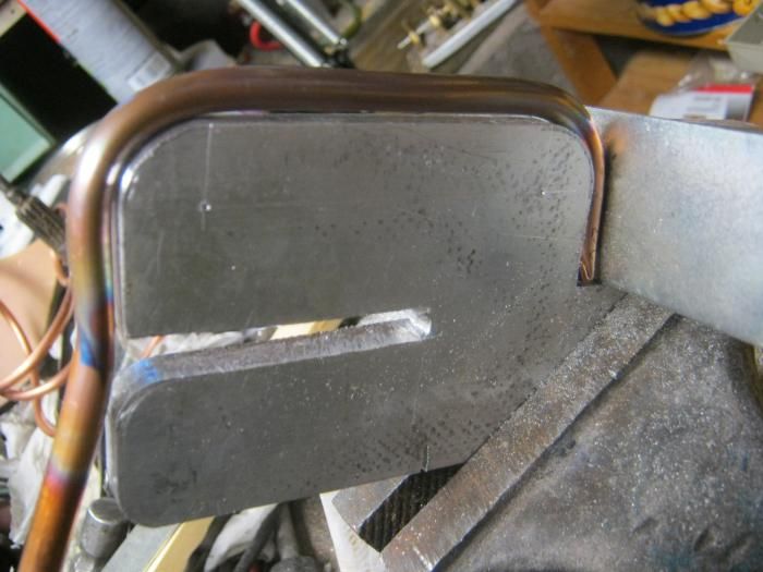

                              Geoff G
                                @geoffg
                                7. dscf5704.jpgI'm with Simon Collier – fabricate the bend. I have done it by cutting the parts at 22.5 deg, holding them in a jig (rough!) and silver soldering. The application of a little time and an assortment of files should produce a visually passable result. This method should suit any size, in any material. In view of the use of butt joints, I guess that working pressure sould be limited. A couple of pics to show the idea: p1000506.jpg

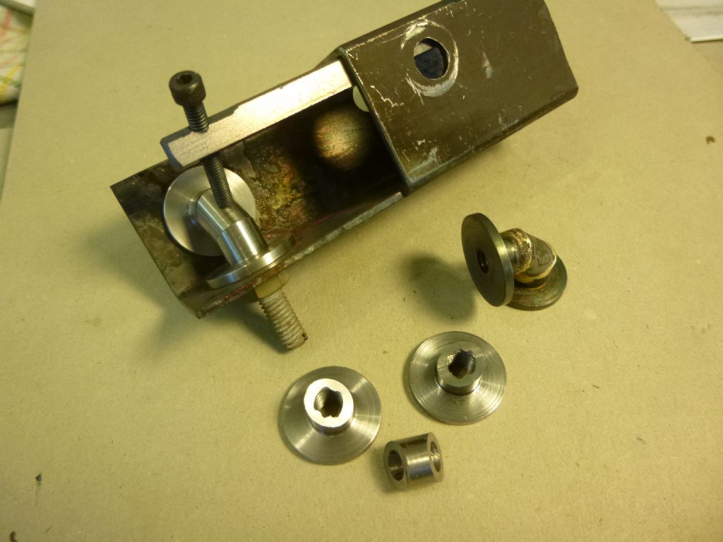

                                              #330336
                                              mechman48
                                                @mechman48
                                                I made a small tube bender that would cope with 1/8" & 1/4" copper tubing…
                                                George.

                                                  Tim Stevens
                                                    @timstevens64731
                                                    I presume that the handle and small roller assembly is spring loaded, or is it enough to keep pressure on the bigger roller manually? And the collets of various sizes are held somewhere out of sight behind the rest of the device?
                                                    And I agree with the comments that a breather does not need such a big bore (or a big tube). The main reason I suspect for adding a tube, instead of the usual hole, was to stop fuel from squirting upwards when the rider went over eg Ballaugh Bridge.
