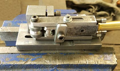

              #330678
              CHARLES lipscombe
                @charleslipscombe16059
                To Mechman48:
                I think your pipe bender could well solve my problem, and even if it does not, it is still an elegantly simple bit of gear that I would like to make for use in the future.
                Can you please post a picture of the other side of the bender? Also the purpose and fixing of the collets? Sorry if these points seem obvious but I am very much a beginner.
                Best wishes, Chas
                #330691
                mechman48
                  @mechman48
                  Posted by CHARLES lipscombe on 05/12/2017 20:54:37:
                  To Mechman48:
                  Best wishes, Chas
                  Hi Chas
                  ​ I have the drawing for this in my files … when I find them after a clean up of paperwork, will pm you with copy once sorted. The collets / rollers allow for tighter bends.
                  George.
                  Edited By mechman48 on 05/12/2017 22:50:38

                      #337236
                      CHARLES lipscombe
                        Hi, Sometime back I enquired about bending small copper tube to a tight radius. Many people helped and Mechman48 replied privately with a drawing of his design. I have now made his device and the first photo shows some experimental bends made in 1/4-inch copper tube (4 mm bore dia). These will be perfectly suited to my needs with a little more experimentation. I have applied two small mods of my own. I made the base thicker with a reduced width portion so I could clamp the tool in my vice. I thought the device was working close to its limits with 1/4-inch pipe so I made the clamping block a bit more robust.
                        A very impressive response from all the forum members who assisted and much appreciated by me.
                        Thanks George!
                        Chas Lipscombe
                        BENDSBENDER
                        #337240

                          #337259
                          Tim Stevens
                            @timstevens64731
                            I wonder whether Mechman48 could be persuaded to offer his drawings more generally? It is almost possible to work it out from the photo, though. I presume that the far block is bored to the pipe size – or has a loose collet to accommodate different sizes?
                            I do wonder about a version with a straight former (hollowed out to the relevant radius) in place of the small roller. The former would be a loose part, arranged to rest against the fixed roller, rolling round it as the handle was pulled, and would be intended to avoid the minor reverse radius kink at the end of the bend.
                            I am always nervous using my off-the-shelf version made as it is from a rough light-alloy casting. This looks a much more reliable job, and not too complex to make or adjust. Excellent
                            Cheers, Tim
