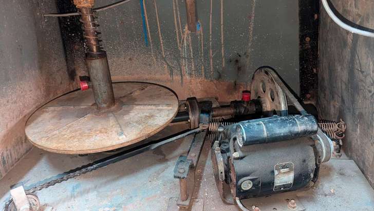

      Could you make a frame to support a countershaft above the motor? Move the motor pulley to the countershaft, and drive the countershaft using a suitably sized pair of timing pulleys and cogged belt.
      It would need a frame fabricating to carry the countershaft in a couple of bearings, but there looks to be space.

        It’s belt drive ! All this talk VFDs and new motors when all that’s needed is to change the pulleys and a belt. Since the smaller pulley is already small I would change the larger one if there is room, if not then it will have to be a smaller small one. Picador is the name to look for, HAYLEY group may be able to help. Noel.
        #743349
        Hopper
          @hopper
          +1 on what Noel said. VFD on such a crude machine would be waxing a dirt floor.
          Looks like quite a large pulley on the motor now. I would look for something half that size, or turn one up. Going to a smaller cross section Z series belt might allow even smaller.
          Or could you adapt a DC variable speed motor off a treadmill and run it on a selected set voltage for lower rpm?
          And as the original motor is just 1/3HP, it would be worth looking into cheap sewing machine motor with variable speed, even if you have to disable the rapid stop/start features.
          I reckon I would be looking at that motor pulley first though.

              Changing to a smaller section belt should allow a smaller pulley tom be fitted to the motor.
              Failing that, how abnout arranging a two stage belt drive using a countershaft?
              There appears to be plenty of room to fit a countershaft above the motor, with the secondary belt running down to the existing driven pulley.

                Someone asked about how much speed reduction; she’d like 50% or more if possible.
                (it should be noted that this is her secondary wheel; she has a fancy expensive modern one, but wants two so she can easily switch between terracota-type clays and white porcelain or white stoneware clays.)

                  50% (as in half) sounds ambitious. Can you raise the drive shaft to give room for a larger pulley? A smaller belt might also allow for a smaller motor pulley.
                  #743370
                  mrcharly
                    @mrcharly
                    Not possible to raise the drive shaft, it has to be parallel with the radius of the platen.
                    #743372
                    Adrian R2
                      @adrianr2
                      An intermediate shaft could be made to sit at the same approximate location as the motor is now. The motor could then be raised up on blocks above the intermediate shaft with a new belt arrangement to drive it, select pulley sizes to suit the preferred new speed range? You could even get a pair of stepped pulleys as per many old lathes to give std/low/lower choice.

                        Looking at the picture the reduction ratio is 5:1 ? If you want another 50% then one option would be a 10:1 wormdrive gearbox, this type of box is found in alsorts of machines, Kiddies rides that rock back and forth, a redundant one may be found at an amusement arcade at the sea side. This gives the initial reduction, it is a simple matter then to fine tune the speed by pulley ratio if need be. The input to the box could be direct or belt drive. Whilst modern ones are often italian, Croft are a British maker, beautiful ! Good Luck Noel.

                          I guess MrCharly is hoping for a cheap easy to fit answer to this problem.  The picture of the mechanism is discouraging, not because it;s complicated, but because there’s no room for simple modifications.
                          Screenshot from 2024-07-25 11-16-11
                          For example the motor is already fitted with a tiny pulley, whilst the wheel drive shaft pulley must already be as big as will fit : forget simply changing the pulleys!   Same problem at the wheel end – the leather drive wheel and clutch have to align with the drive disc.
                          A countershaft would do it, but not much room for one.  I think it would have to be bespoke, a fairly significant amount of work even if one has a junk-box full of bearing blocks and other goodies.
                          A fixed gearbox might be made to fit, but the input and output shafts have to connect the motor and wheel in alignment, unlikely to ‘just happen’.
                          Possible to speed control some types of single-phase motor, but not straightforward.  As many single-phase motors can’t be speed controlled, MrCharly might waste a lot of time and money discovering that his motor is unsuitable.
                          I think the easiest option is to replace the motor with one that has speed control.   Either a industrial sewing machine motor assembly or a 3-phase + VFD.    The sewing machine assembly isn’t plug and play because their motors spin at 4000 or 5000 rpm.    In comparison, a 3-phase motor spins at much the same speed as the existing single-phase, and a basic VFD is easy to fit.   Main complication I think is the small pulley – the existing one might not fit a new motor.   Not a problem, because pulleys to fit new motors are widely available.
                          If money is no object, buy the good lady a new potters wheel.   For a mere £3500 you get a built in seat with a 550W motor, 0-240rpm, and reverse.    More important, ‘She Who Must be Obeyed’ cannot object to MrCharly spending the same on his hobbies!!!

                            Whilst I earlier mentioned single phase VFDs, now I’ve seen the photos, I’d also agree with others that Poly V belts might be the easiest solution.
                            Pulleys down to 20mm and possibly smaller are ready available from eBay, and larger ones are available, both as plain and taper lock for the driven end.
                            When I needed some for a wire wheel/polishing gizmo, I used a pulley from a car alternator and I think one from a water pump, though in this case a larger difference in sizes would be needed.
                            This link suggests that driving pulleys down to 9mm are useable.

                              Dave, although we do not know what skills, equipment and budget MrCharly has, its hard to advise on the best approach but to me I would not describe the motor pulley as tiny, yes it is small but I think it could be half the diameter, possibly even with the same belt.
                              Highly unlikely though that there would be an off-the-shelf pulley so one would have to be made. Converting to PolyVee would involve the purchase of two pulleys (with the right bore sizes) and a belt whereas just modifying or making the motor one smaller would be a cost effective and involve the leastest engineering, although the motor to base slots might need extending.
                              Running a Vee belt over a tiny pulley is generally not good practice but this is not a precision machine and shortened belt life is not a major drama. A better compromise would be to change to an ‘A’ section belt running on the correct profile motor pulley and leave the large pulley as it is, the larger wrap will be more tolerant of the belt to sheave contact errors.

                                  I’ve been waiting for pulley to turn up.
                                  Arrived on Sat, but no time free to fit it (too many grandchildren visiting).
                                  Might manage to fit it tonight and will see how that goes (fitting time could be 5min, or several hours, depending on how long it takes me to get old pulley off; it has been operating for many decades in a damp, dirty environment).
                                  Should reduce the speed by a third.

                                                      I fitted the new pulley last night. Only a bit of percussive maintenance required to get old pulley off.
                                                      The pulley sizes have changed from 67mm to 43mm, so about a drop of speed to 2/3rds the original.
                                                      The potter hasn’t checked it yet.
                                                      As some people have suspected, steady speed under varying load is absolutely key.
                                                      If this speed reduction isn’t sufficient, I suspect I’ll go down the route of adding a third pulley. Although that would involve messing with brackets etc, it would be easier than changing motor and controllers; it is difficult to create a dry clean enclosure inside the wheel.
