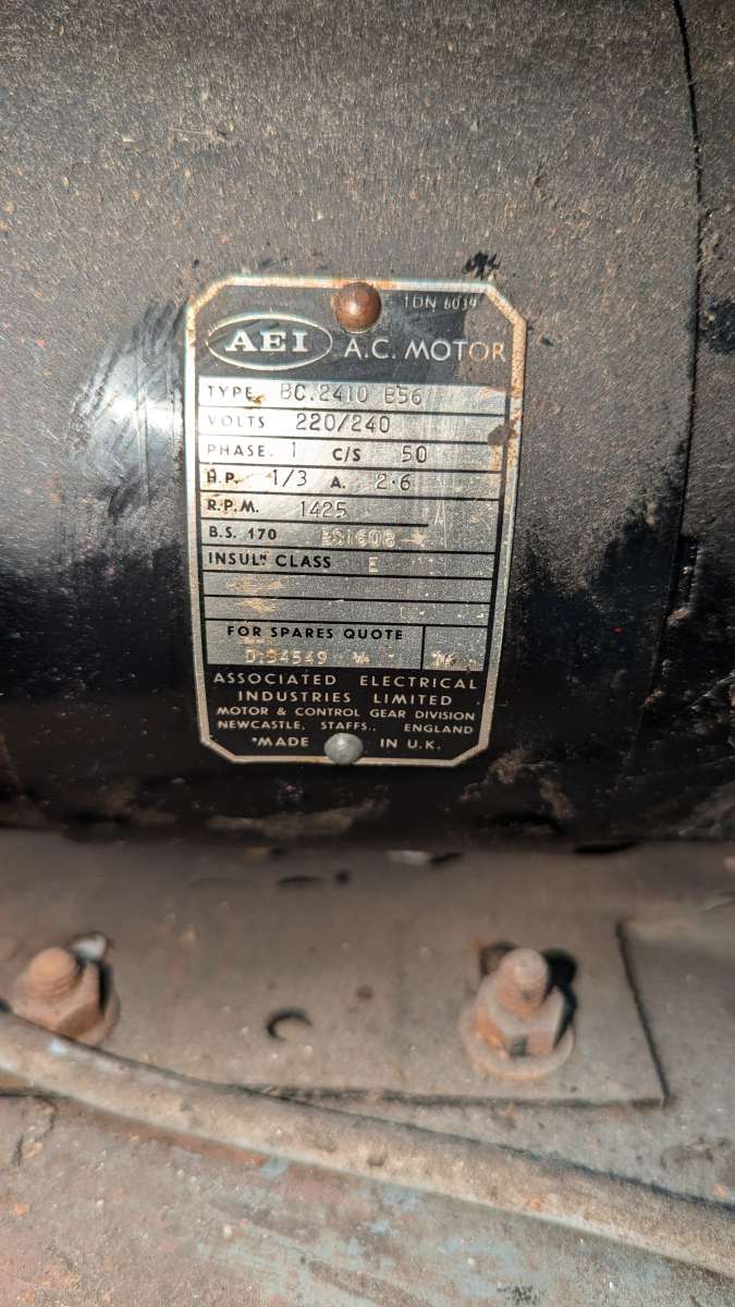

      My wife has an old potter’s wheel driven by a AEI BC 2410 B56 motor.
      She wants to run it at a slower speed. I’ve investigated the drivetrain, and can’t easily change the speed by altering ratios of anything (mostly because of casing limitations).
      A friend suggested a VFD, but I’m struggling to find something suitable.
      As far as I can tell, this is a single phase induction motor.
      Can someone with experience of something similar help here, please?

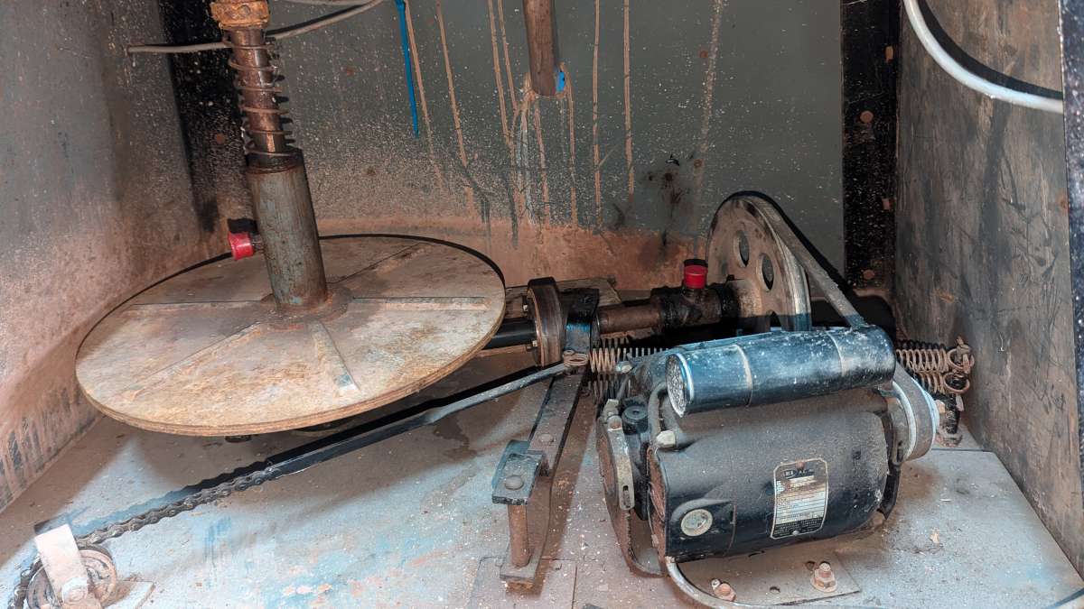

                    mrcharly
                      @mrcharly
                      It is definitely single phase – we don’t have a 3 phase supply.
                      I’ll try to get photographs of the motor.
                      This is a very old wheel, no foot pedal control. Speed control is by radially pushing a leather wheel radially across a platen.

                                      On mrcharly Said:
                                      […]  Speed control is by radially pushing a leather wheel radially across a platen.
                                      I eagerly await sight of the photographs, but that sounds rather like this mechanism:
                                      https://patentimages.storage.googleapis.com/7c/f6/91/c26fc1f060e9a1/US2902741.pdf
                                      #743276
                                      mrcharly
                                        @mrcharly
                                        On Michael Gilligan Said:
                                        Yes, that is the mechanism.
                                        The leather wheel is pushed along the drive shaft by a ‘fork’. And therein lies the complication. The leather wheel is bolted to a steel flange that has a notch (which engages on the drive shaft). It isn’t possible to have a wheel smaller than this flange.
                                        The alternative approach would be to change the belt-drive wheels – but these are already about as large/small as will fit.
                                        Hence looking for a way to slow the motor. I will try to get some photos today (this is awkward, as The Potter has a 3 day exhibition coming up and gets very snappy if a grease monkey starts unbolting things in the studio).
                                        #743301
                                        mrcharly
                                          @mrcharly
                                          PXL_20240724_163251033PXL_20240724_163139963
                                          #743303
                                            Excellent, thanks
                                            … I am quite sure that a simple motor swap [to 3-phase with VFD] will work wonders.
                                            Edit: __ some useful drawings of modern frame-sizes here:
                                            https://www.electric-motors.online/products/motors/b56-motors/
                                            #743310
                                            Ian P
                                              @ianp
                                              Whilst a three phase motor and a VFD would transform the machine (make it smoother, quieter and have a greater speed range) it is a bit of an overkill and its installation is not completely straightforward.
                                              There looks to be acres of room to mount the VFD in the cabinet but, it would need protecting from water splashes and drips. Ideally too one should have the cabinet door lockable or at least need a tool to open (screwdriver) to prevent access whilst connected to the mains.
                                              You do not say how much slower your wife wants the machine to run at and whether if (for example) it is half the current speed, then it would also halve the top speed. With a VFD set to 10Hz the motor will run at one fifth of is normal speed. A VFD will act like a gearbox leaving the foot pedal for the potter to use as normal.
                                              Having said all that the simplest option might be to just have a much smaller pulley on the existing motor leaving the large one as it is. It might be below the specified bend radius for the belt but if it works will just shorten the belt life.
                                              What you end up doing may depend on whether you have mechanical or electrical skills. Knowing just a little about the wet and messy environment below the wheel I would favour a mechanical solution.
                                              Ian P
