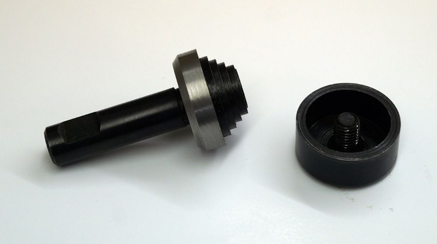

                This came with the lathe tooling, quite a neat idea with stepped mounts for different size blades and they are sprung so as you fit the cap they push back, you wouldnt think there is enough space for them to push back but they do until the blade meets the shoulder. Dont know where it came from as there is no name on it, I had my doubts as to how well it would work and hold the blade but a quick try with a 1.5mm blade and it worked a treat.
                #418458
                  Posted by Ron Laden on 12/07/2019 08:01:57:
                  Looks like the gods are smiling on you Ron! My guess is you've bought a lathe and tooling from someone who bought carefully and knew what he was doing. I own a similar slitting saw holder and it's a shade too wobbly for comfort. Works OK but it's slack enough to irritate me, which is why I made a few solid versions. You seem to have a better made holder of the multiple type. Using it in anger will confirm, but it looks good to me.
