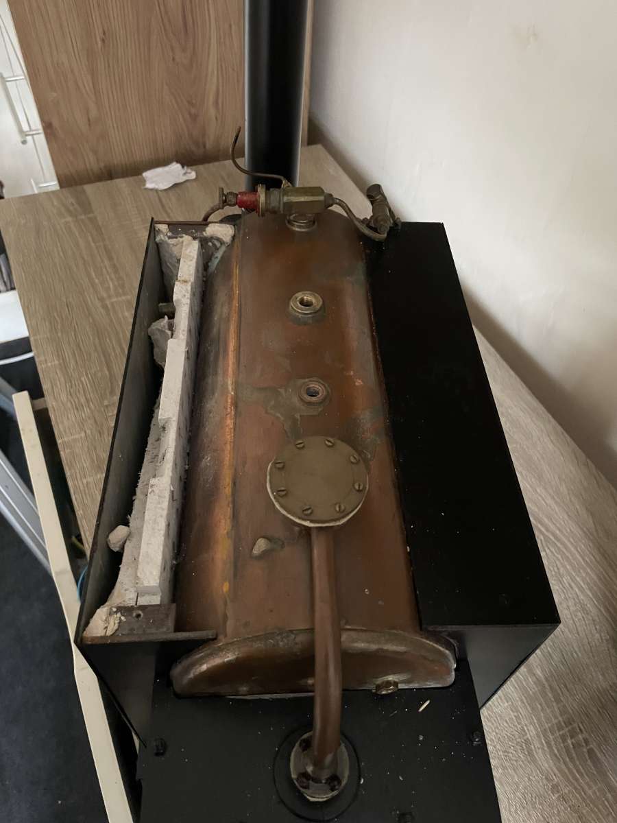

      Hi,
      I have the opportunity to purchase a scotch boiler for a steam plant I’m building, boiler looks ok, fairly old but un-steamed,  but I notice on paperwork, the hydraulic test was four hours in duration at 2x working pressure, which does sound excessive,, and putting a lot of strain on boiler which does concern me, although it did pass
      I was hoping someone could put my mind at rest and advise me to go ahead with purchasing, or should I steer clear!
      look forward to your replies
      mark

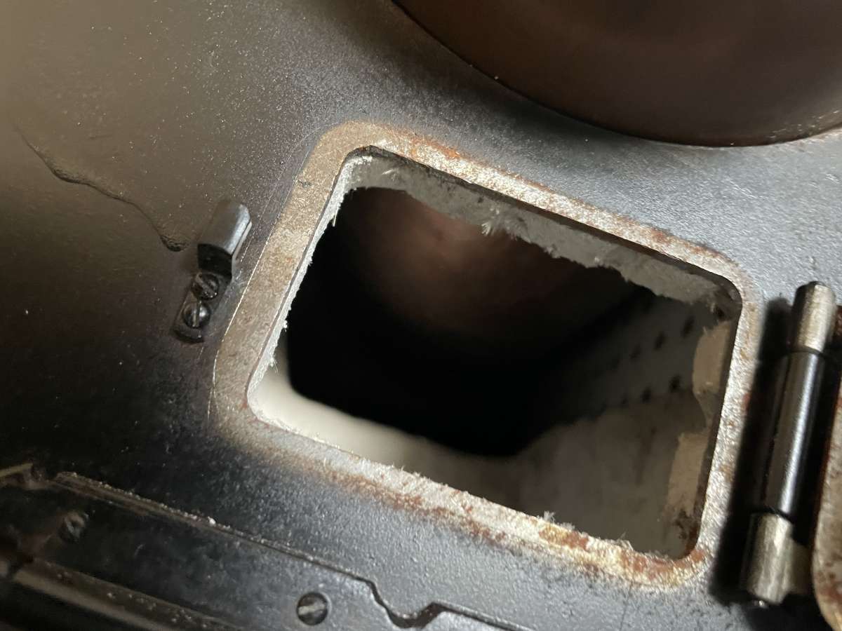

                      Thanks guy’ for your replies, now I have some better understanding of procedure. There is also some asbestos lining the firebox, with refractory cement covering the walls, obviously the asbestos will have to be removed and replaced with a safer material. I shall endeavour to find a boiler inspector, to give it the once over, that’s if I decide to go ahead with purchase.

                              If I were faced with the asbestos I’d immerse it in a big bucket of water and keep it under. Then the fibres can’t become airborne

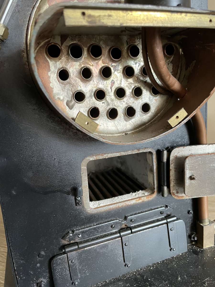

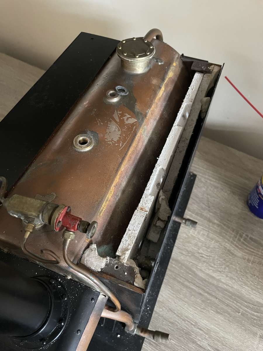

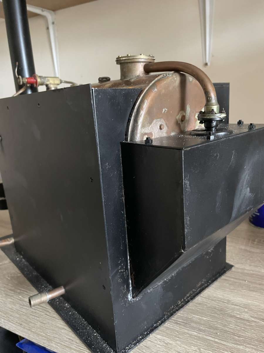

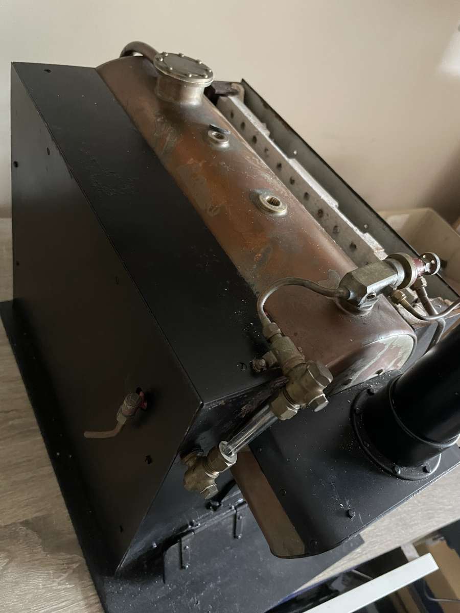

                                            We do have an indication of size one of the photographs shows it is of about one hand diameter by four long! So 4 – 5 inches diameter by 12 long, approximately.
                                            Asbestos is recogniseable partly by tiny, sharp, needle-like fibres and it is those that cause the problems if breathed in. So is glass-fibre but the needles are uniform cylinders.
                                            Left alone, and covered, it is unlikely to be a problem but if removed it should be done wet, then carefully wrapped to seal it.

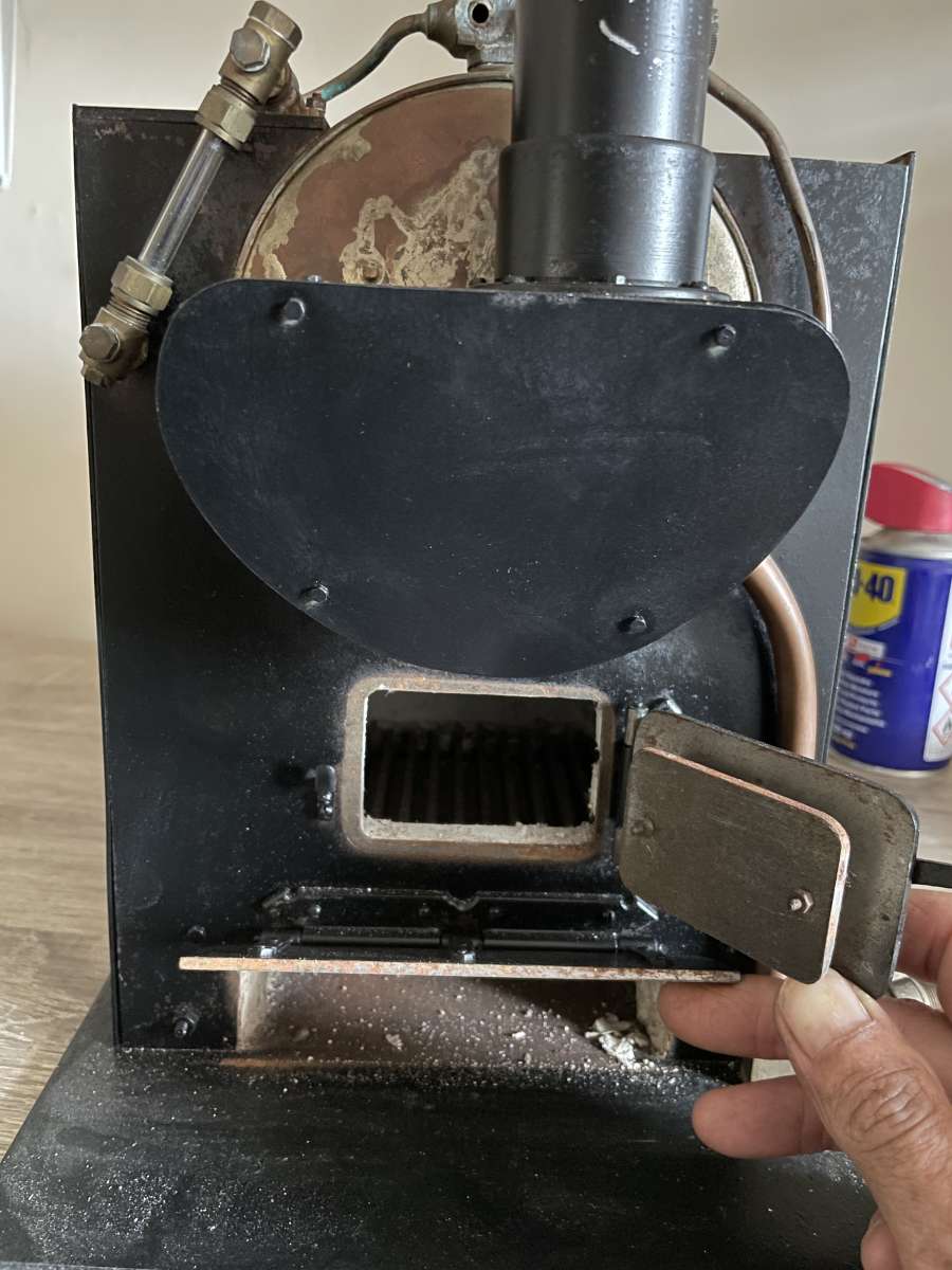

                                            The boiler looks like a sort of hybrid between locomotive and Scotch marine types. In the latter, an internal combustion-chamber acts as return-bend on the end of the fire-box (called a “furnace” on these forms of boiler) with a flue or tubes back to the smokebox and flue above the fire-hole.
                                            On this, the combustion-chamber appears to be external: the large black box on the end of the shell. This also seems to hold a superheater.
                                            “The paperwork”. By whom? Is the boiler commercially or privately built? Either way the 2X wp hydraulic test would be right for the initial shell-test; but not repeat tests. (Use 1.5X w.p. for typically 20 minutes, for those, and at every 4 years for a copper boiler.).
                                            Has the boiler been steamed since then? The one, dark image of the firebox interior suggests not, or only lightly, but it may have used oil or gas rather than coal, despite the grate and ashpan.
                                            Commercial builders might be able to test their own products but must do so in the proper way and traceably. A private builder intending to steam the boiler in public would need it to be in current test – depending where you are that can be done by a model-engineering society but you would need be a member.
                                            If you want to operate it purely privately (and exhibit it only statically) you do not need have it tested and certified as safe; but in that case for your own peace of mind test it yourself to the normal MELG scheme I have quoted from, above.
                                            I should add, also an annual “steam accumulation test” to ensure the correct working of the pressure-gauge, safety-valves and water-feeds.
                                            Much of the silver-brazing visible looks good, but a boiler-inspector may well want all the superstructure removing to inspect it properly on first investigation.
                                            One aspect of the design that worries me a bit is that apart from the superheater necessarily enclosed, some of the boiler fittings are hidden by casings that do not look very readily removeable. That is not itself a boiler-testing matter but is not good practice as the joints can develop leaks so would need attention.
                                            Connections leaking in a hydraulic test prevent maintaining a steady pressure; and you need be able to identify what is happening to be able to account for the pressure-drop. Those side superstructures would hinder such inspection.
                                            In the end, buying a second-hand boiler of poorly-known provenance is always a gamble – though that is true of any second-hand machine.

                                              many thanks for the very informative reply. The boiler was built privately, and test by a civil engineer when first tested, and its only written down in type, explaining pressure and time of test ect.yes the combustion chamber is external right under barrel, travelling along bottom of boiler to rear then up to rear tubes and back through boiler to chimney, which means the insulation on side of boiler has to fairly airtight, as otherwise smoke /gas will be emitted along boiler side tops. The boiler has never been steamed since built, so once all corrective work completed and 1.5 hydraulic test carried out by me, I intend to steam it. But first it needs stripping down and check on thoses hidden fittings that are impossible to get to as it standsIMG_1780

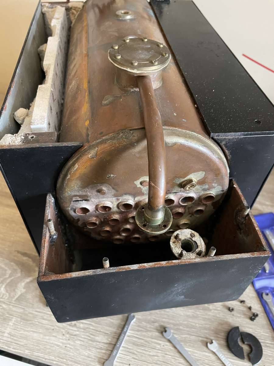

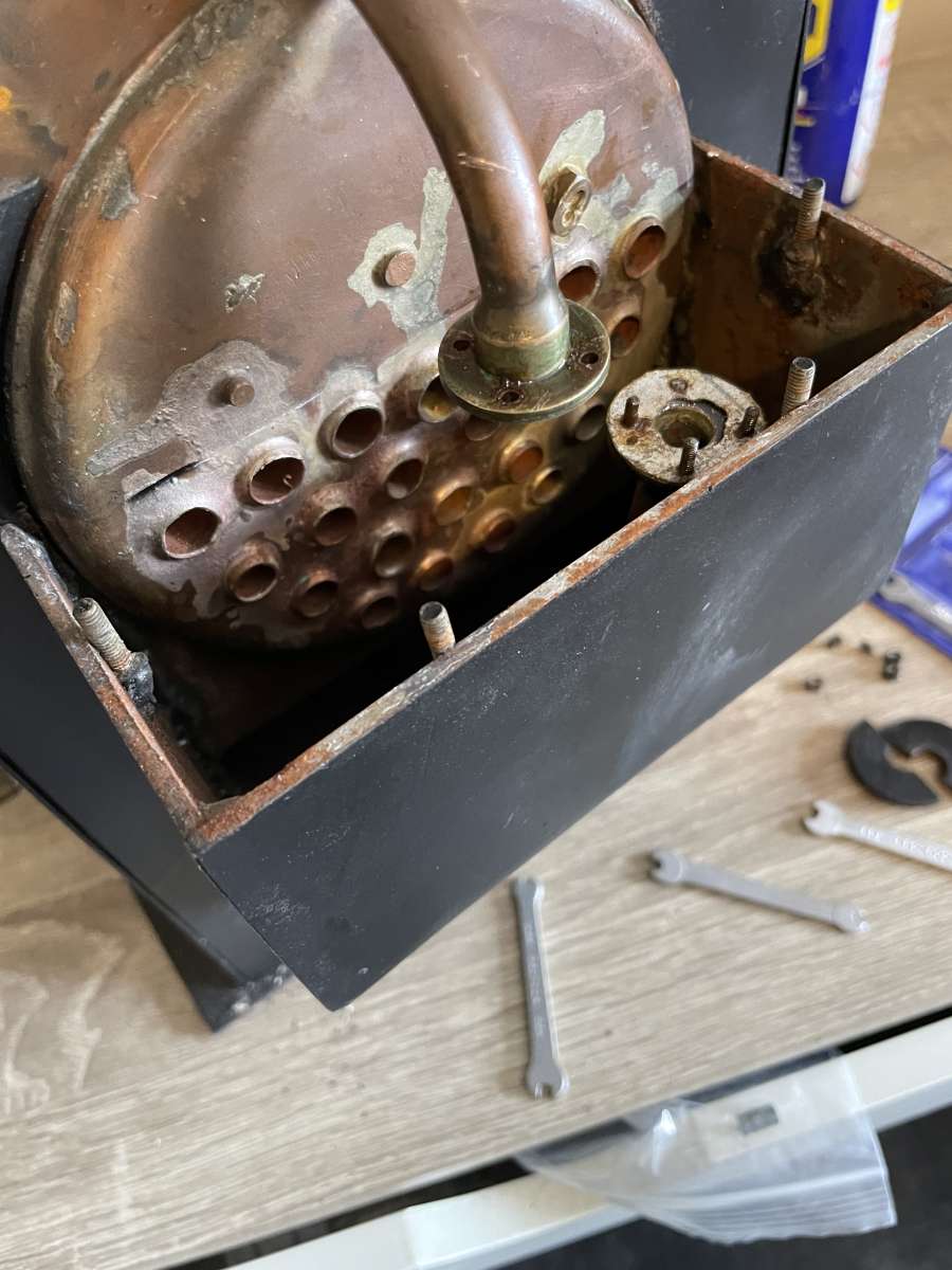

                                                Rear boiler tubesIMG_1782IMG_1781
                                                #811311
                                                  Any markings?  Looks manufactured rather than home-made to me, and representative, not a model.   My guess is it’s educational,  used to demonstrate steam engines in a technical school or college when coal and steam were still big on the curriculum.
                                                  The boxy style, black paint, and likely Asbestos suggests post-war rather than pre-war, and made before Asbestos was accepted by vested interests as dangerous.  Apart from being much bigger, oil-fired and painted green my school’s central heating boiler had the same look, and it was installed in the early sixties.
                                                  #811317
                                                    To me it is just a stationary type horizontal return flue boiler that would likely be found providing steam for a model steam plant, possibly commercially made but certainly aimed at model use.
                                                    Plenty of similar designs about, Harris has one in his book so may well have been built by a hobbiest based on his or other designs. The last two photos are the pipe that connects to the superheater that is loose below.
                                                    #811319
                                                    endckr111
                                                      @endckr111
                                                      Hi, it was made pre 89, and definitely made by a model engineer, no markings on boiler maybe when I remove the casing something might show up, which will make it slit lighter, currently weighing in at 14 kilos my intensional is to coal fire it, and to power one or two engines, setup as a steam plant.so is  Vermiculite sheet an alternative for inside firebox and boiler sides? Your comments and advise much appreciated
