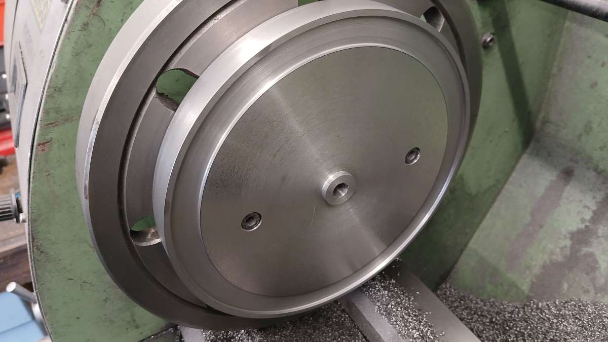

      A slice of 190dia cast iron bar was ordered from M0-machine along with some other materials that I wanted and today I made a start roughing it out. I had ordered a 25mm long piece but it was closer to 29mm so a fair bit of searf to get it down to 23mm overall thickness then 18mm at the rim. Two 6mm holes were counterbored from both sides so I could screw it into some previously tapped holes in my faceplate.
      20250724_134934
      I took a light skim off the first side then with that against the faceplate took some heavier cuts to start bringing the thickness down. 300rpm, 1.25mm depth of cut with a CCGT060202 “spare corner”
      20250724_141706
      Not too bad a roughing cut

          I got the remaining turning work done which consisted of reducing the thickness to leave a small spigot which will become the wider hub. I also cut the recess in each sid eof the flywheel rim, this was done with a combination of round ended brazed carbide tool, boring bar with 060208 insert and a left hand tool with a similar insert.
