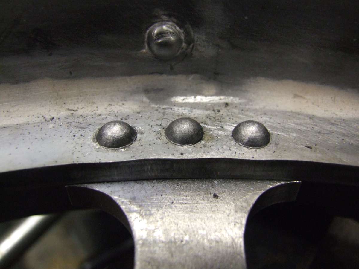

        Julie Ann
          @julieann
          You may be lucky and find a secondhand bolster, but tooling will almost certainly have to be home made. However, a flypress has it’s uses. For instance closing 3/16″ steel rivets:
          2018_04080003

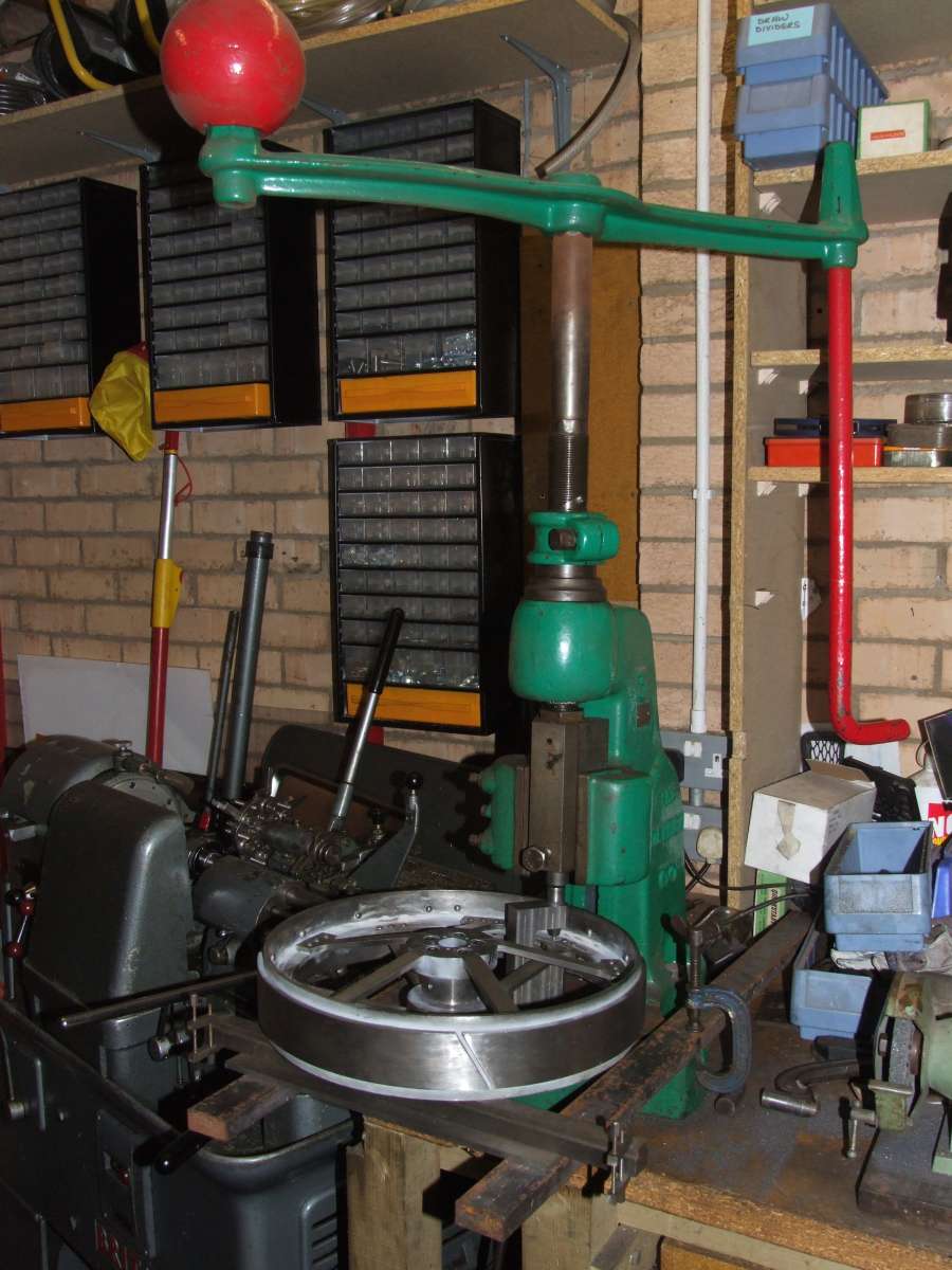

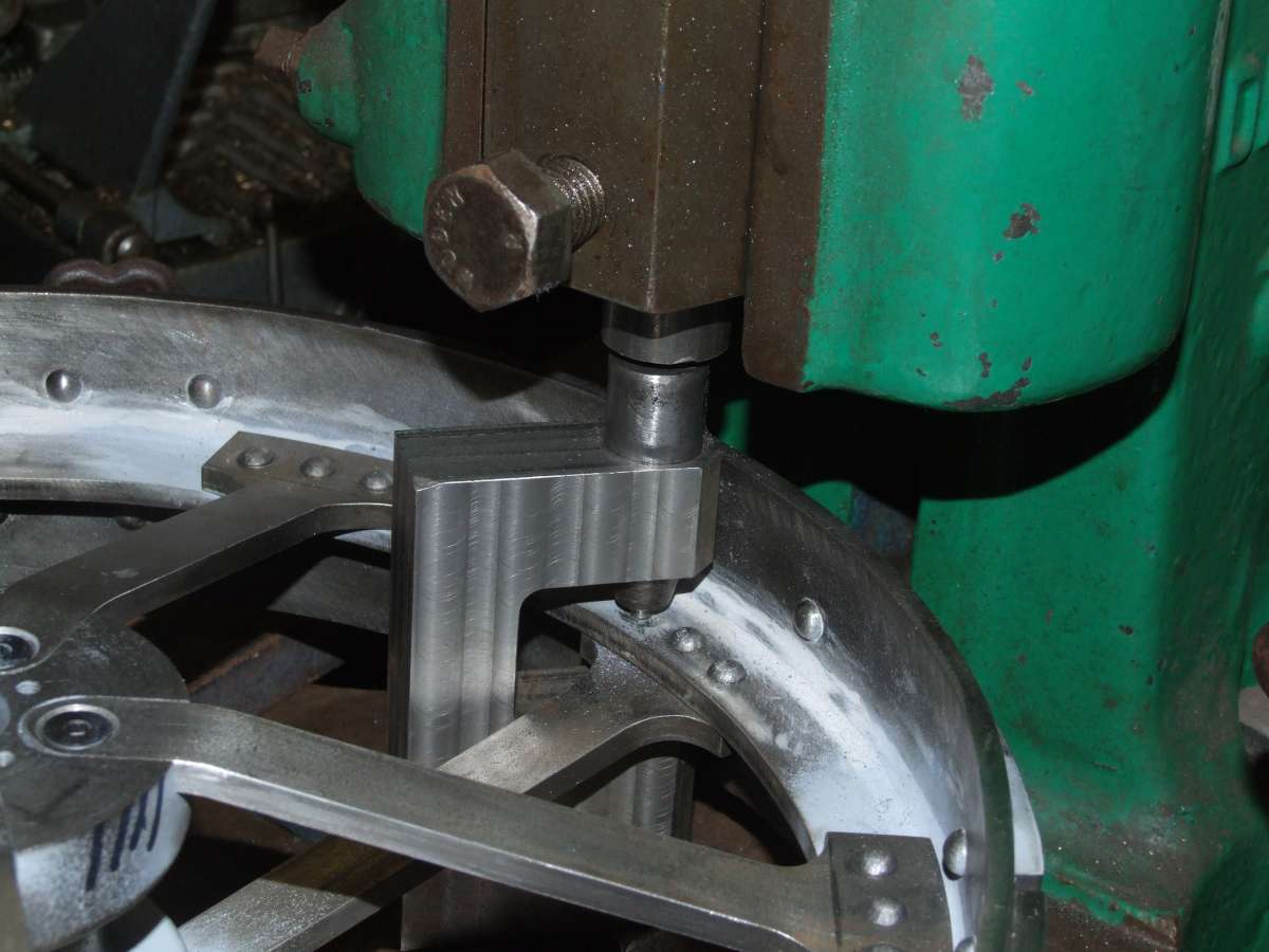

          Home made riveting dollies:
          2018_04080008
          Formed rivet heads:
          2018_04080010

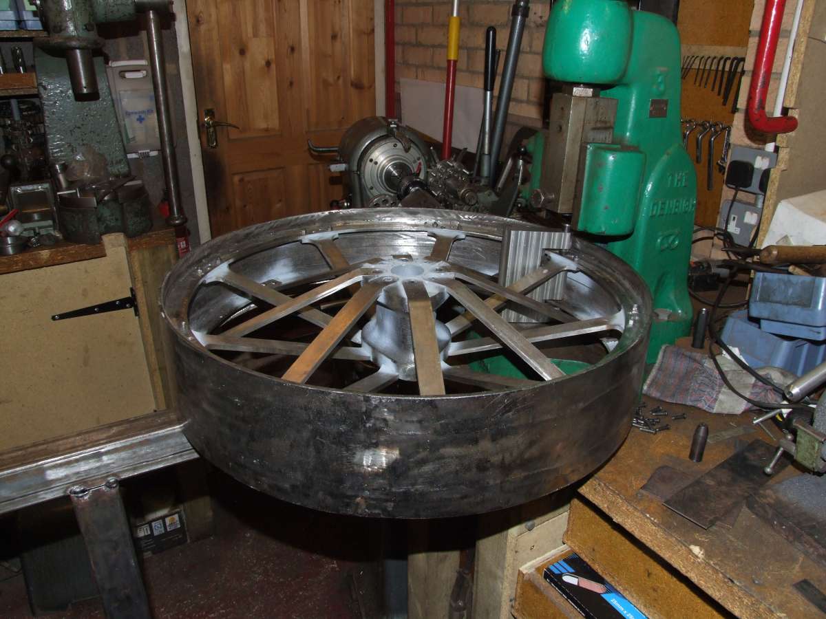

          Bigger wheels, same size rivets and more home made rivet dollies:
          2018_06120003

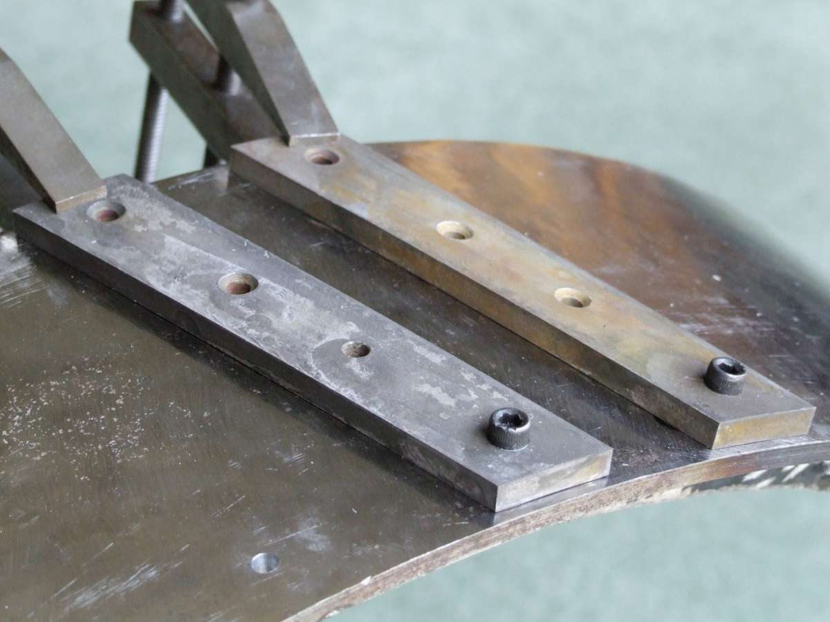

          Home made press tools (CNC milled) for hot forming rear wheel strakes:
          2019_04130002
          Formed strakes are a good fit on the rear wheel rim:
          2019_04170009
          I’ve also used my flypress for experimenting with 3D printed press tooling, which sort of worked. For work I have made tooling in gauge plate for stamping out custom slots in brass sheet to hold clip-in connectors. The flypress can also be used to hold the rivet dolly for awkward riveting:
          2024_08110003
          My flypress is #3, what size are you looking at? To summarise I’d say go for a flypress!

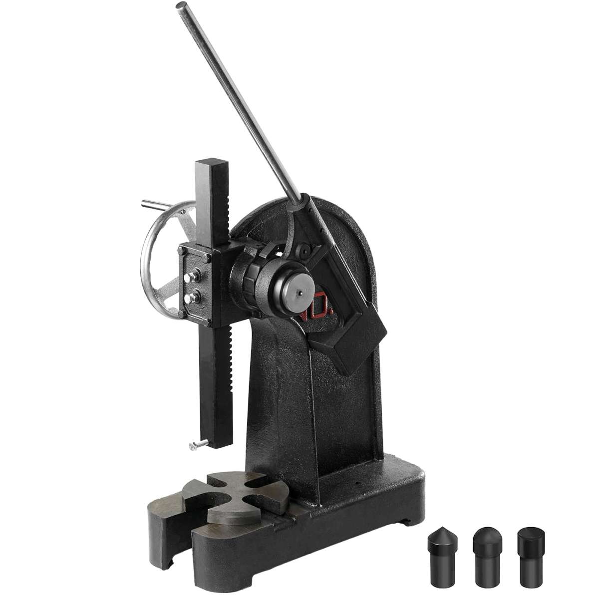

            I’ve had two different ones at various times. I rarely found a use for them and sold them on. Even though both were quite small they take up a lot of room to operate. Many years ago I had a job where I had to use a somewhat larger one and you had to give it a really good swing to get it to work well. If I found I really needed a small manual press then I’d probably buy  Ratchet Arbour Press, something like this:
            IMG_5020

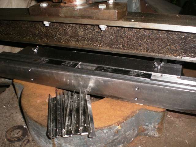

                    You tend to get more throat space to work with on a fly press rather than a hydraulic press but you do need a very stable bench. One of the big ones I used in the past was on a welded steel frame and you had to bar it back in position every so often as it used to walk about.
                    One distinct advantage is settable depth using the collar.
                    If you want to get really fancy press tool holders are available for very little money. This was eBay at £50
                    Obviously you have to create your own punch/die sets but they ensure alignment which you don’t get from the press itself. It’s OK if you just want to squeeze rivets or form a bend but any sort of punch or shear needs to be better controlled than you can expect from the press itself.
                    IMG_1083
