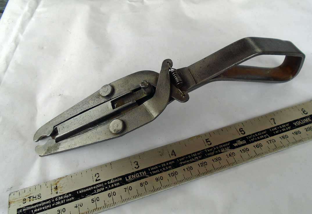

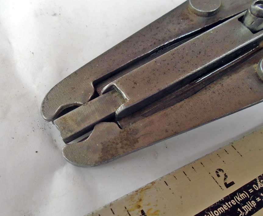

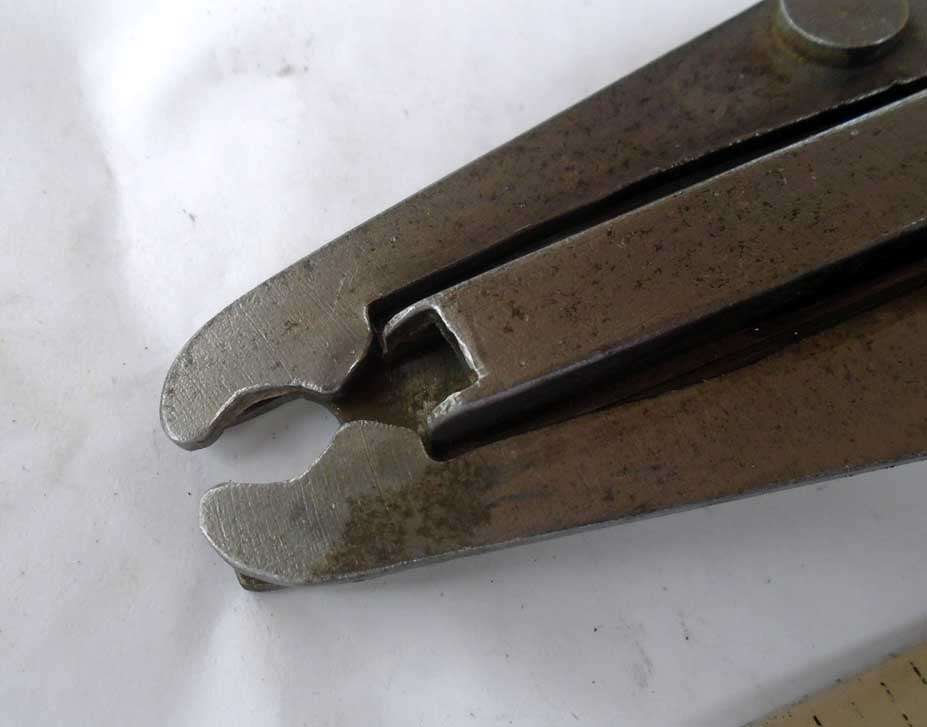

      Here s this weeks oddity!
      Came from a house clearance guy who brings me stuff, he has no idea what it is for and I don’t either!
      Some kind of circlip removal/ insertion tool perhaps?
      No makers marks.
      The central ram pushes forward and spreads the jaws a small amount.
      All idea welcome.
      Cheers, Martin

      #809662
      Alan Donovan
        @alandonovan54394
        Hi.
        A total guess, maybe for installing and removing E clips, but only of a specific, pre-determined size.
        Alan.
        #809685
        Martin Kyte
          @martinkyte99762
          At first glance I thought a tool for holding small screws before driving in with a screwdriver but then maybe a tool for placing cobblers nails prior to being hammered in.

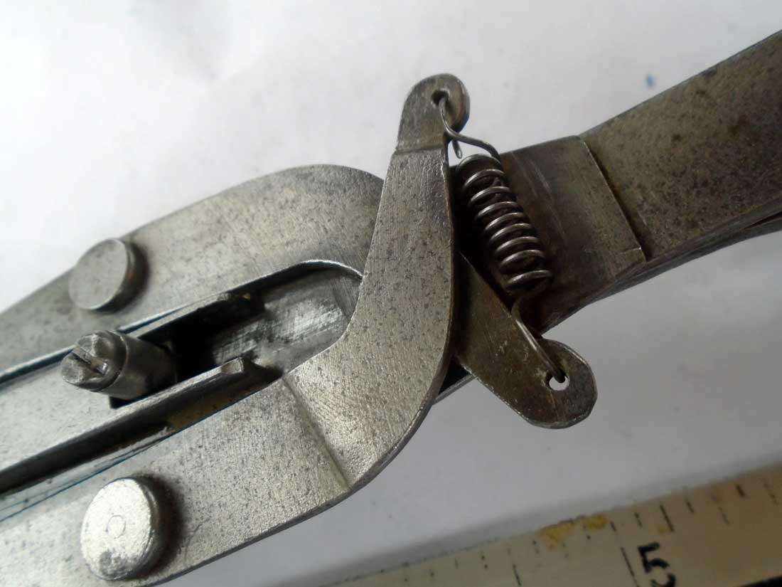

          #809686
          Speedy Builder5
            @speedybuilder5
            How does the ‘bolt’ work, by pushing the handle or is it a two handed device, one on handle and the other on the bolt?
            #809688
            peter1972
              @peter1972
              It’s a device for assembling cone valve cotters.
              See description here:
              https://www.ebay.co.uk/itm/196523989348
              #809690
              Robert Atkinson 2
                @robertatkinson2
                +1for C clip / E clip insertion tool.
                Sprung jaws would accept a range of sizes.
                #809692
                peak4
                  @peak4
                  It appears to be a “Gerald Staines” NUBO Valve Collet tool; at least two different sizes
                  This seems to be the relevant patent
                  https://worldwide.espacenet.com/patent/search/family/010027055/publication/GB437748A
                  There’s at least a couple on eBay at the moment; this is one
                  https://www.ebay.co.uk/itm/285885919656
                  Bill
                  #809694
                  Robert Atkinson 2
                    @robertatkinson2
                    Crossed posts with Peter. Patent number on ebay one confims it’s for valve cotters.

                        #809979
                        Speedy Builder5
                          @speedybuilder5
                          So what does the sliding bolt do?  This a simpler tool:-
                          ScrivenersCotterTool-2_zps2a6fecce
