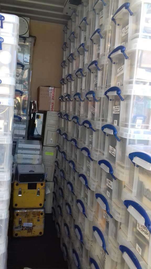

                Really Useful Boxes
                https://www.reallyusefulproducts.co.uk/uk/html/onlineshop/fullrange_rub.php
                I have over a hundred of them. They are strong, sides don’t buckle when stacked. Some of mine are over 15 years old with no sign of deterioration. I have mostly the 18 litre size plus 3, 4, 9 and some others. Check dimensions some different volumes will stack together.
                Most are filled with dense / heavy items so I avoid the bigger sizes as they become unmanageable with heavy items.
                I have them stacked up to 6 ft high, the sides are designed to take verical loads. This does stop them being nested when empty. Insides are clean and smooth.
                Fairly expensive but think of the value or the contents. Shipping can be a pain due to volume but Rymans stock them if you have one locally. There are look-alikes but those I’ve seen are not of the same quality.

                  Clearly a man who knows how to organise – contents all photographed, itemised and cross referenced in a tracking database as well I suspect.
                  For a big lathe chuck in one of those I’d make a plywood base to spread the load and avoid splitting the plastic and glue or screw on some blocks to stop it shifting and becoming unbalanced when moved.

                              Yes the bins are all numbered and contents photographed. I’ve a good memory of what I have. I keep lighter stuff at the to pof the stack.
                              For heavy single items like a big chuck I’d put a load spreader (ply, HDPE chopping board etc) in the bottom and a PE foam buffer with a hole in the middle to stop it sliding around.
                              Lifting a 18l RLB is not a problem. I did struggle a bit last week with a new (to me) bit of electronic test equipment. It’s 20″ wide, 17″ deep 11″ high and weighs 40kg. Unusually no handles either. Had to lug it up stairs and put it in place a bit above waist height. That is well above what is recomended. (a Agilent 8720C 20GHz VNA if you must know)
