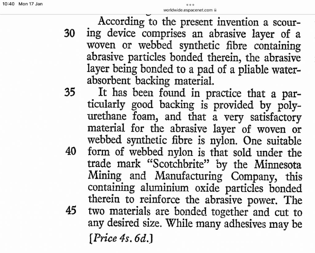

                      Posted by John Haine on 17/01/2022 07:03:46:
                      Scotchbrite
                      dont know
                      Please, please; please look at my post timestamped 20/10/2021 22:44:03 on this recent thread:
                      **LINK**
                      https://www.model-engineer.co.uk/forums/postings.asp?th=175141&p=1
                      … and, most particularly, follow the link to the SEM image.

                        Well I wasn't aware that some grades of Scotchbrite have abrasive powder included, but I am pretty certain that the grade they put on the back of "non-stick safe foam pad washups" does not. It will give you a way to gently remove the rust whilst hardly touching the steel surface. Another possibility is to use a glass fibre brush though it may be a little more aggressive.

                              Posted by John Haine on 17/01/2022 09:34:34:
                              Well I wasn't aware that some grades of Scotchbrite have abrasive powder included, but I am pretty certain that the grade they put on the back of "non-stick safe foam pad washups" …
                              yes That was the whole point of my post John
                              Similar to the situation with “loctite” … merely referencing a trade name is not enough !
                              P.S. __ This patent from the 60’s demonstrates a previous interpretation of ‘Scotcbrite’
                              https://worldwide.espacenet.com/patent/search?q=pn%3DGB986601A
