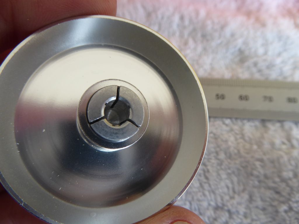

      ​I am just completing a 2m motorised glider and the out-runner motor has a 3mm shaft. The only spinner I could get hold of that matches the profile of the nose has a 5mm aluminium taper collet so I have to make an adaptor. The model shop where I bought the items suggested a piece of brass tube that would make up the gap with a longitudinal slit so it would be clamped to the shaft by the action of the collet. The standard sized brass tube that was suggested however was sloppy on the motor shaft and instinctively I don't like this idea. This is happening in Spain but I do speak Spanish and understood the advice.
      ​I have a suitable piece of Dural that I could make a sleeve from and a 3mm reamer so the adaptor could be a close fit over the shaft. My inclination is to Loctite the sleeve to the shaft so it is a permanent feature converting the shaft to 5mm and then using the collet on the spinner as intended. If I go this route what Loctite should I use.
      ​The alternative would be to make the adaptor sleeve exactly as before but put a longitudinal slit so it would clamp on the shaft more in line with the model shop advice.
      ​It is not a big powerful motor being only 280W driving a 7" folding propeller but nonetheless it would be embarrassing if it came off and the rearward shift in cg would probably by fatal to the aircraft.

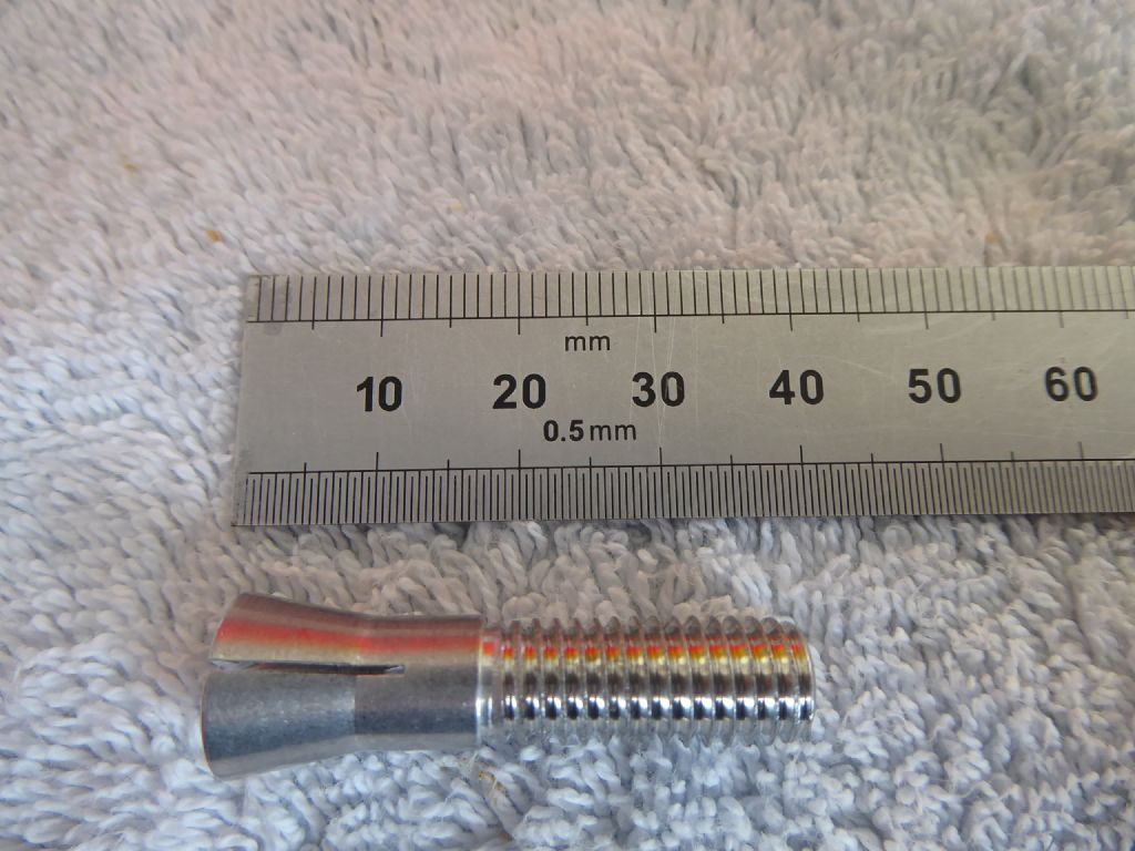

                If you can make a sleeve you should be able to make a new tapered collect with a 3.0mm bore which would be a lot better than having two parts

                  ​Here are photos of the collet.
                  This second photo shows the collet in the backplate of the spinner. I should have described the arrangement a bit better. Overall it is a bit more complicated than my ability to make a new one although I like the idea. Perhaps I will have a practice some time but the slits might defeat me.
                  ​For the moment I will avoid the Loctite and split a sleeve for all the good reasons given. I will check out what is available on eBay too.

                              Very helpful everyone but for the moment I have pushed the problem into the long grass.
                              Among my projects further down the list is a smaller motor glider with a smaller spinner. The collet was the same OD but drilled for the 3mm shaft. Overall it was a bit shorter needing a longer machine screw to retain the spinner cone but I have tried it and it works.
                              I am in a hurry to get this one finished but now I have time to set up to make a new one for the later model. Looks like it could become the perfect excuse to buy a few more tools.
