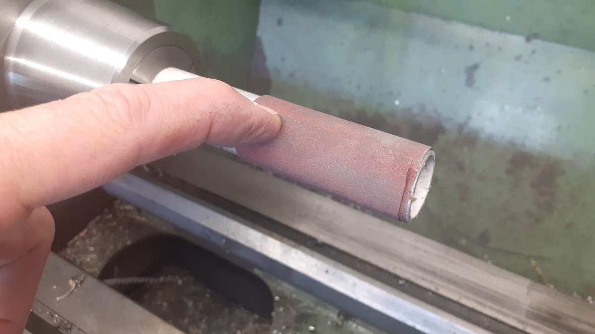

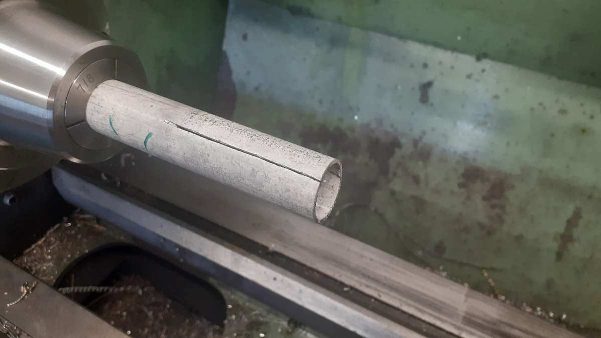

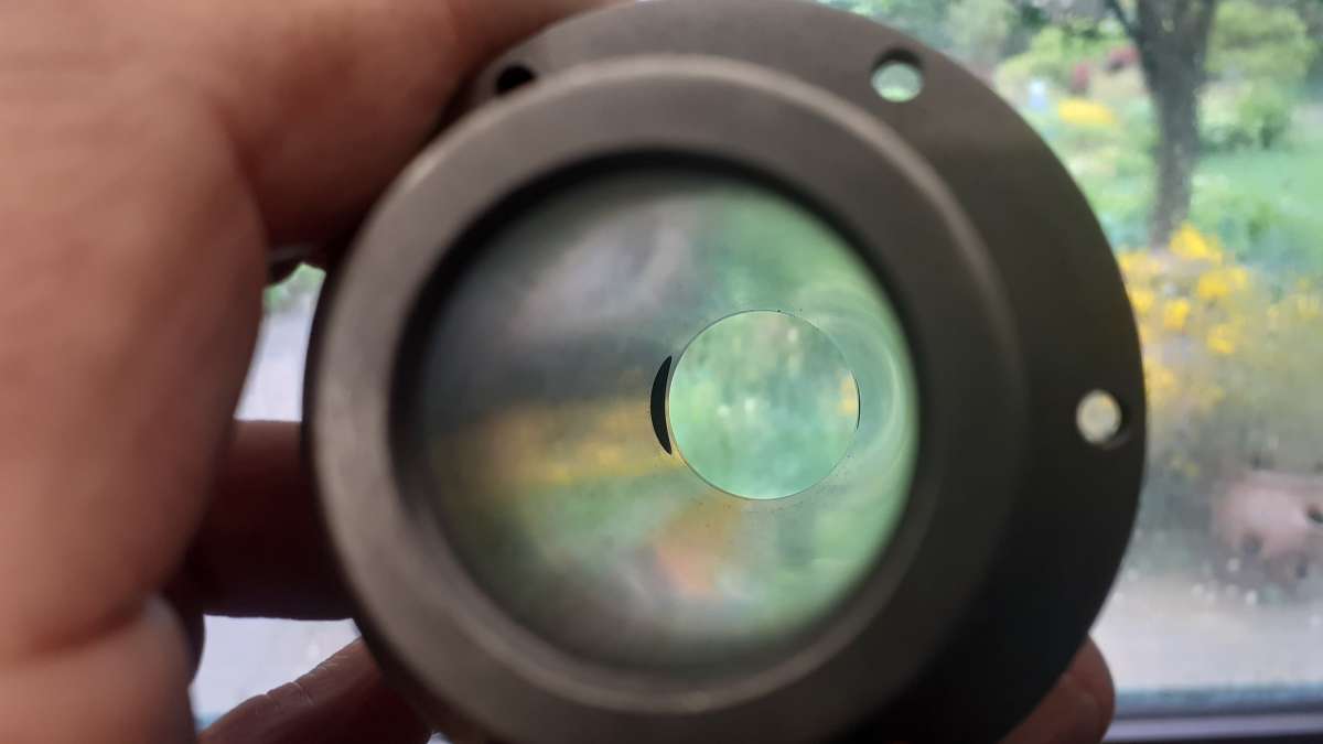

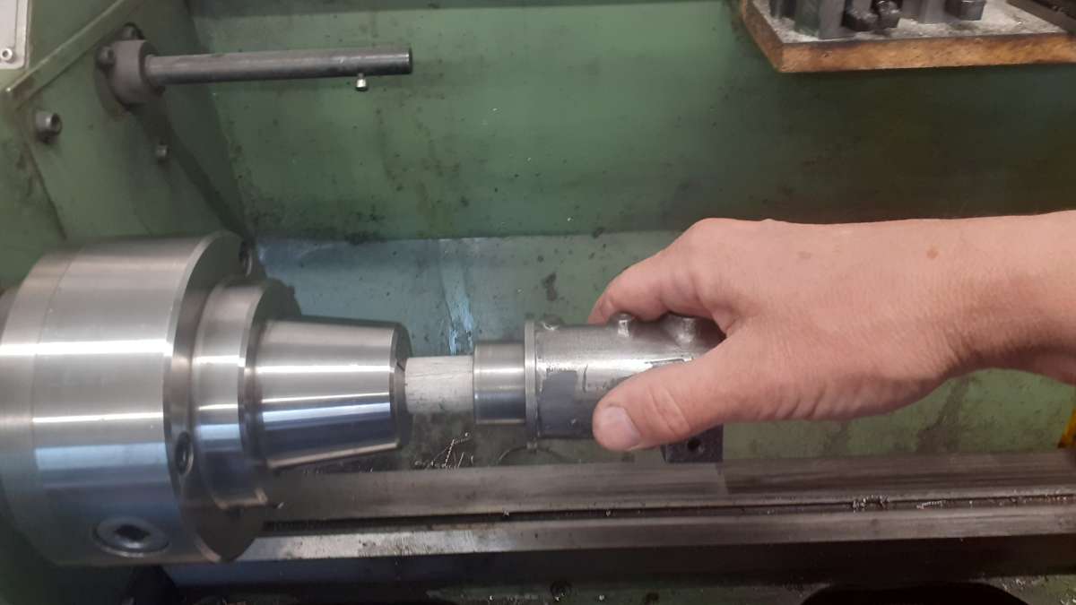

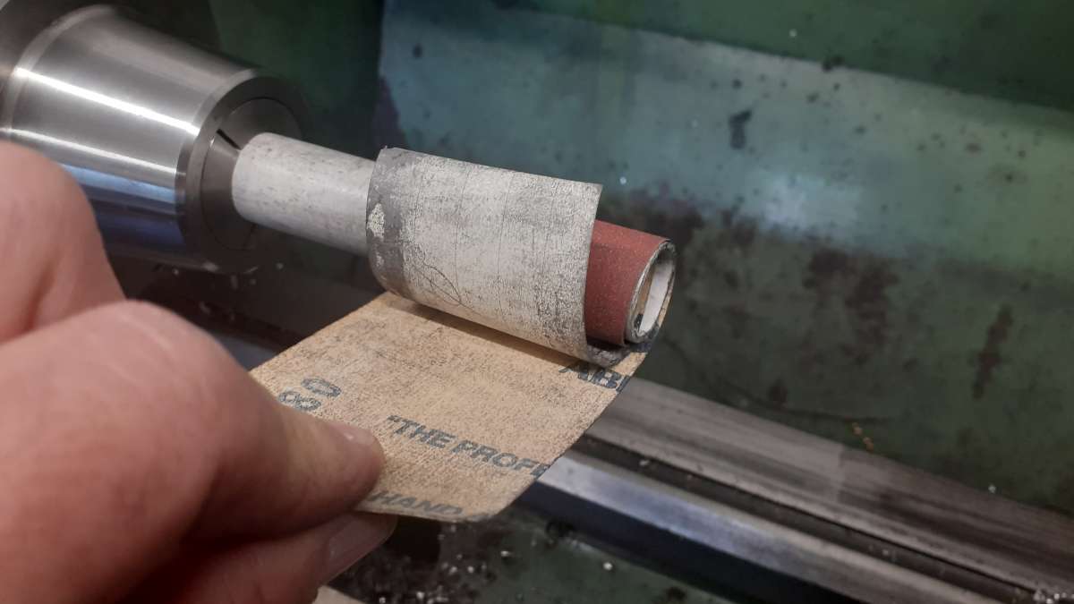

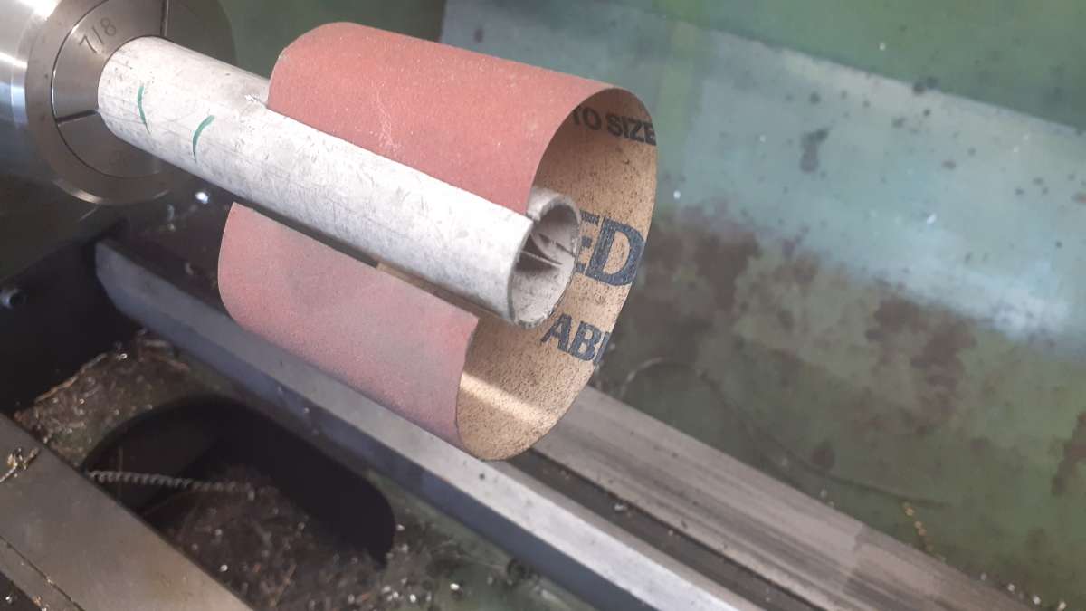

                                            Along the lines of the above, take some wooded dowel like a bit of broom stick or turn down some wood. I prefer a bit of tube and at the 1″ bore of your engine 22mm copper or plastic overflow will do. Cut a slot about 2″ long either right across the wood or just one side of the tube
                                            20240422_100224
                                            Take a strip of Emery cloth 2″ wide, slip the end into the slot
                                            20240422_100256
                                            then wind around the tube making sure it is tightly wound and in the direction shown. You will have to adjust length so the cylinder just slides over it.
                                            20240422_100326
                                            No lightly hold the cylinder and while th elathe runs slowly at first work the cylinder up and down the emery concentrating on the tight end.
                                            20240422_100516
                                            As the emery wears and the bore opens up you can increase the cutting diameter by adding strips of paper to the wrap.
                                            20240422_100400
                                            This is the sort of finish you can expect from 180g, not the best of photos.
                                            20240422_100605
