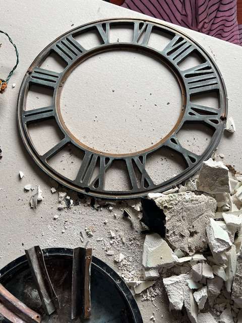

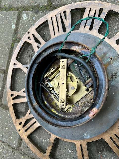

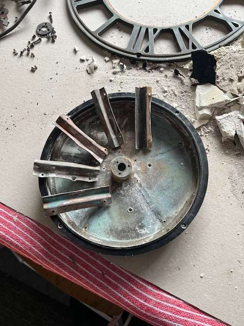

      For about 25 years this clock has hung in a cavity on the back wall of my house ..its a slave clock and i ran it with a synchronous motor driving a cam wheel with a couple of pips giving 2 pulses a minute to the mechanism.
      it was taken down to build an garden office for wifey.
      its made out of bronze? 10mm thick on the chapter ring
      its 400 mm dia
      but the inner bronze bit was filled with a cement type material that was painted black this had suffered in the elements…theres some brass bits that the cement was flowed round
      whats the reason for this infill?
      and where would this clock have lived when it was new?
      IMG_5703IMG_5704IMG_5698IMG_5700

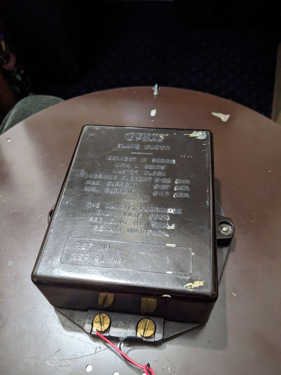

        PXL_20240503_152117982
        Oddly enough I had a movement on the floor beside my desk.  It’s a standard Gents of Leicester slave clock, originally driven by 30 second pulses from a master clock.  Thousands used in offices, factories, etc.  The Robertson clock which I look after has such a movement, like yours with a substantial cast face.  Rather similar to Synchronome slave clocks.  What part of it are you asking how it’s made?  An alternative to a synchronous motor would be an Arduino and a low cost real-time clock, which can be put together for not much more than a tenner.
        #729052
          Back when it was expensive to make accurate mechanical clocks, it was common for large organisations who needed to run to a standard time to buy a system consisting of a pricey precision master clock wired to a load of inexpensive slaves scattered round the premises.   Faults apart, all the clocks told the same time, and there could be hundreds of them.
          Ian’s slave clock looks good, so I suggest it was aimed at a prestigious institution like a College or Public Building rather than a factory or a chemical works!  The filler may be waterproofing, or perhaps simply intended to create the illusion of solid quality by adding weight.  Even though it has a lovely face, the innards are basic!

            its that middle part with the plaster/cement infill
            whats the purpose of it its a 220 mm dia x 20mm deep cavity
            why would it not be just a bronze disc ?
            and where would this clock have lived? On a wall with a large recess for the mechanism and the bronze “pan” ?

                As you know the electromagnet is pulsed every 30 seconds so it goes ‘clunk’. The infill of the disc is to stop it acting as a sounding board and making a huge ‘clanggggggggg’.
                This is a large outside movement, most are small 8″ dials for the inside. It is interesting in showing the counterbalance weight on the 120 tooth wheel for the bigger hand.
                It should be driven by a 300mA (400mA max) current, not a specific voltage, so that the long length of the wiring doesn’t weaken the pulse and use a few hundred ohm in parallel not a diode for back emf suppression to be authentic.

                  that makes sense for the infill material but if it was outside would the noise matter so much?
                  any ideas on what i should/could  use to replace it?

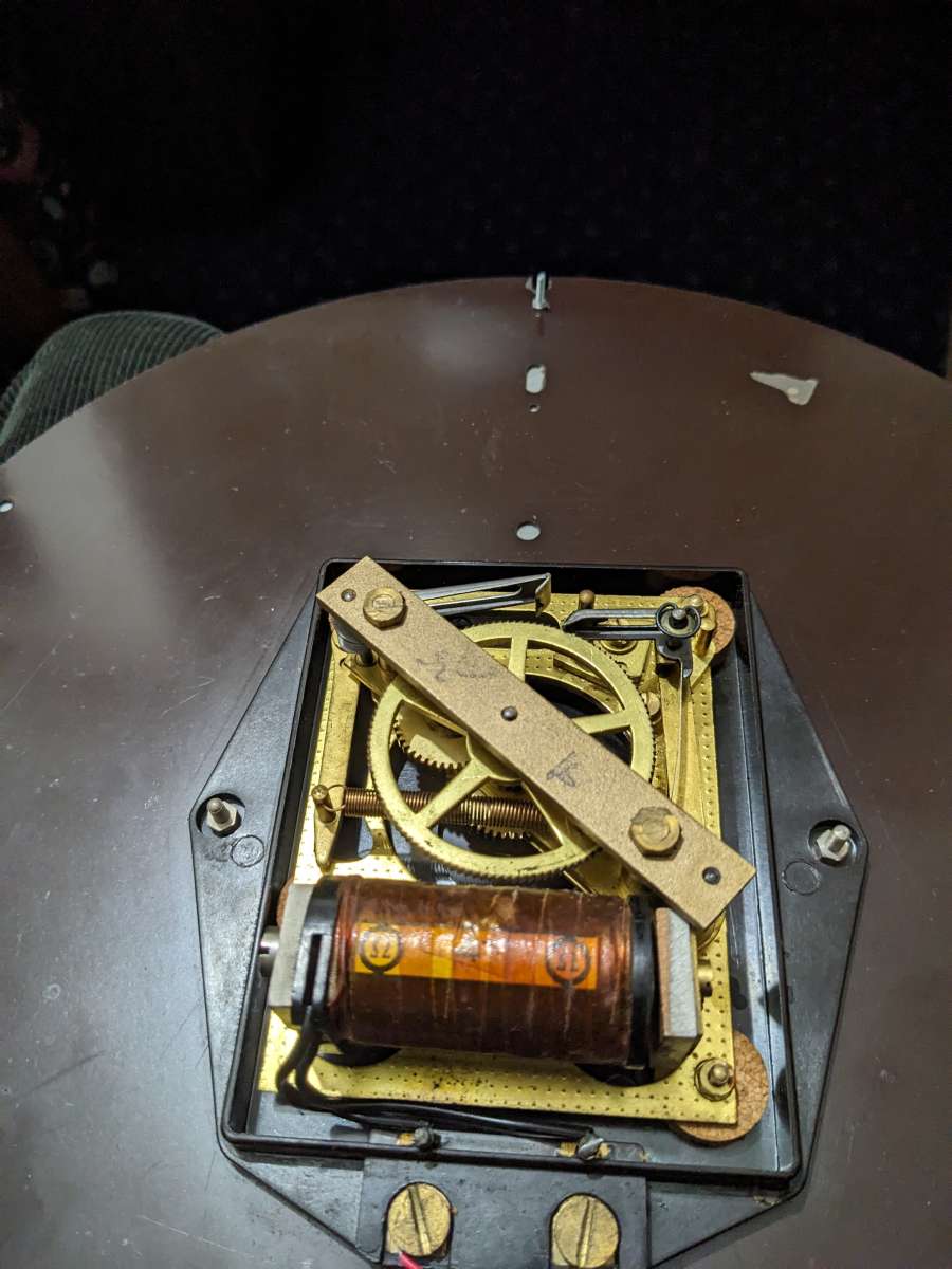

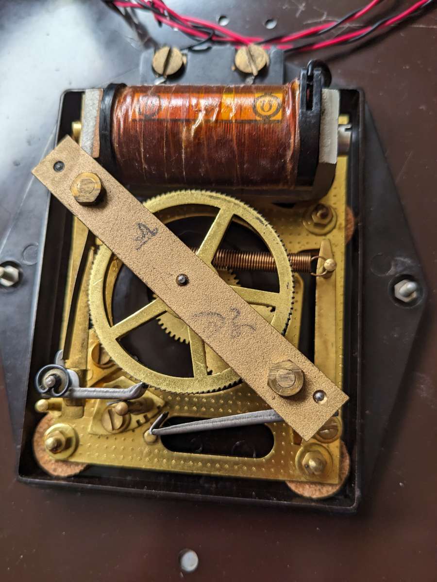

                                                  PXL_20240504_214103906PXL_20240504_214110827PXL_20240504_214055411
                                                  #729241
                                                  John Haine
                                                    @johnhaine32865
                                                    Three more photos of the movement above.  The internals have no branding, the Gents name appears moulded onto the back of the Bakelite cover that encloses the movement and also on the face (not shown).
