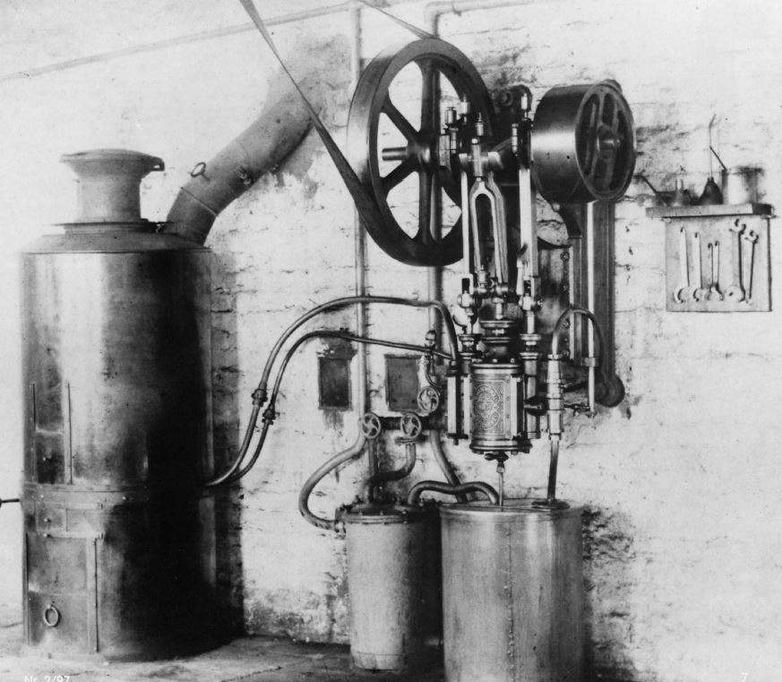

                        This is the engine it is said to be based on the 1882 Otto Lilenthal
                        elaine
                        And the patent
