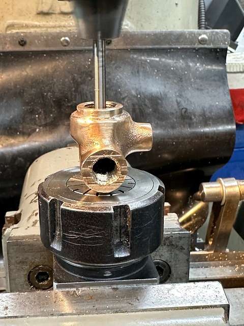

      I test fitted the fuel needle valve and it all felt good.
      The vice was now rotated over to put the Air Intake Boss uppermost.  This was faced off 0.656″ from the of the casting, hole centre location checked, 0.8227″, from end face of the casting and then drilled 8.5mm and tapped 1/8″ x 27 NPT.  I had already made the inlet pipe so checked fit of the thread.
      RedwingMixerIntakeBossRes
      The collet block now turned through 90 degrees to put the Fuel Inlet Boss uppermost.  Boss faced off 0.750″ from centre line.  Centred on the boss using 7/16″ drill rod, this should be 0.5″ from end face of casting.  Boss now drilled 6.3mm diameter for 0.310″ depth.  This depth is critical so as not to break through into the holes in the cored area of the casting.  Hole then tapped 1/16″ x 27 NPT and fit of fuel connector checked.
      Casting now switched to smaller collet and held by the chucking spigot and the register at the top centered using co-axial dial indicator.  Casting now drilled 3.1mm down through the centre and well into the chucking spigot.  This hole then reamed to 1/8″
      RedwingMixerReamValveGuideRes

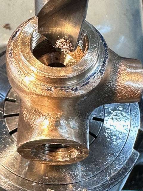

      I now needed to cut the valve seat.  This needed to have 45 degree face and be 0.447″ diameter.  I went through all my countersinks and they were either too small or too bog to fit through the 1/2″ threaded top bore.  I hunted through all my end mills and champher cutters but nothing suitable.  Finally I found a brand new 10mm carbide spot drill.  The cutting end was reduced compared to the shank, but the shank would just go down the bore.
      Because the seat was deep down a hole I could not easily (even at all) see progress.  In the end I wound the knee up until I could hear a cut being taken and then zeroised the knee DRO.  Would knee down and checked cut, would it back up, took 10 thou cut, zeroised the DRO and wound the knee down again.  Each time I checked to see where the fuel jet hole was.
      RedwingMixerCutValveSeatRes
      I continued like that until I had the fuel hole in the center of the seat and the seat to the maximum diameter of the cutter I was using.  The hole can be seen in the picture above.  In fact I went a bit too deep, about 6 thou, so used an end mill to remove the slight lip.  A bit Heath Robinson but it worked.

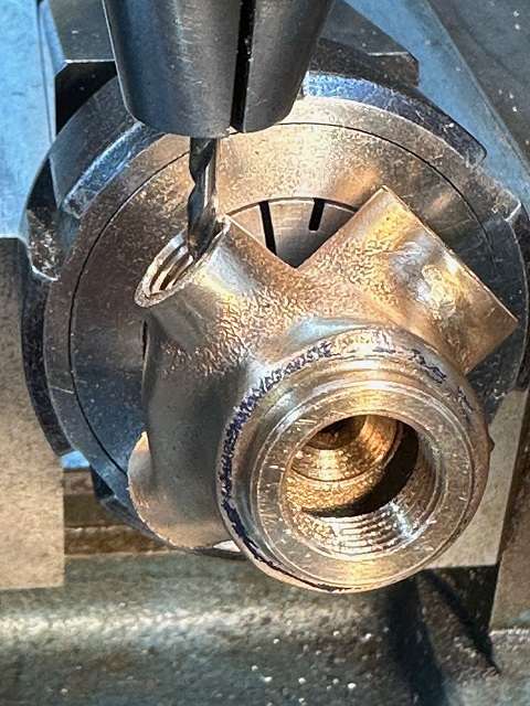

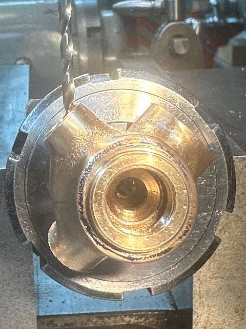

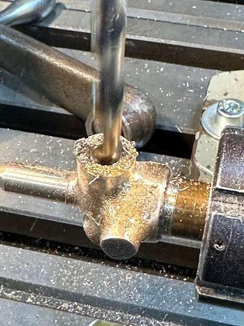

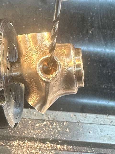

      The next fun bit was the hole to link the fuel inlet boss and the needle valve boss.  This needs to be 3/32″ diameter and must NOT break into the central area of the casting..  This required some careful lining up.  The other issue is drilling into the side of a thread the drill will wander.  The pictures show the story easier than describing it.  I did use a tiny end mill to give me a flat spot to drill, followed by a long centre drill to put a pilot hole.
      RedwingMixerDrillFuelFeed2ResRedwingMixerDrillFuelFeedRes
      RedwingMixerDrillFuelFeed3Res
      RedwingMixerDrillFuelFeed4Res
      In theory I was meant to drill a return hole from the needle valve boss so the two joined up.  I did not need to do this as I broke through into the base of the tapped hole.  I reset the casting in the collet chuck and cleaned up the broken through area using a small end mill.

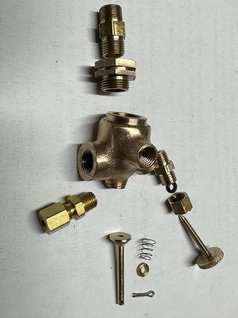

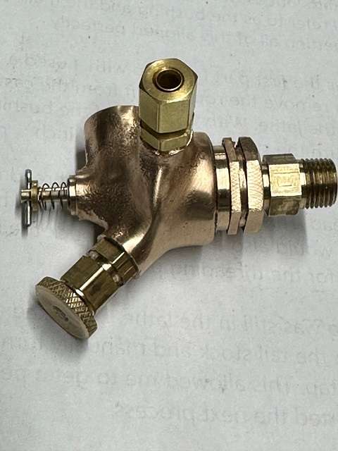

      I cleaned up both threads using the appropriate taps and then fitted the needle valve and the fuel inlet union and checked that I could blow from one to another with the components fitted.  All was okay.
      The casting was then remounted on the mandrel, moved to the lathe and the chucking spigot removed.  The various bosses then cleaned up with file and a trial assembly done.
      RedwingMixerParts2Res
      RedwingMixerValveSeatJetHoleRes
      RedwingMixerAssembled1Res
      RedwingMixerAssembled2Res

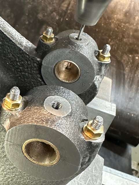

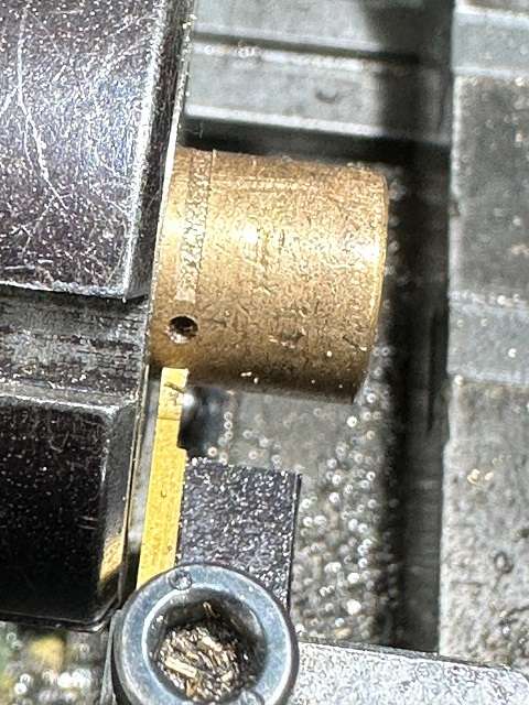

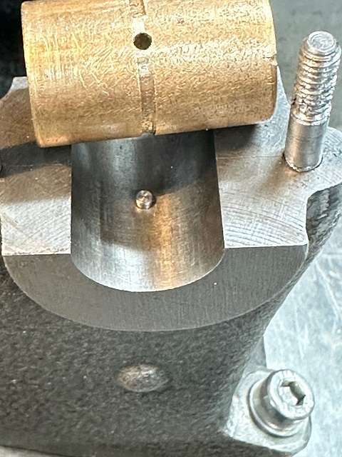

                  Decided I really ought to pin the main bearing bushes, so set the main casting back on jig plate at 25 degree angle.  Put 1/2″ Drill blank through bearings and used this to centre up on bearing and then centered up between the main bearing bosses.  I had some 5/64″ silver steel and planned to use this for the pins.
                  Removed the drill blank and moved to plus 1.219″ and drilled through the drilled oil feed hole through top of bush and then through bottom of bush  and then 0.125″ into the casting.  Repeated this at minus 1.219″.
                  RedwingMainBrngsPin1Res
                  Whilst the bushes were still fitted moved to a 3mm dia drill and just drilled through the top hole in each bush to aid with oil feed.
                  Removed the bushes and moved then over to the Myford into a collet chuck.  I wanted to turn a groove to allow oil to spread around the bush.  Used a 0.064″ parting tool.  I was about to switch lathe on when remembered I did not want to remove any material adjacent to the lower pin location hole. Fitted lathe mandrel handle and turned spindle by hand but started cut about 0.625″ (1/16″) away from pin hole and stopped in similar position having gone almost full circle.  Three passes was enough to get a small groove.  Repeated for second bush.
                  RedwingMainBrngsPin2Res
                  My ER collets did not go small enough for the pin but I had 5/16″ 5C collet.  Parted two pins off to calculated length of 0.185″.  These were a little too long and I was worried they might mark the crank so removed a further 15thou.
                  RedwingMainBrngsPin3Res
                  All fitted together satisfactorily.

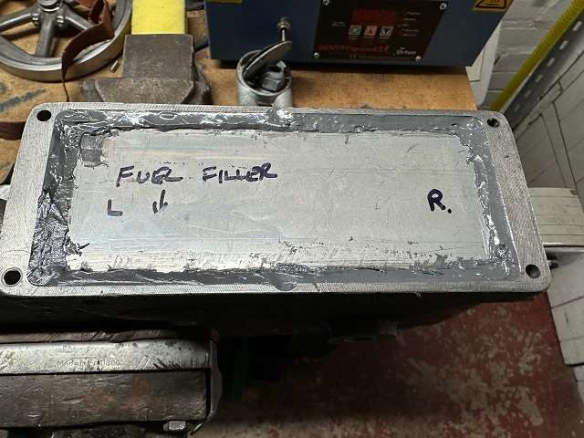

                  Now to JB Weld the fuel tank base into place.
                  #728689
                  Colin Heseltine
                    @colinheseltine48622

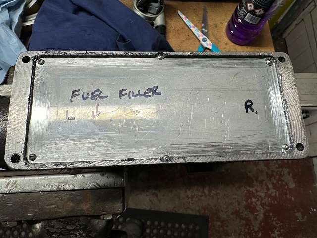

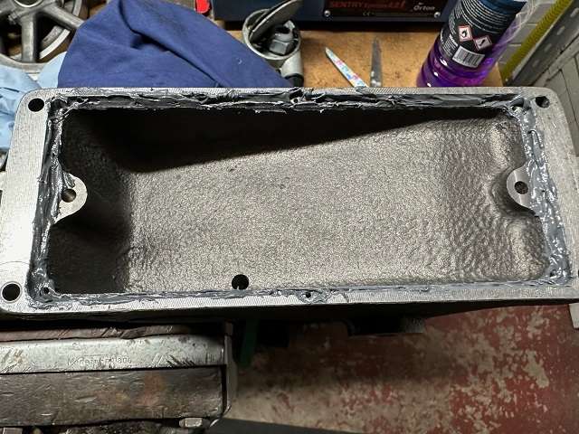

                    The main casting had already been drilled and tapped for 6 small screws to hold the stainless fuel tank base in place.  A thin bead of JB Weld was run round the recess in the main casting and then the stainless panel screwed into place.
                    RedwingFuelBase1Res
                    RedwingFuelBase2Res
                    The excess JB Weld had squeezed above the panel and this was supplemented by a further bead of JB Weld and the fillet smoothed down into place.
                    RedwingFuelBase3Res
                    Let’s hope it does not leak.  Time will tell.

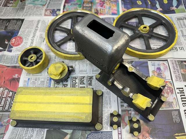

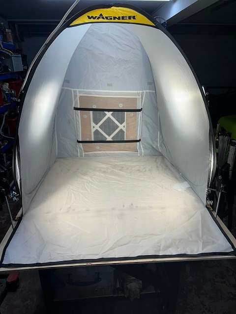

                    I was waiting for a small collapsible spray booth to be delivered and so used the time to make the final few nuts, bolts and studs required to hold the main casting, base casting and the wooden skids together.  I also masked up the parts ready for painting.
                    RedwingMaskedUpPartsRes
                    The collapsible spray booth arrived and then had the task of making an extraction system and some lighting for it.  Some thin ply, a cheap bathroom extraction fan, some spare aluminium strip and sheet and a filter made up a working extraction system.  It would suck a sheet of paper towards the filter, but it was only once I started to spray I could see how effective it actually was.  I had 4 10W LED lamps brought cheaply from a local business that was closing down and these provided directional lighting.
                    RedwingSprayboothRes

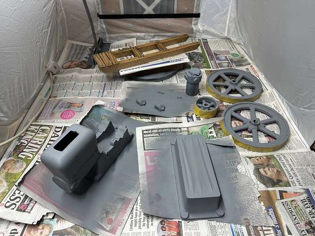

                    Three coats of grey primer were applied to all components.
                    RedwingPrimeredPartsRes

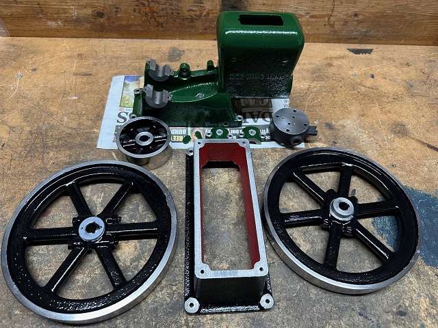

                    This was followed by 3 coats of top colour.  Base casting, Flywheels, and Pulley were painted Gloss Black, Head with heat resistant matt black, and main casting with Rover Brooklands Green.
                    RedwingPaintedPartsRes
                    I had given the flywheels and pulley a good polish prior to masking up.  I will give the paint 48 hours to fully harden and then clean up any overspray off the bare metal areas.
                    Then hope it all goes back together alright and the fuel tank holds fuel.

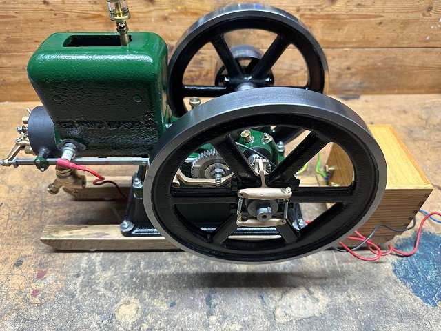

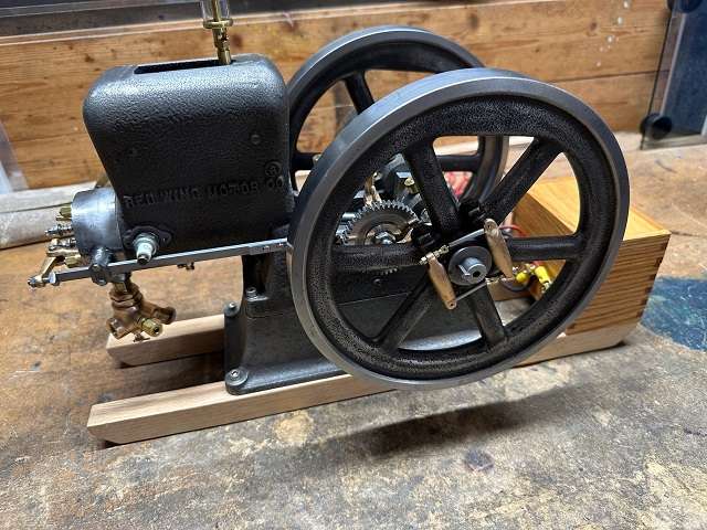

                      The fuel tank hold fuel without leaking.  This was a bit of a worry but the JB Weld has done a good job.
                      Trying to get it to run is not going too well so far. Got the occasional chuff. Pretty certain cam timing and ignition timing ok. Fuel appears to be a bit of an issue. Initially I did not think I was getting any fuel through, so took the carb off and tried to suck to see if the valve would open. It did not appear to be lifting at all so I removed one coil off the spring. I could now suck and get the valve to open, if I blew instead there did not appear to be any air leakage down past the valve. Reassembled and tried again and am now getting leakage around the valve stem. When the inlet valve opens when piston on downstroke the carburettor valve can be seen to lift slightly and a suck can be heard through the carb inlet, although not particularly heavy suck. I guess if the engine actually ran then there would be no leakage as the fuel would be pulled into the engine. I also noticed that the fuel level in the tank was going down and realised that possibly too much fuel was now getting into engine now as it was leaking past the piston. Pulled the plug and it was wet.
                      What valve timing and ignition timing have others used. Also how far have you got the needle valve cracked open.
                      I know I am getting a spark from the buzz coil as I gave myself a huge belt by accident.

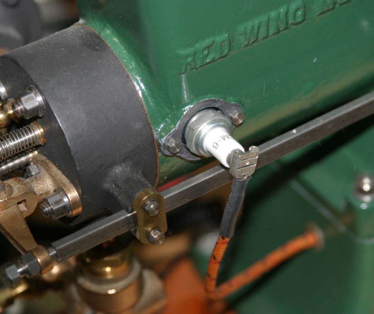

                      The plug I am using is a CM-6. It sparks when out of cylinder alright. Are there any similar plugs with a smaller hex nut on them I can only remove the plug by lowering the tail end of the exhaust push rod.
                      Colin

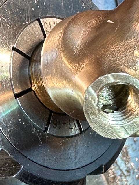

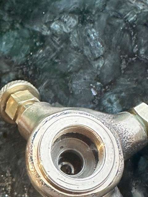

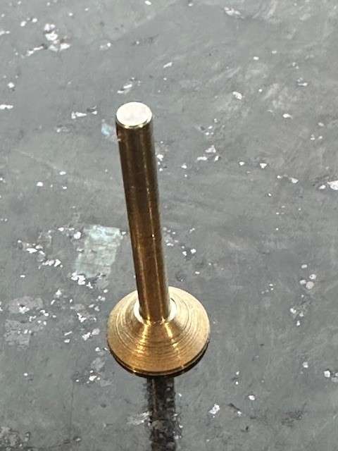

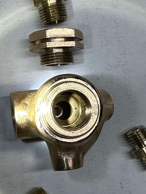

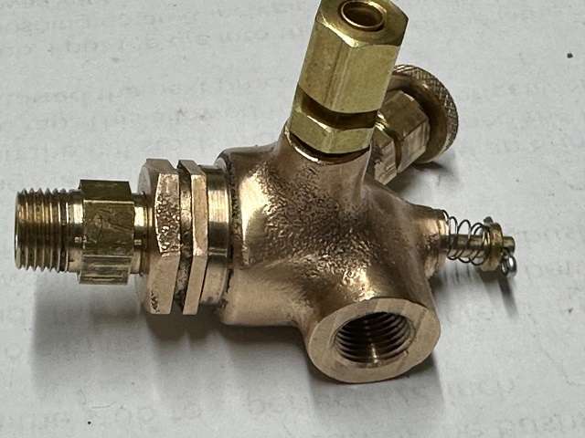

                          Still having problems getting engine to run. Not been ble to spend much time in last 20 months, Prostatectomey in June 24 followed by Sepsis and then ongoing bloods issues and now waiting for knee replacement.
                          The engine had been flooding and petrol was seeping (no almost flowing) from the bottom of mixer around the stem of the valve.
                          Decided to re-cut the seat and make a new valve.  This turned into a long exercise.  A friend had given me a lovely new piloted 90 degree seat cutter but is was too large a diameter to pass down through top of mixer.  Needed thinning down.  I had a toolpost grinder in cupboard but never used it.  I had to make belt guard, wheel guard, get belt made, source grinding wheel and get all set to height.  Then had to fit and wire/plumb a suds pump onto the lathe.  Eventually all ducks in row and was able to mount it on Myford and grind the valve seat cutter to just a few thou under the mixer mounting thread diameter. Once this was done I needed sutiable pilot and found a 3.2mm dia drill blank was perfect.  The seat cut nice and easily with just a dozen or so spins of the  cutter by hand.
                          The valve is all brass and having used a larger diameter seat cutter I was able to make a bigger diameter valve, in fact it now came to the dimensions on the plans.  I decided could not trust the graduations on the topslide of the Myford to get a prefect angle and so after some googling I use the Joe Pie methd of setting the topslide angle.  This worked very well and some engineers blue on valve transferred nicely to the seat.  A few spins with some very fine valve paste looked to give a good seal.
                          Refitted it all back on engine, fuelled up and tried to start it.  The good news is the valve seat no longer leaks.  I managed a couple of 20 second runs, but only if I held the valve off the seat with my finger.  Thought possibly spring might be too strong, but struggling to find anything weaker.  The only good news was that the hit and miss mechanism appeared to be cutting in and out correctly.
                          At end of the day I could only get the odd puff.  Im sure the timing is okay as just after I finished it in May 24 I had managed to get it running for 3 or 4 minutes.
                          Any ideas greatly accepted.
                          Colin

                          #834159
                            They do need a really weak spring, some people even leave the spring off and just let gravity return the valve to th eclosed position.
                            Needle really only wants to be cracked open too.
                            All the Lunkenheimer carbs I have made I use a small boring bar to cut the seat and do the valve at the same cross slide setting
                            #834190
                            Colin Heseltine
                              Jason,
                              I have tried with the spring off as well as on.  Just after my post it ran for around 2 minutes.  About 1hr later it ran for around 20 seconds and the H&M worked ok.  Now cannot get it to go again. It floods up very easily and once the plug is wet then have a problem.  Unfortunately cannot get plug out without moving the exhaust push rod.  Very tempted to trim the hex on the plug so can get it out easily until engine running reasonabley successfully if ever.  What do you do for the HT connection to the plug, are they scale plug caps or is it best to turn the end down and put a thread on it.
                              Colin

                                I have used a mix of the flat brass clips though you have to make sure there is nothing close for the spark to jump to as they are not insulated as well as small size rubber boots. I used to get both from S/S but they have changed hands so not quite sure what stock is available. Assuming it is CM-6 size.
                                #834198
                                Colin Heseltine
                                  Yes it is a CM-6.  Just had a quick thought which I need to go and check. Wondering whether it is possible for the needle jet to project a little too far into the hole in the valve seat and hold the valve slightly open.  If so it might pay to grind the tip back a fraction.
                                  #834204
                                  John Purdy
                                    @johnpurdy78347
                                    Colin what i have used on mine is a 1/4″ electrical quick disconnect connector opened up a little to grip the contact on the CM-6 plug. Interesting that you can’t get the plug out without moving the exhaust push rod, it comes out no problem on mine. I have yet tried to run mine.
                                    Plug
                                    #834208
                                    Colin Heseltine
                                      John,
                                      Yes thats what I have on mine but with the standard insulation sleeve.  Its attached at present but does appear to vibrate looese.
