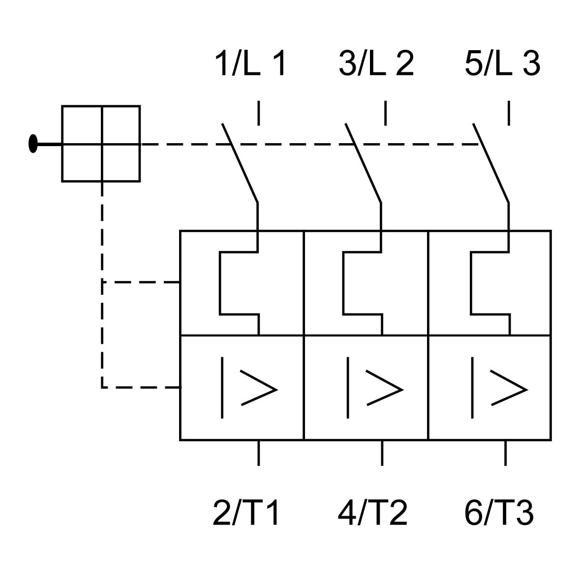

                                              David Brown 9
                                                @davidbrown9
                                                Hi, I have to laugh at myself sometimes!
                                                I bought a single phase 1/2 hp 4 pole Clarke electric motor from Machine Mart as I thought that this would be much simpler than a 3 phase motor. I noticed that their website advised buying a '2-4 amp starter' as well. That's fine, I thought, I'll just plug that in to the mains, plug the motor in to the amp and away I go. Of course it turns out that the starter amp is a 'motor protective cicuit'-MKS1TM-K-40, which you have to wire (presumably to the mains) and I presume I will have to connect the motor to it somehow.
                                                I have understood that this gives protection to the motor and stops it coming on again unexpectedly after a power failuire? So it is probably a good idea. The manual for the protective circuit says it should be fitted by a qualified electrician. As this would come to a lot more than the cost of the motor there is no chance of me doeing this!
                                                How difficult/ potentially dangerous is it to do it myself? I have a multi meter and am pretty sure I can figure it out.
                                                The instructions say 'first press stop' then connect 'YKD' There is also a 'thermic set up table' I at least know that I need to turn of the electricity at the mains first!
                                                I guess from reading on this forum lots of lathes etc need something similar so I am guessing a lot of people who are not qualified electricians have fitted these.
                                                Plan B is to use my pillar drill motor, which goes down to 210 rpm and I can just plug it to the wall. But I would quite like to keep using it as a pillar drill!
                                                By the way, I am hoping that the Seig SX2 Plus i have ordered does just plug in to the wall!?
                                                David
                                                #185717
                                                Lambton
                                                  @lambton
                                                  David,
                                                  I have looked at the diagram for this starter on the Rutar website. See below.
                                                  This is a three phase starter but it can be easily used with single phase as follows.
                                                  Referring to the first numbers only ignoring the L and T numbers.
                                                  Connect the incoming live to terminal 1 and the neutral to terminal 5.
                                                  Put a link wire between terminal 3 and terminal 2.
                                                  Connect the motor to terminals 4 and 6.
                                                  #185718

                                                    Hopefully the starter operating coil is a 240 volt one. It is a good idea to have a proper motor starter which gives overload and No-volt protection.Ted
