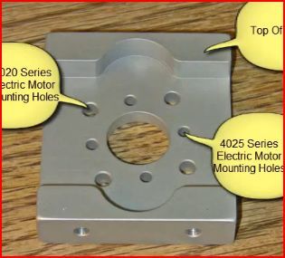

                        I have cut carbon sheet on the mill, but all by eye, drawing on masking tape stuck to the carbon. This is a lot more ambitious. I have actually paid for the part already, and I’ve been told two have been posted to me, but I haven’t received either. The person who made the simulation, and posted it to youtube, has not answered any of my emails, the person he made them for is the one I have paid.
                        The part is approximately 60mm x 60mm
                        Edited By pgrbff on 12/08/2011 20:19:40
                        #73265
                          If you made the lightening cutout just a rectangular shape it would be a relatively simple part to make.
                          A bit of trigonometry to get the mounting hole positions as they seem to be angled will be needed or if he has a DRO then they are just two sets of four holes on a PCD starting with teh first hole at whatever angle it is looks like about 5-10deg, 50-55 deg for the second set of four.
                          The central hole can just be bored, does not need to be milled like the simulation.
                          Also I note you asked about 6mm plate, judjing by the M4 holes in the sides I would say its more like 12mm thick.

                            I only need two of the four holes, 30mm centres but position is relatively unimportant, they need to be spot on 30mm apart and 15mm from centre of plate. The plate is a motor mounting plate, the two holes fix it to the motor. The central hole will have to be approximatel 20mm.
                            It needs to be as light as possible so it is milling out the central portion that concerns me most.
                            My friend has a vice that rotates? Not sure what it is called. It’s all the imperial measuring that worries me! Give me metric any day.
                            All the horixontal and vertical movement on the mill are manual, can’t remember the make but it’s big, 2m+ high, and 1950s American.
                            The holes on the side secure the plate between the frames and shouldn’t be too difficult.

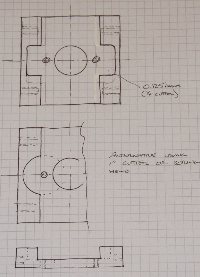

                                  As the mount looks like it can slide into mesh then it would not matter if the two motor mounting holes were a bit off to one side. Its just getting the 4 holes in the sides level so the motor is not tilted that matters, the lightening cuts can almost be done freehand, certainly 0.5mm either way won’t affect performance.
                                  Anyway here is how it could be done.
                                  Top sketch is using say a 1/4″ cutter to do the lightening pockets once the main material has been removed from the block with a larger cutter
                                  Second shows how it could be done with a 1″ cutter or boring head.
                                  And for those that have not looked at the video this is what hes after
                                  Edited By JasonB on 13/08/2011 08:26:12

                                      Yes, to keep all the holes in the same plane you first ensure the fixed vice jaw is parallel to the mill access with a dial indicator. Set say the bottom face of the work against the fixed vice jaw, then turn it 180deg to do the other holes keeping the same bottom face against the fixed jaw
                                      Although the Bridgeport has the ability to take the metal out with one cutter the full width if you are buying two cutters then 6mm and 12mm will come in useful but as its mostly RC work you are doing then 5mm and 10mm may be the better option.
                                      Assuming there is about 30mm width to come out the middle then 3 passes of your 10mm cutter at 2mm deep each pass should be fine, use a bit of utting fluid – parrafin or WD40 will be OK on alloy
                                      The thing you describe is a rotary table, could be used to do the two semi-circles. Set the RT axis true to the mill spindle, clamp the work to the table with one of the mounting holes aligned on teh axis. Then you can use your 10mm cutter to forn the semi-circle.
                                      Take a look at this thread by John (Bogstandard) the first couple of pages detail how to set up your machine, make your block of metal true and then how to machine it.
                                      For tapping I would suggest drilling the 3.3mm hole and then without moving the mill take take your tap with the tap wrench gripping it half way down and place that in the chuck but don’t fully tighten, just enough to hold the tap true, you can then cut the thread without risk of the tap going off at an angle (DO NOT USE POWER) This also helps prevent a snapped tap as the tap wrench will rotate before the tap jams and breaks
