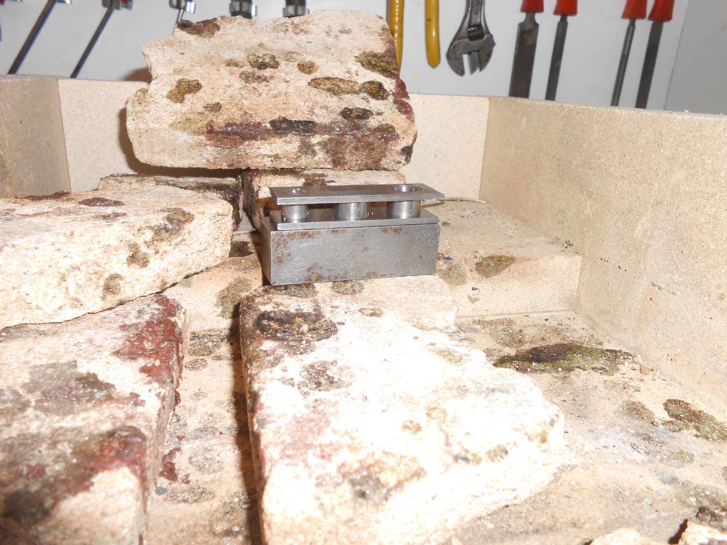

      When silver soldering what is the best method of ensuring that other parts in close proximity to the "joint" does not get soldered. I have made a jig to make some lifting arms. I do not want the arms getting soldered to the jig ?

                                            Peter Simpson 1
                                              @petersimpson1
                                              Bill this a photo of an embryo lifting arm mounted on the jig prior to silver soldering jig.jpg

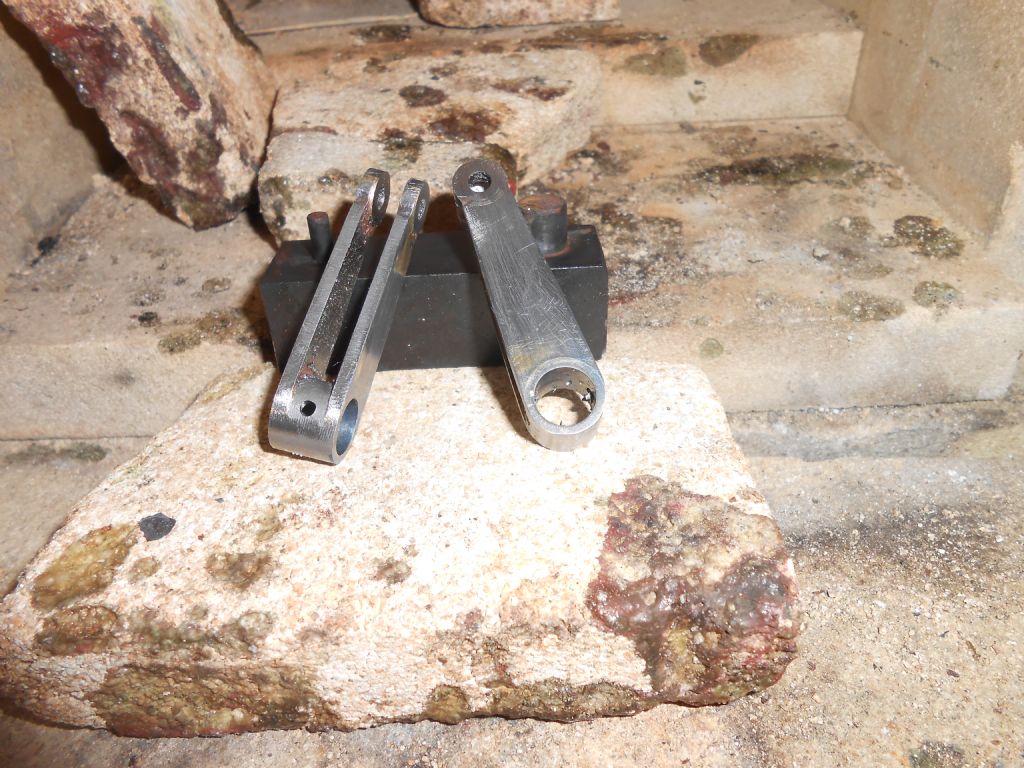

                                              Peter Simpson 1
                                                @petersimpson1
