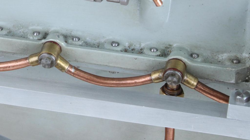

        I need to make some unions like the ones pictured below.
        They are for 1/8 copper pipe and I would like a neat join with
        minimal solder showing.
        I was thinking whether to use solder paste in a syringe rather than the
        rod which I am used too .

          If you cover the areas where you don't want the solder to flow with a resist such as Tippex then you can solder with rod or paste.

            Hi David,
            Make a solder ring to fit inside the fitting. Probably using 1.0mm wire
            Flux the joint.
            Heat the joint line, the alloy will melt and flow towards the heat.
            If using paste, put it inside the fitting and heat as above.
            If using paste, you will probably need twice the amount you think!
            A ring is the cheapest option.
            Regards
            Keith

              Correction fluid Tippex ? do you use this to stop the flux spreading around the joint.
              #457817
                Yes and Yes. Needs to be solvent based tippex.

                  Cup Alloys , had an interesting read on your site and could do with some silver solder.
                  Would the low temp 455 be ok for this job , thanks

                    455 would be fine. It produces small neat joints.
