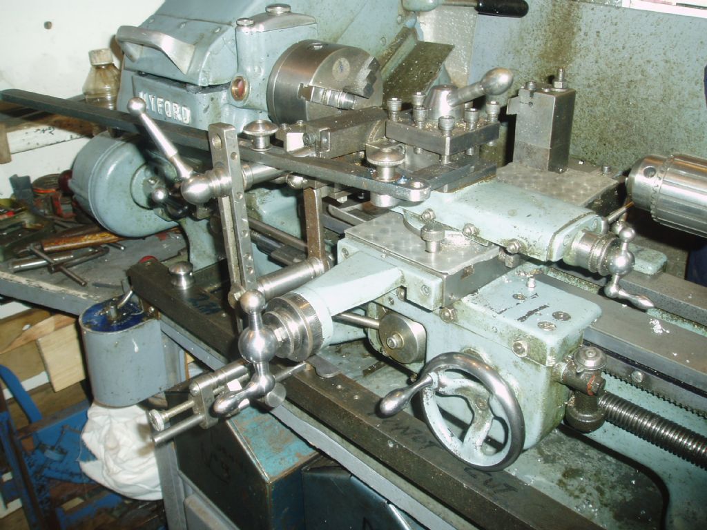

                    1. Buy a taper turning attachment and do it trial and error using the Harold Hall method or by using a marker pen to see which parts of the male and female taper are in contact.
                    2. If you must use your top slide, fabricate up a post you can fix to your saddle that incorporates a screw threaded rod that can act against your topslide. Or if you don’t feel happy about adjusting the threaded rod, slip a feeler gauge between the two to change the angle.
                    3. Clamp a very long piece of steel bar into your tool post and use that to swing the topslide assembly. That at least multiplies up the finesse of movement.
                    In practice, I doubt if you’ll get it right first go even with careful measuring. It’ll still come down to a bit of trial and error with a test cut. I’ve got a taper turning attachment and once I got the right angle established, I drilled and fitted a taper pin in an unimportant place so I could go straight to the same angle next time.

                      Incidentally, you’ll get a much better result by using a taper turning attachment and using power feed to draw the saddle along on a fine feed. Turning the topslide handle by hand often introduces just a shade of side to side movement which gives a less smooth surface finish. The slides need to be very well adjusted.

                          You can also, with a taper turning attachement, do it properly- the advantage being a very long measuing base leg. 10″ on the Hemmingway one. Also I’ve never moved a topslide by hand when trying to be accurate – I find a light soft faced hammer and a gentle bump to be hte most effective. Light taps and you can apply an offset very easily, and very accurately.
                          I suspect that if one does it trial and error off the scale it is quite easy to get it wrong, because without an accurate vernier life won’t be easy. But, over 10″ and working to say 1/3 of a thou, you tend to be pretty right first time, for most tapers.

                              I”ve made a 45 30_60 10, 15. 18 etc degree setting peices Also 1/2 , 1 , 2 , 3
                              As Chris says about a taper turning attatchment I will have a go at setting my copy attachtment up to turn a MT2 Regards Nobby
