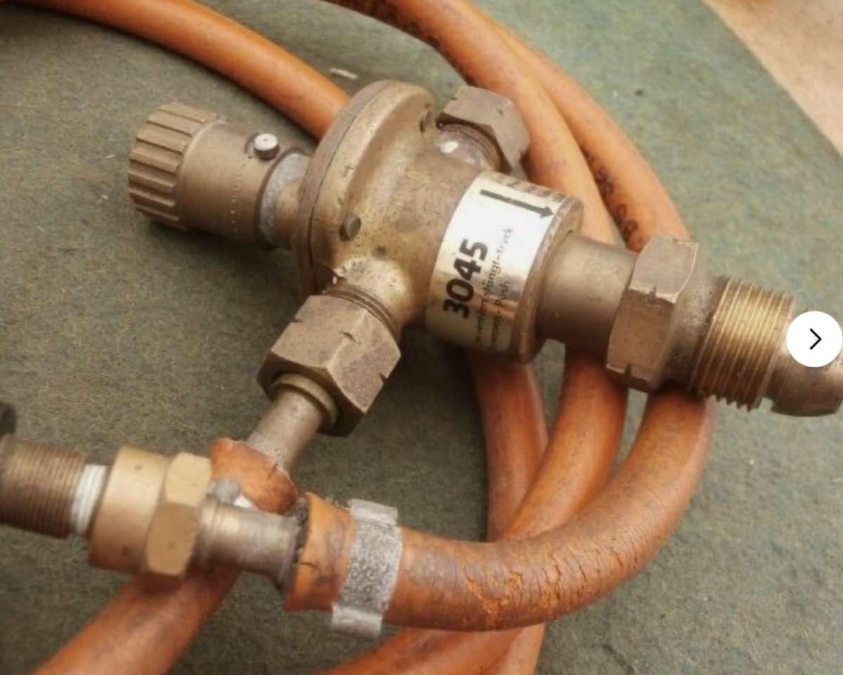

      I have a dual outlet sievert regulator the model number is 3045..so old it is no longer listed!!
      It has developed a leak between the connection tube that screws into the Propane bottle and the larger diameter body that has the  sticker on it ( hope that helps) although the pic is 3.4mb jpg it will not load
      I have rung the UK distributors and they cannot assist, but does anyone on here know of a firm that might look at it and repair it?

          I found a picture online in case it helps the discussion.
          IMG_0865
          #736769
          DC31k
            @dc31k
            The connection tube should just screw into the regulator body.
            Often there is a broached hexagon inside the part that directly touches the bottle that allows that tube to unscrew (that is the part that is changed when the regulator is sold in a different country with a different propane bottle interface).
            The challenge is that the screwed joint may be loctited. The fact that it is leaking might mean the loctite has failed with age, which also increases your chance of unscrewing it.
            At the least, it is worth trying to unscrew it, clean everything and reassemble with a thread sealant (e.g. Screwfix 4373J).
            If your propane hose looks anything like the one in the photo, a replacement hose would be a good idea.

                Regulators normally have their date of manufacture stamped on them. The recommended life-span is 5 years, this does seemsa bit short, but would be a requirement for, say, boat gas safety inspections AFAIK.
                The condition of the hoses in the picture above is appalling.
