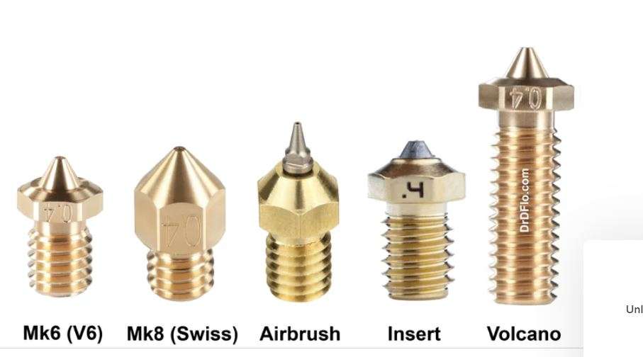

      I’m looking at modifying a 3d printer nozzle. My out of date printer nozzle has a filament inlet diameter 3.5mm, whereas replacement nozzles are usually about 2mm, the other dimension can be match okay. I feel that I can drill out the 2mm to 3.5mm, if I can secure the small 6mm replacement nozzle. I have E32 collets for the lathe but no way of holding the hexagonal nozzle. Looking for some suggestions on how to secure the nozzle. Thank you,

                        The reason the 3.5mm diameter is required, a metal tube feeds the filament through the heatsink, the hot end and into the nozzle. The nozzle slides over the end of tube as it threads into hot end. As the printer is no longer made, spares are very scarce and also expensive. Found a nozzle in France at €18 + €41 delivery. That price made me think there must be an other way, hence the post to you guys.
                        The type of nozzle is the same as Mk8 in Jason B’s image. I have ordered a bag of them to give me freedom to try out all the suggestions. Thanks again

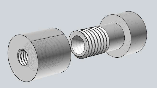

                          If you are going to be doing a few I would (as John suggests) use a lantern chuck. A simple single purpose one can be basic.
                          lantern chuck
                          Bit of suitable bar. Drill & thread through to suit the nozzle thread (6mm?). Drill part way through and thread larger to give clearance for the hex. If its 7mm as usual M10 should do.
                          Screw the nozzle in from the wide end, and with a bit of protection on the end of the nozzle, lock it in place with a screw of some sort. Grip in chuck/collet with threaded end of the nozzle out.
                          I would probably put a cone in the end of the locking screw so that only the outer edge of the nozzle was in contact with the holding screw.
